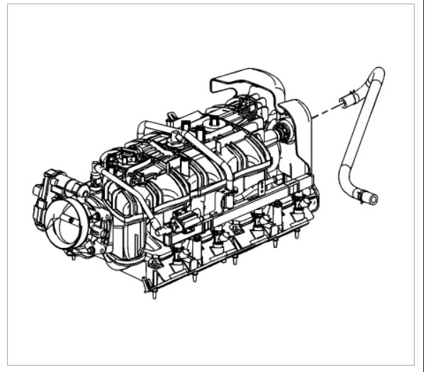

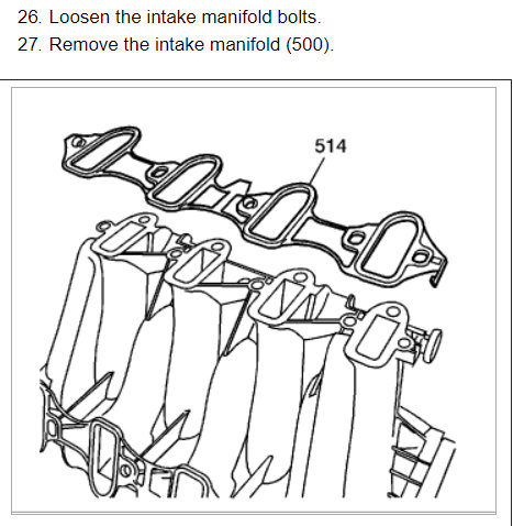

Would you happen to have the torque sequence diagrams on the intake manifold, exhaust manifold, fuel injection cross over rail and the cylinder deactivation manifold? I would like to know the torque also for the cylinder deactivation manifold.
Thanks so much!

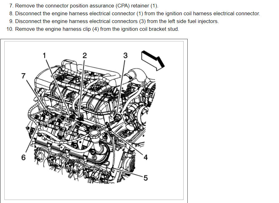

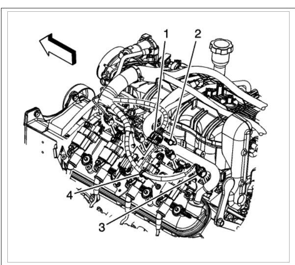

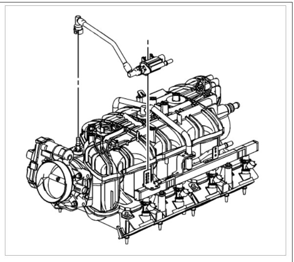

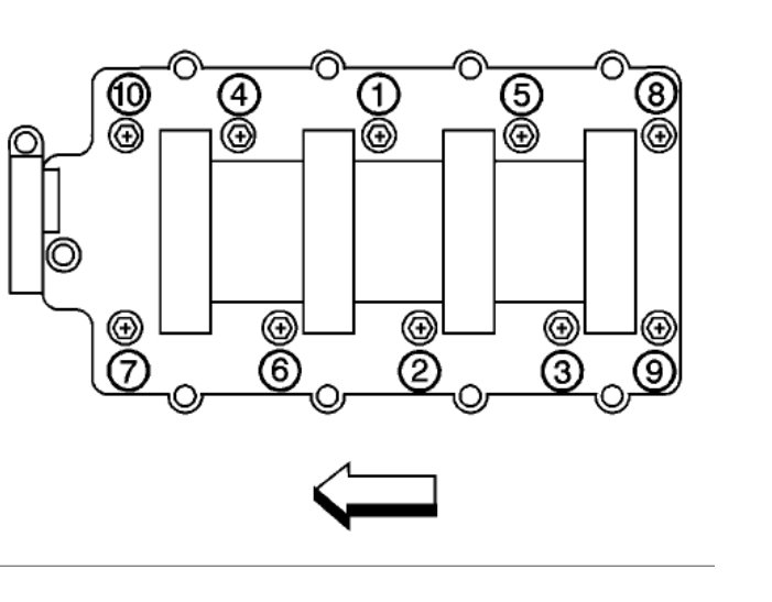

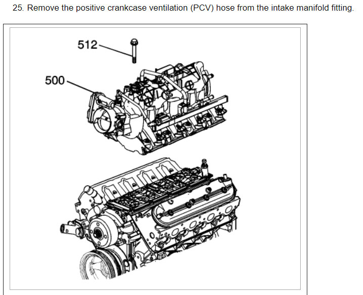

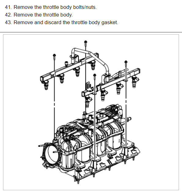

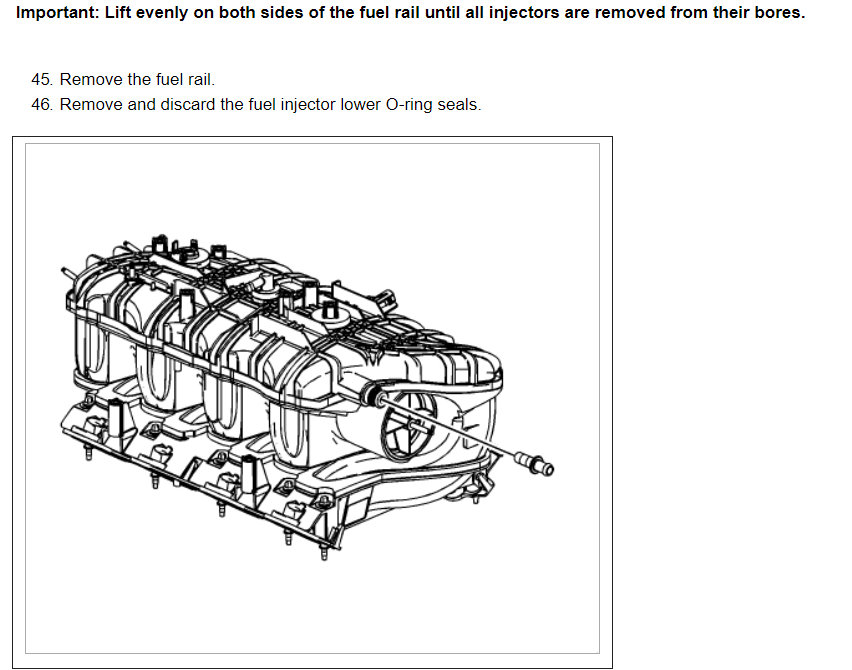

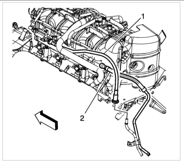

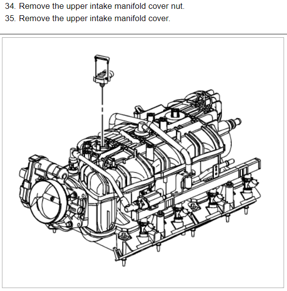

Here are the intake manifold bolt torque and sequence and a guide to give you an idea of what you are in for when doing the job:
https://www.2carpros.com/articles/replace-intake-manifold-gasket
Tighten the intake manifold bolts to specifications.
Tighten the bolts a first pass in the sequence shown to 5 N.m (44 lb in).
Tighten the bolts a final pass in the sequence shown to 10 N.m (89 lb in).

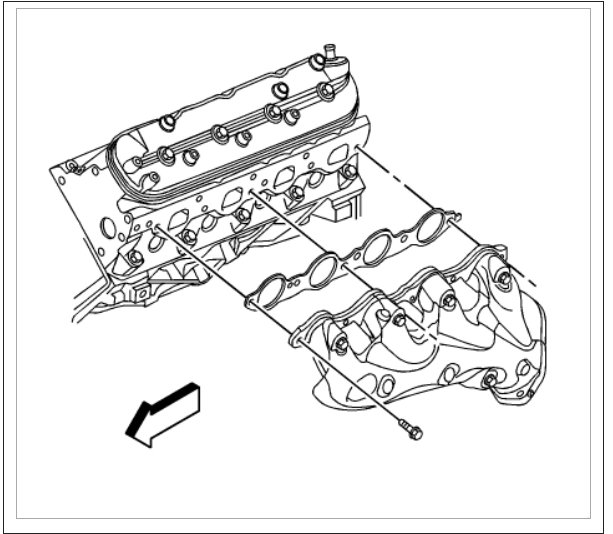

Install the exhaust manifold bolts.
Tighten the bolts a first pass to 15 N.m (11 lb ft). Tighten the exhaust manifold bolts beginning with the center 2 bolts. Alternate from side-to-side, and work toward the outside bolts.
Tighten the bolts a final pass to 20 N.m (15 lb ft). Tighten the exhaust manifold bolts beginning with the center two bolts. Alternate from side-to-side, and work toward the outside bolts.

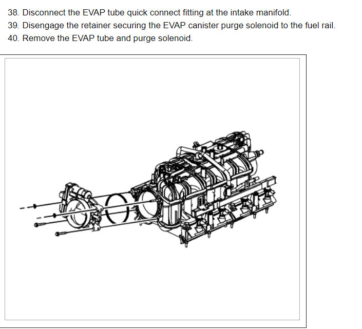

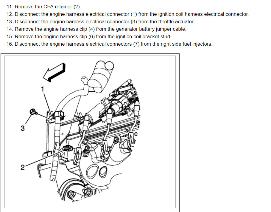

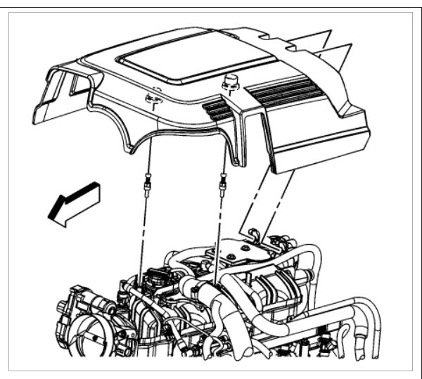

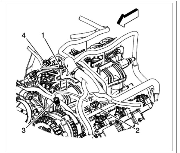

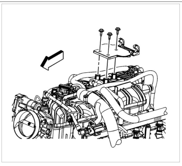

Check out the intake manifold diagrams (below).
