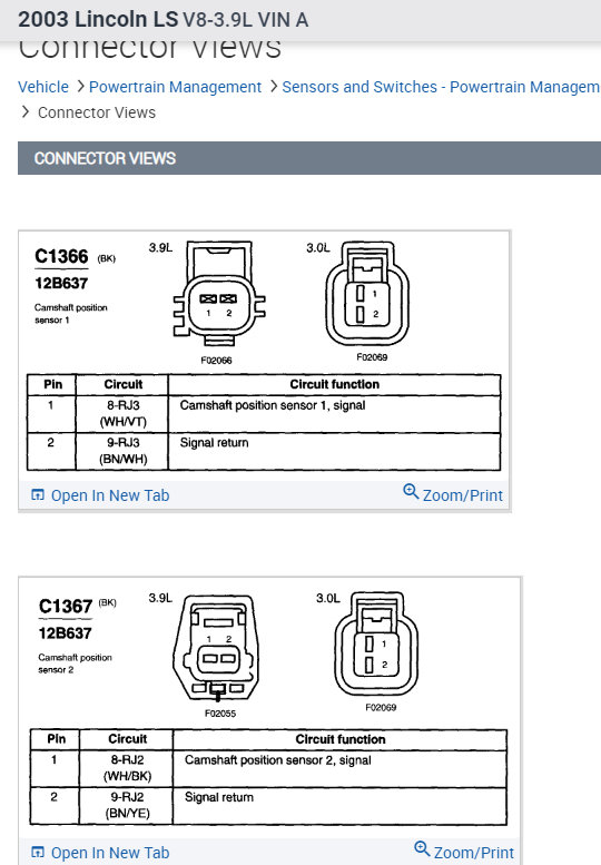

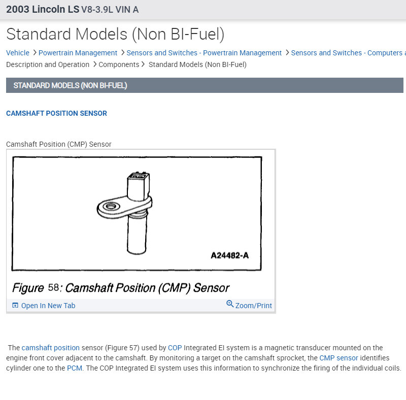

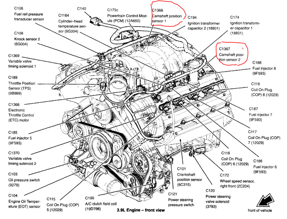

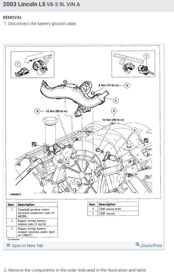

Yes, I need an engine diagram with the name of each part and directions on how to change the camshaft position sensor.
Sunday, December 19th, 2021 AT 11:33 AM
SQM
MECHANIC
6,383 POSTS
This vehicle has two camshaft positions sensors. They are located on each side of the intake manifold.
https://www.2carpros.com/articles/camshaft-angle-sensor-replacement
I have attached the diagrams below showing the location and replacement procedure.
