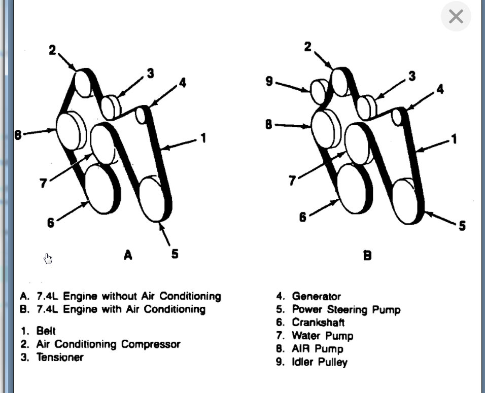

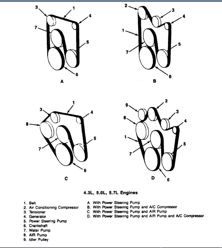

Don't know how the serpatine belt goes on.
Monday, May 10th, 2021 AT 2:03 AM
MECHANIC
18,907 POSTS
Here are the collection of all the engine serpentine belt routing diagrams:
Please run through this and let us know if you have other questions. Thanks
