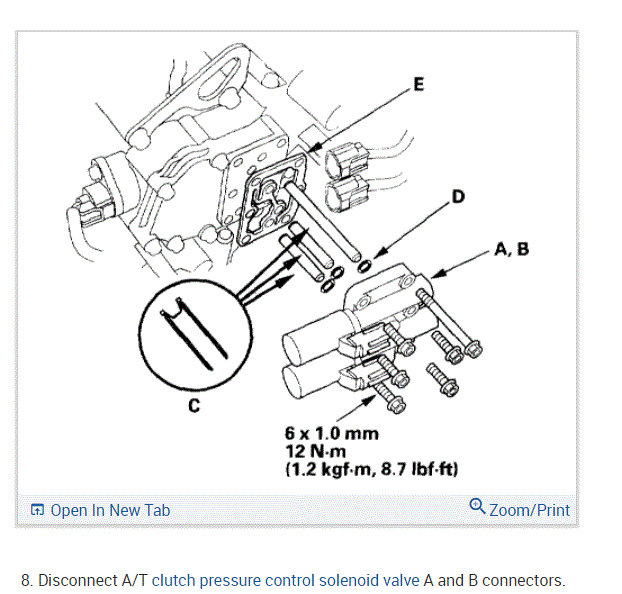

Naser, the first pic below shows the pressure control solenoid. Here are directions for shift solenoid A for diagnostics. The code indicates it is stuck open.
_______________________________
2004 Acura Truck MDX V6-3471cc 3.5L
P0752
Vehicle ALL Diagnostic Trouble Codes ( DTC ) Testing and Inspection P Code Charts P0752
P0752
DTC P0752: Shift Solenoid Valve A Stuck ON

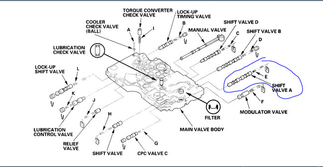

YES - Repair hydraulic system related with shift valves A and E, then go to step 13.

See pic 2 for shift valve.
