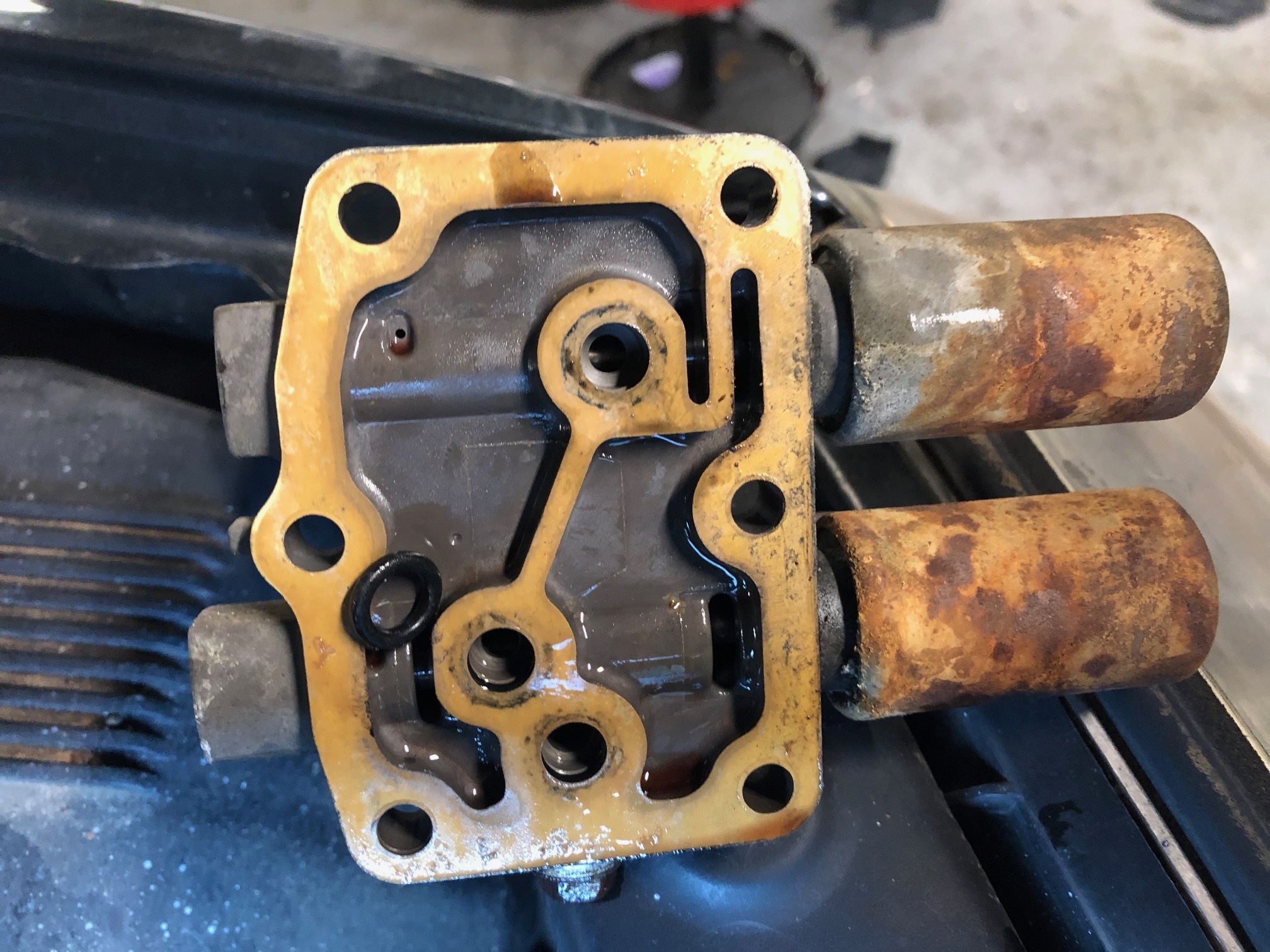

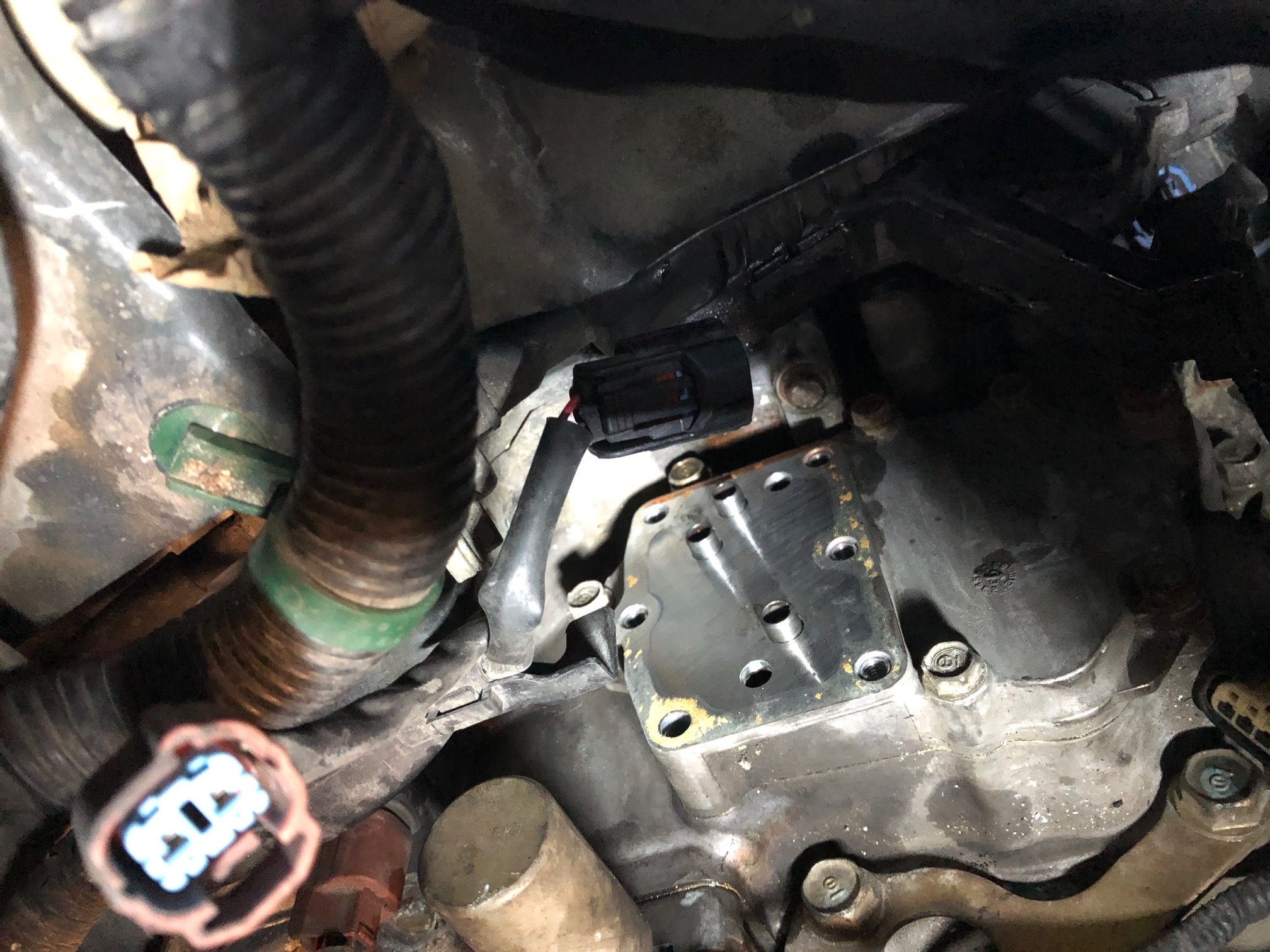

found 2 of them, one on top of the transmission with a cylinder like, 4 bolts, the other one on side of the transmission with 6 bolts and 2 cylinders.. removed this second one but noticed there was one plastic o-ring only, either I dropped them off while removing it or someone was cleaning it before and put it back with only one.. see pics. I can't find anything on my end, I will try to find a couple of those around here.
Aug 9, 2020 at 5:31 PM
NASER NASER
  • 836 POSTS

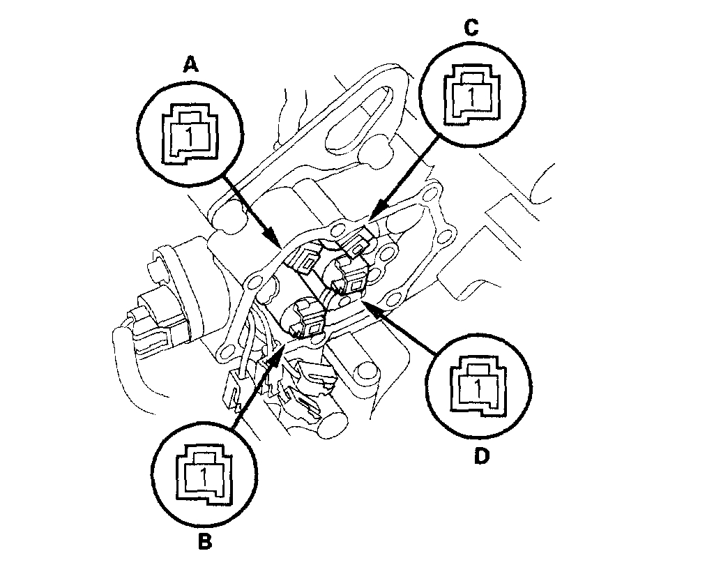

I still want to know which controls first gear the one on top or on side? i found where those washers were.
Aug 9, 2020 at 6:06 PM
  • 110,193 POSTS

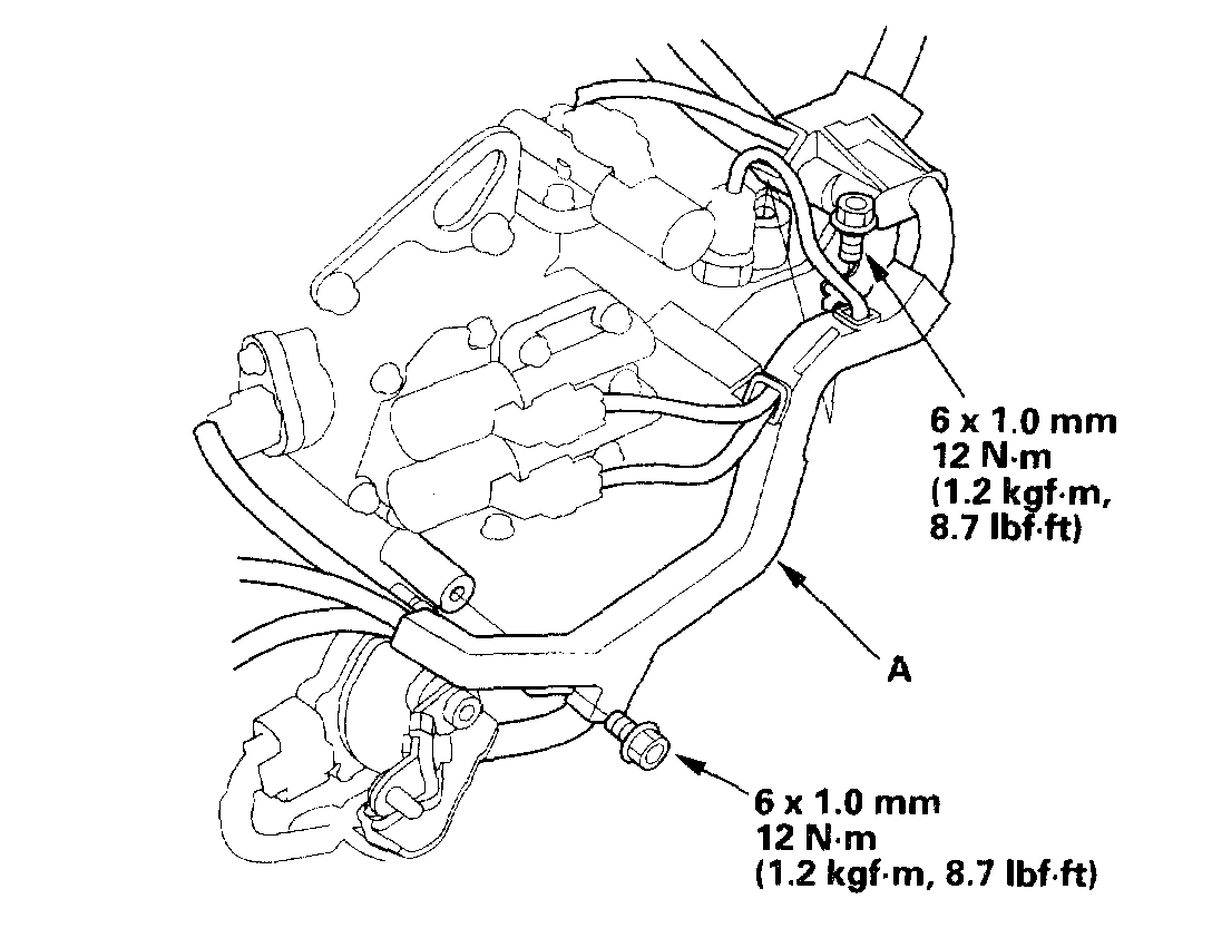

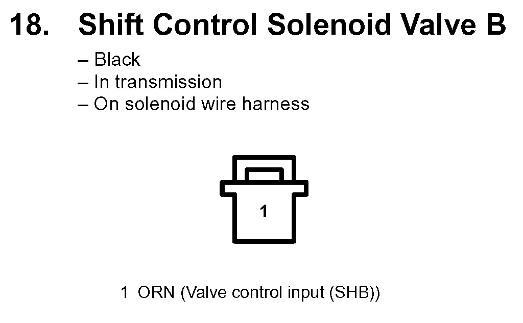

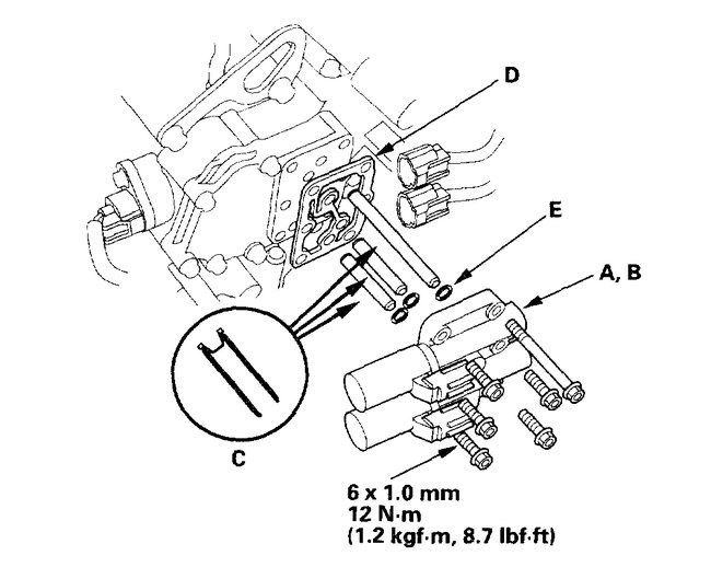

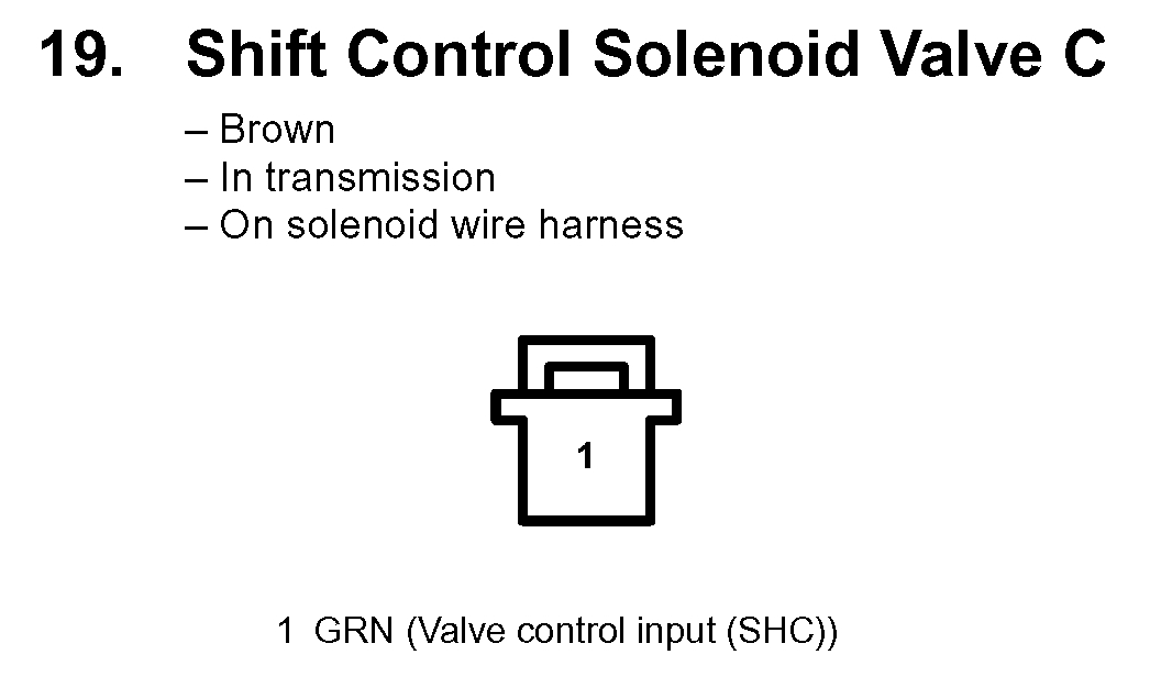

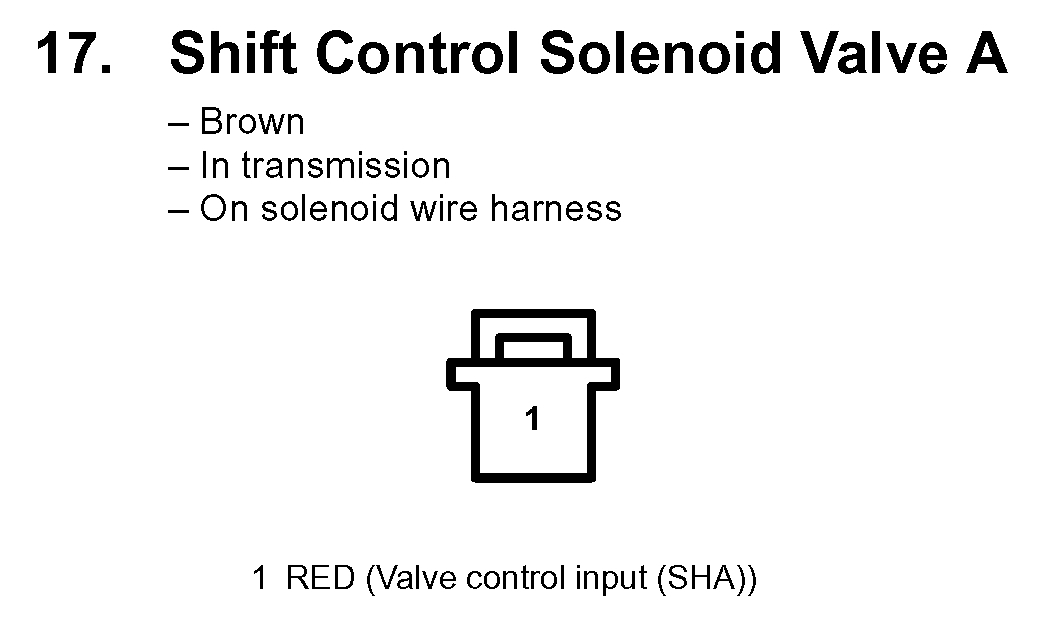

Naser,

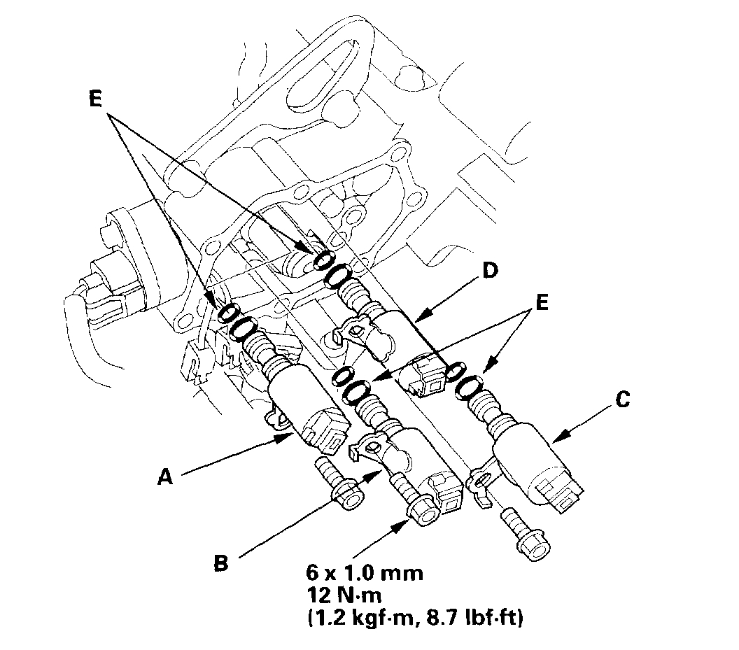

I looked this up for you. The first three pics below show each of the three shift solenoids and identify each by the color of the connector.
Here are the directions for testing:

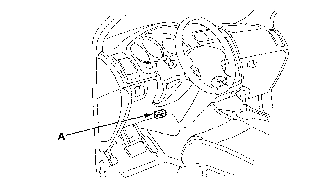

1. Connect the HDS to the DLC (A).

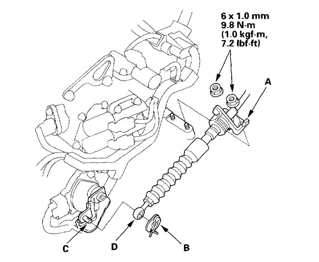

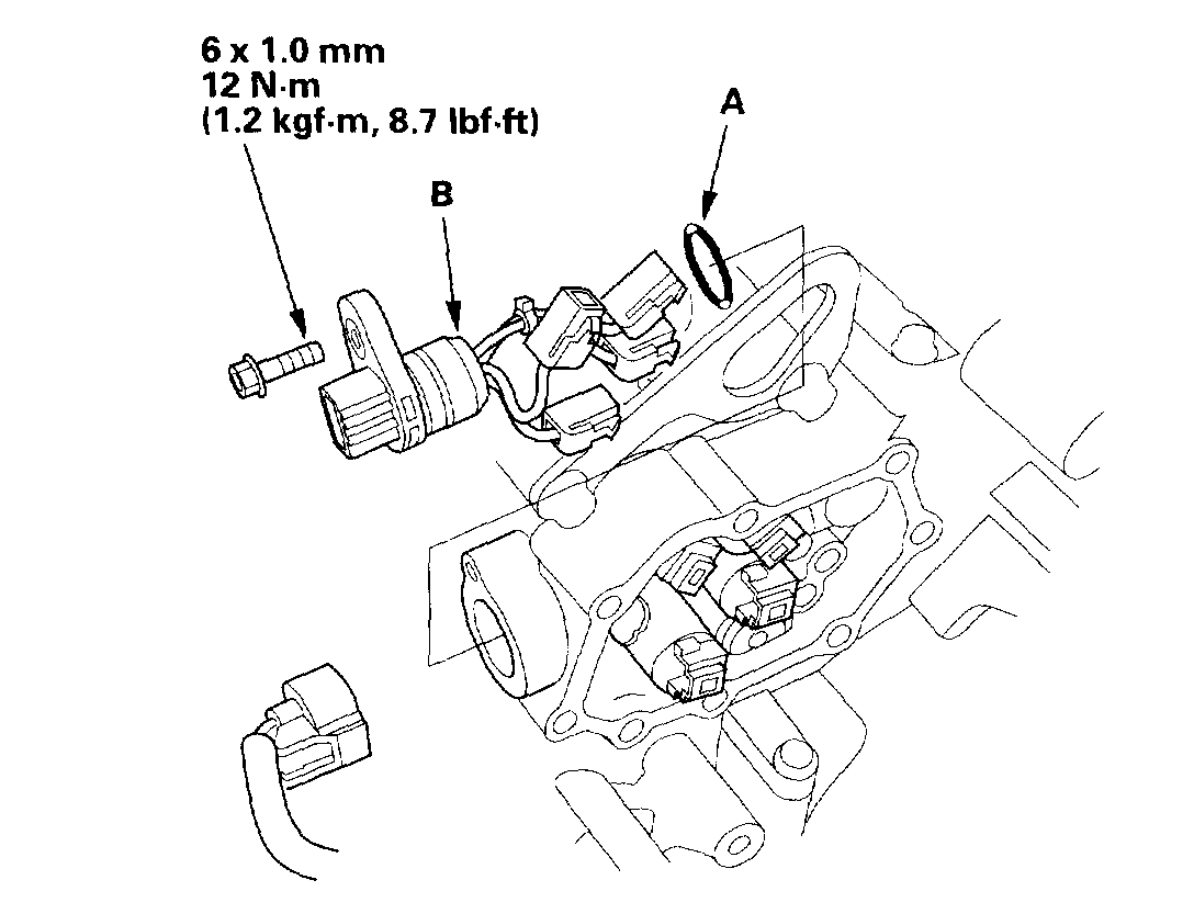

pic 5

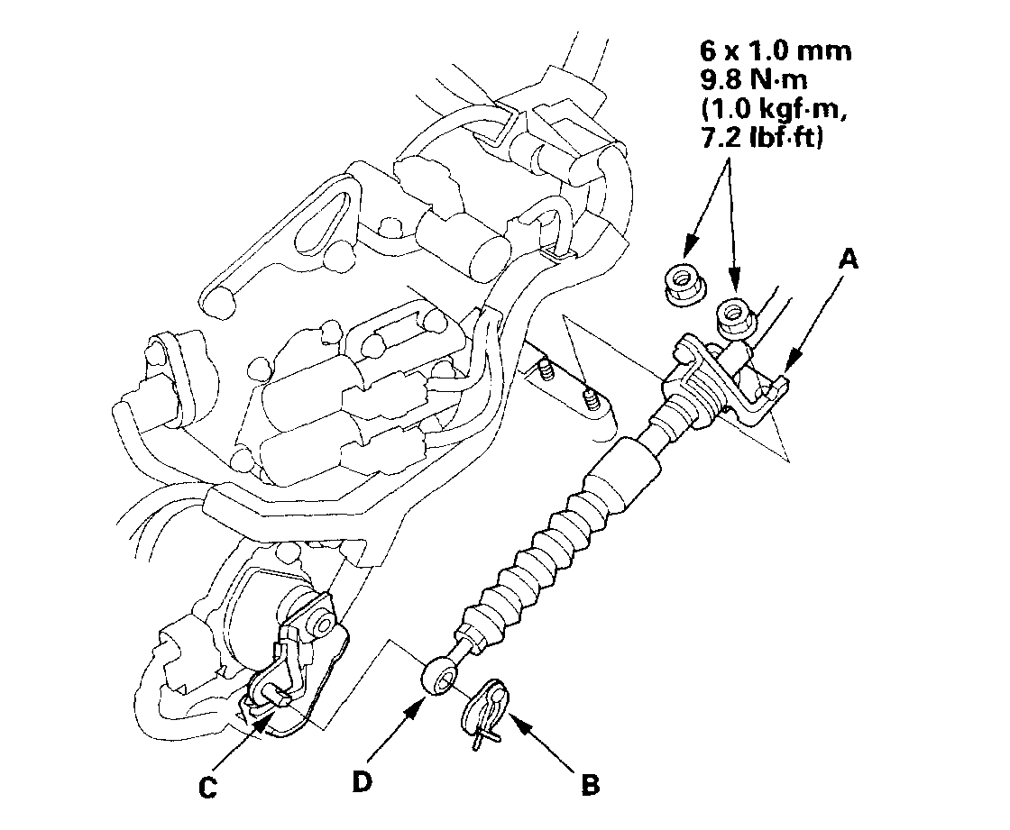

11. Remove the nuts securing the shift cable bracket (A).
12. Remove the spring clip/washer (B) from the control lever (C), and disconnect the shift cable end (D) from the control lever.

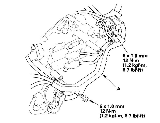

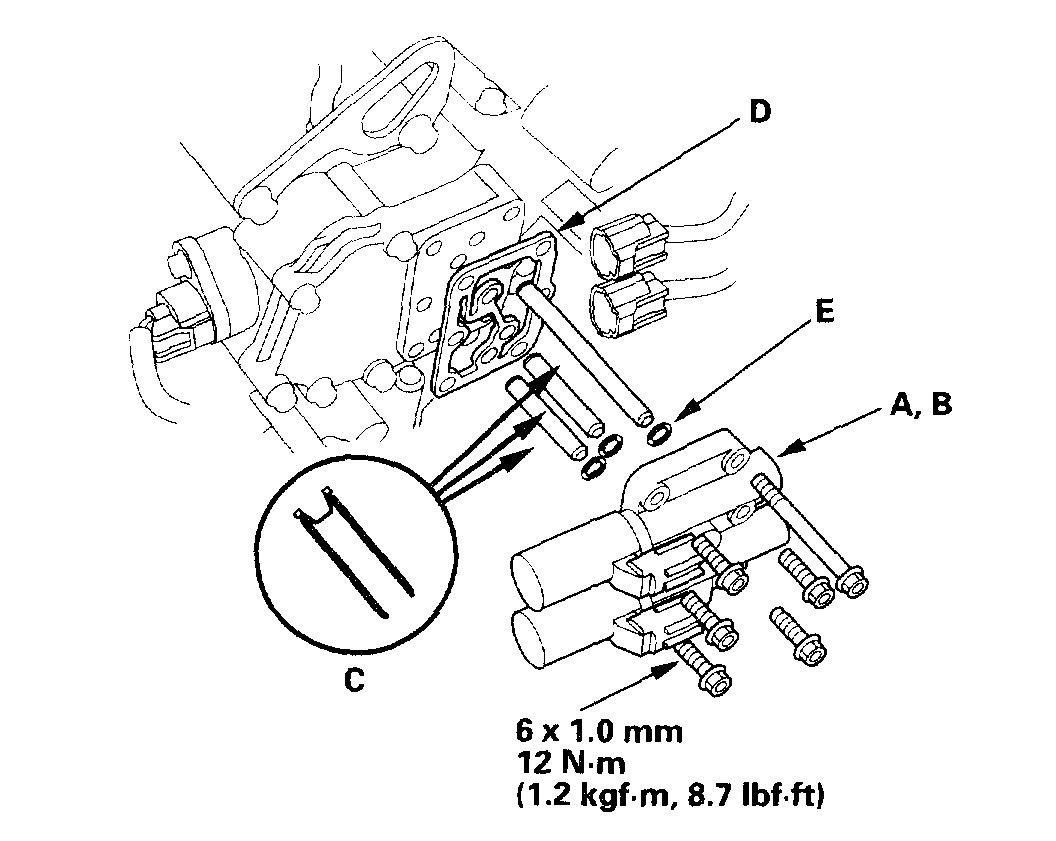

pic 6
13. Remove the bolts securing the harness cover (A).

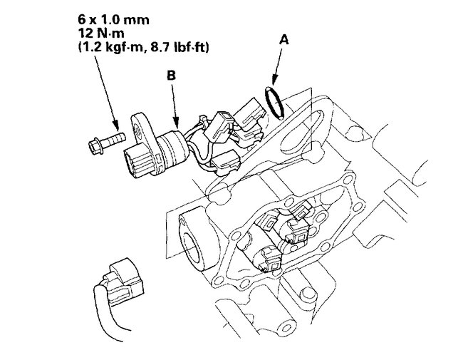

pic 7

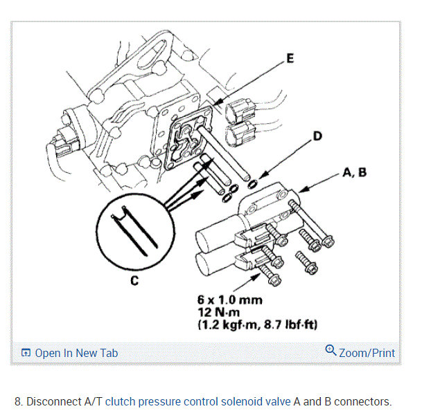

14. Disconnect the connectors from A/T clutch pressure control solenoid valve A and B, and remove the solenoid valves, ATF pipes (C), and gasket (D).
15. Replace the gasket and O-rings (E) with new ones when installing the A/T clutch pressure control solenoid valve A and B.
pic 8

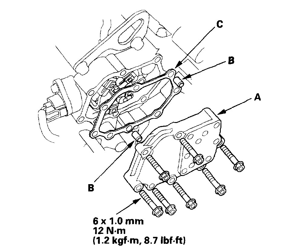

16. Remove the solenoid valve cover (A), dowel pins (B), and gasket (C).
17. Replace the gasket with new one when installing solenoid cover.
pic 9
18. Disconnect each solenoid valve connector.

24. Install a new O-ring (A) on the solenoid harness connector (B), and install the connector in the transmission housing.
25. If the solenoid valve is faulty, go to step 26 for solenoid valves replacement. If the solenoid valves and solenoid harness are OK, go to step 32, and connect the connectors and install the removed parts.

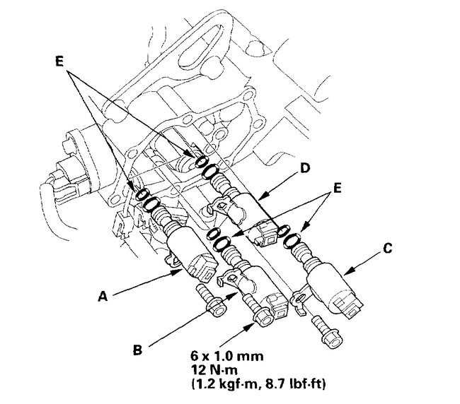

26. Remove the mounting bolts, then remove the solenoid valves.
pic 11
27. Install the new O-rings (E) on each solenoid valves.
NOTE: The new solenoid valve is equipped with the new O-rings. If you install the new solenoid valve, it is no need to replace the new O-rings on it.
28. Install shift solenoid valve B (black connector) by holding the shift solenoid valve body; be sure to install mounting bracket contacts to the accumulator body.
NOTE: Do not hold the solenoid valve connector to install the solenoid valve. Be sure to hold the solenoid valve body. Do not install the shift solenoid valve C before installing the torque converter clutch solenoid valve (D). If solenoid valve C is installed before torque converter clutch solenoid valve, it may damage to hydraulic control system.
29. Install torque converter clutch solenoid valve (black connector) by holding the solenoid valve body; be sure to install mounting bracket contacts to the accumulator body.
30. Install shift solenoid valve C (brown connector) by holding the shift solenoid valve body; be sure to install mounting bracket contacts to the bracket of torque converter clutch solenoid valve.
31. Install shift solenoid valve A (brown connector) by holding the shift solenoid valve body; be sure to install mounting bracket contacts to the accumulator body.

If you noticed, they show the solenoids as A. B, C, and D. D is the torque converter clutch solenoid. The others are in order. (A= 1-2 shift, B=2-3 shift, C=3-4 shift)
Let me know if this helps.
Take care. By the way, this isn't a German car. What's up with that? LOL

Thanks for the info. There are so many labeled A. So which one controls 1-2nd gear? Which solenoid in the pictures?
Aug 10, 2020 at 8:56 AM
NASER NASER
  • 836 POSTS
the 10th picture, where is that, behind the solenoid with 6 bolts?

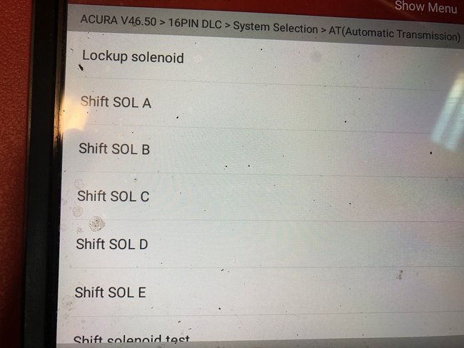

I used my scanner to actuate the solenoids and these in the picture did click.
Aug 10, 2020 at 12:07 PM
  • 110,193 POSTS
They should click because we know it is shifting, just not at the right time. I suspect you will need to check resistance.

Maybe, but doubt it. Quick questions. Are the two brown and 2 black solenoids the same? Say if i switch them?
Aug 14, 2020 at 12:51 PM
  • 110,193 POSTS
Naser, that's a good question. I believe they are. They perform the same type of job, so I'm going to say give it a try.

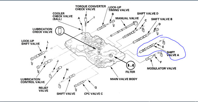

Naser, the first pic below shows the pressure control solenoid. Here are directions for shift solenoid A for diagnostics. The code indicates it is stuck open.

YES - Repair hydraulic system related with shift valves A and E, then go to step 13.

See pic 2 for shift valve.
