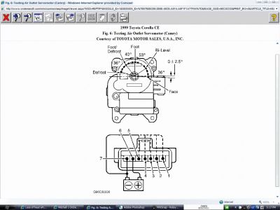

Look far a leaking servo, tht's the vacuum motor. Does any of them reopen after they have moved? It sounded like you said it took 2-3 minutes, then the cold set in? Also when it turns cold check the water inlet to see if it has cooled. If there is a valve in the waterline it may be closing the water flow off!
Friday, January 3rd, 2020 AT 4:21 PM (Merged)
MERLIN2021
  • 17,250 POSTS

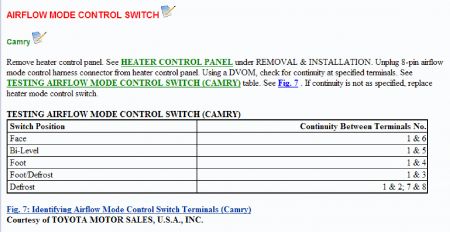

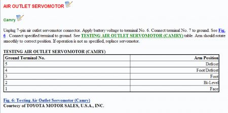

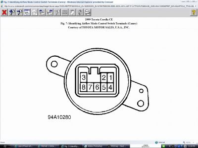

Here are some test proceedures to follow!
https://www.2carpros.com/forum/automotive_pictures/62217_Heat1_1.jpg
https://www.2carpros.com/forum/automotive_pictures/62217_Heate1r_1.jpg
https://www.2carpros.com/forum/automotive_pictures/62217_Heat2_1.jpg
https://www.2carpros.com/forum/automotive_pictures/62217_Heater_1.jpg
