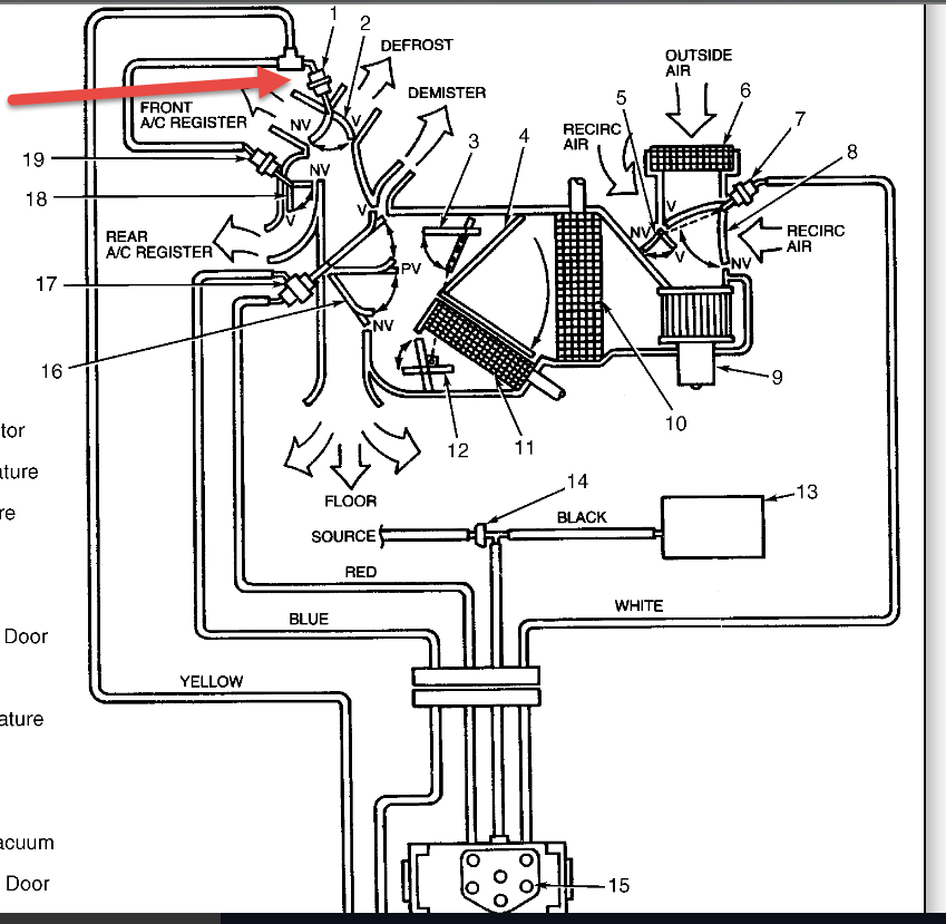

Dash vents have stopped blowing
RONALD W AUSTIN
  • 1999 FORD TAURUS
  • V6
  • FWD
  • 120,000 MILES
The air has stopped blowing out of the front dash vents. The air still blows out of the top vents near the windshield and the top vents near the side windows.
Friday, July 7th, 2017 AT 3:32 PM
HMAC300
  • 48,601 POSTS

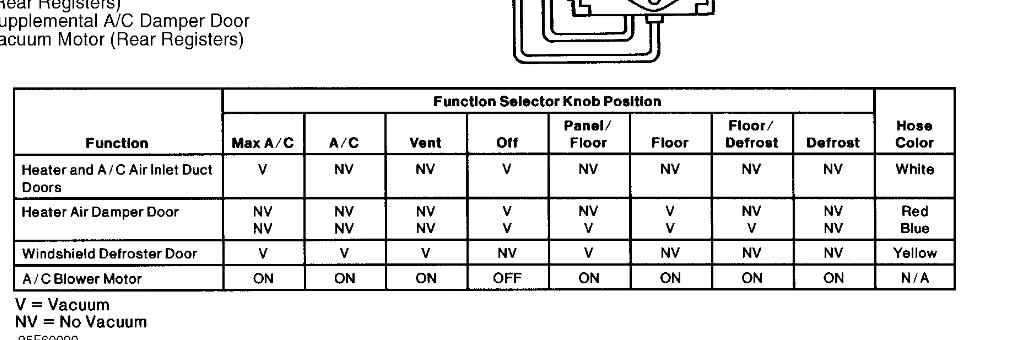

Check for a vacuum leak. Make sure control is getting vacuum then follow chart to vacuum motor pointed out in picture.
