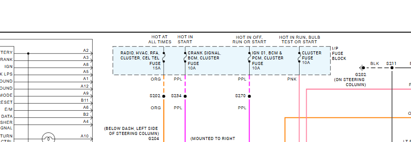

dash light issues PRNDL and mileage ?
2000 BUICK CENTURY
152,000 MILES • 3.1L • V6 • 2WD • AUTOMATIC
WIMMS77
so on my dash everything works except for the lights that show the PRNDL and mileage I have googled it looked it the repair manual and tinkered with it until I'm fed up trying to figure it out on my own so can you please help me try to fix this issue

The power to these is controlled by the headlight switch. If it's not dimmed, I would first try a new headlight switch.

I would check the four fuses that run the cluster first and if they are okay chances are the cluster itself is bad. What happens is the LED board or the driver goes out so the cluster will need to be rebuilt, you can search google or ebay for a rebuilder but lets check the fuses first this guide can help with the fuse location in the images below.
you can try a reboot as well, this might work
