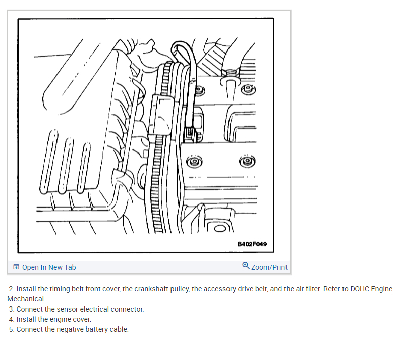

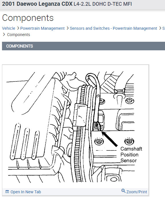

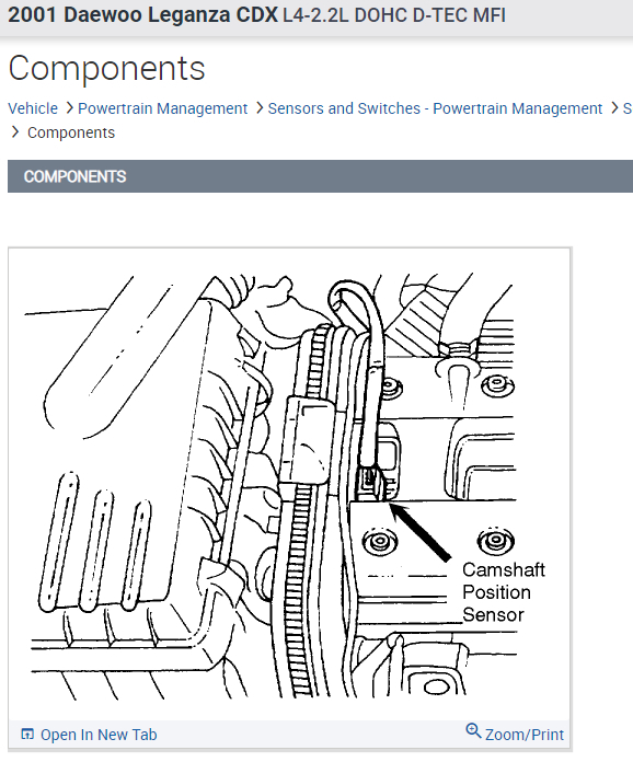

what is the location of this expensive part so i can get this over with. i bought this $226 dollar part and now i need to know where it goes.
Mar 10, 2009 at 6:57 PM
SQM
  • CAR REPAIR CONTRIBUTOR
  • 6,383 POSTS

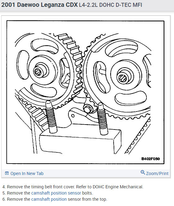

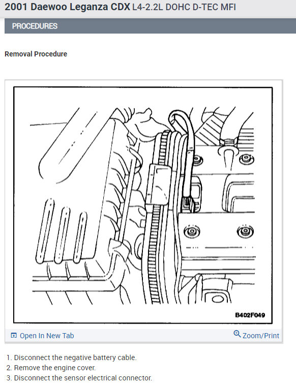

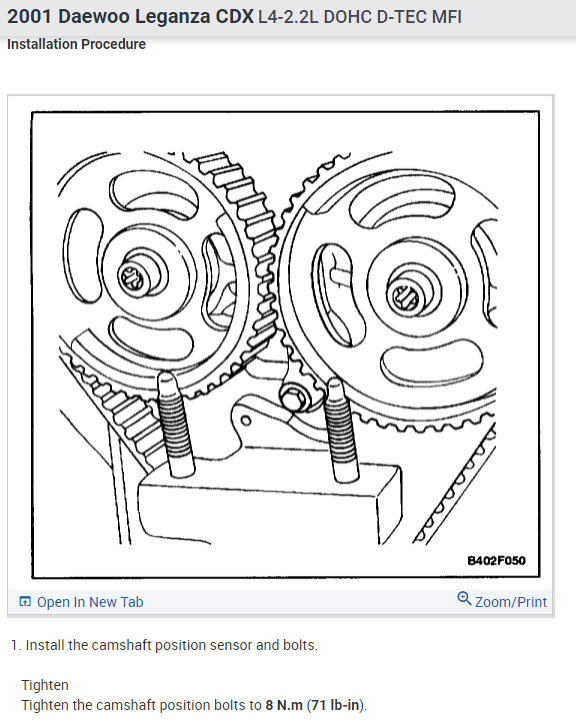

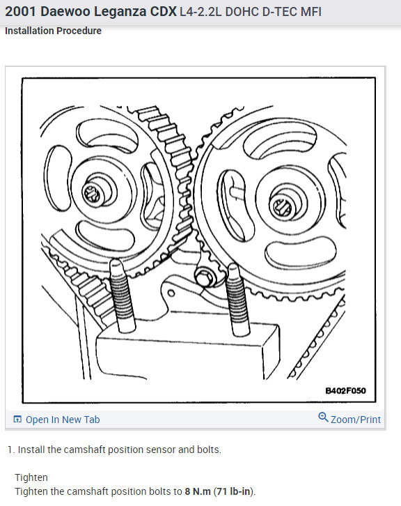

The camshaft position sensor is located on the upper part of the engine (see diagram below). It is at the left side of the engine, if you are facing the car.
You will have to remove the engine cover to access the sensor.
https://www.2carpros.com/articles/camshaft-angle-sensor-replacement
I have attached the replacement procedure.
