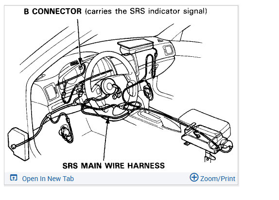

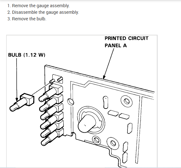

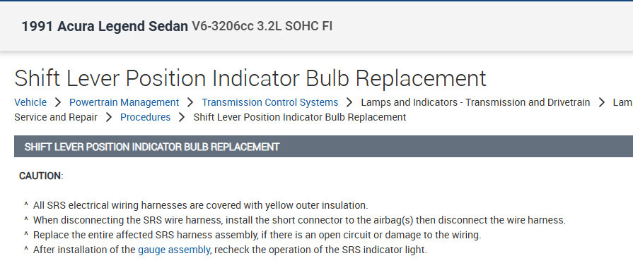

I was having a problem with my fuel pump relay, the main one. I then replaced it but now my D4 light won’t come on. I get d1d2d3 But I do not get d4. I was reading up a little bit and it says it may be the transmission control unit, but I can’t find out where it is as anybody else had this issue.

Does the transmission shift normally when placed in D4? I ask because there are individual bulbs that can fail. See pics below.
Next, as far as the transmission control module, the vehicle's transmission is controlled by the engine control module. There isn't a separate module only for the transmission. With that, I would recommend checking for diagnostic trouble codes. Here is a link that explains how to retrieve them.
