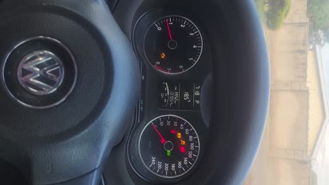

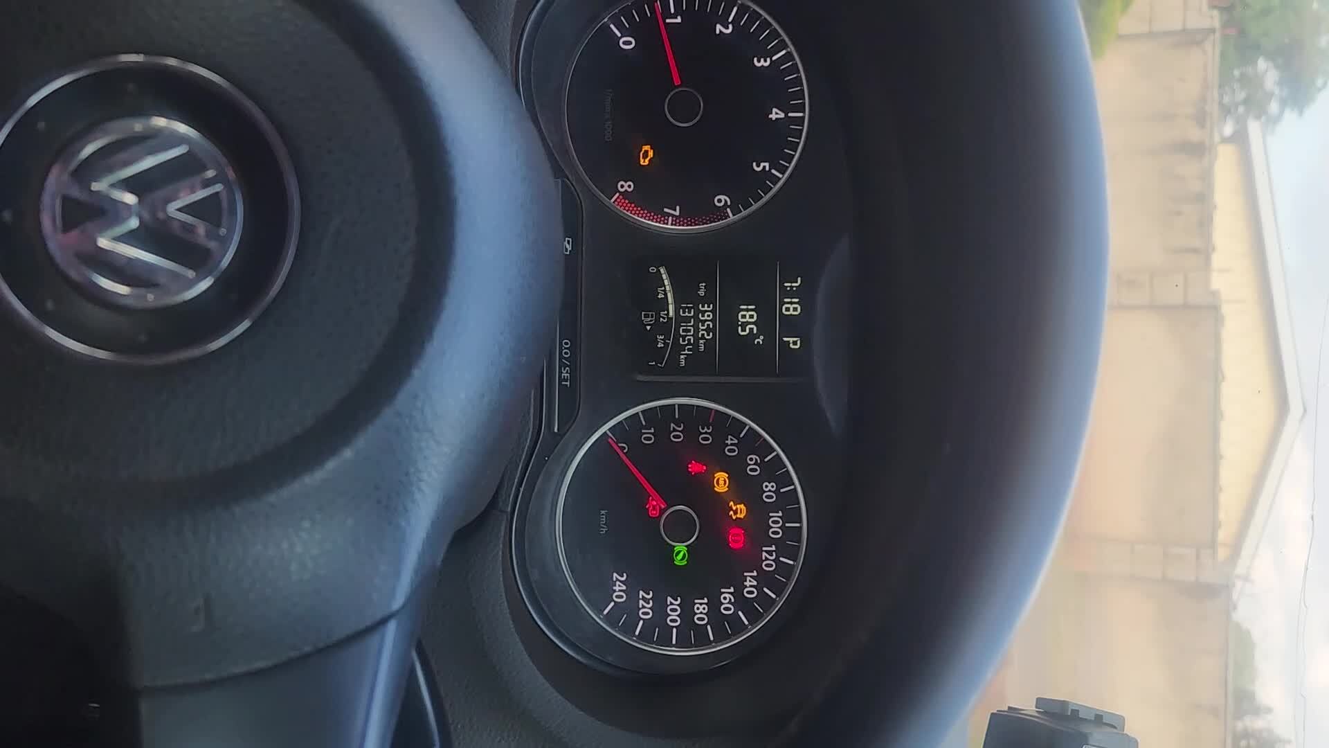

As you can see, the clicking sound is occurring at the same time the "press the brake pedal" shoe disappears, I'd assume the sound has something to do with the braking system though I'm not sure because when the shoe is stable as it has to, there's no clicking sound, as soon as it starts disappearing the noises also start.

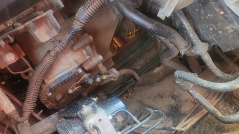

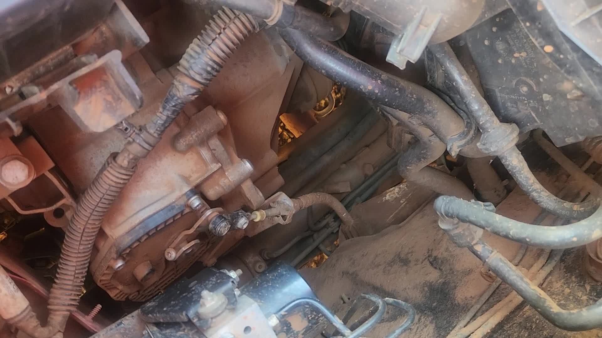

And here, I'm not really sure which component is making the noise but I thought it may be the gearbox.

Thanks for the videos, I am not sure what that noise is but it sounds like the transmission will need to come out and be rebuilt.
