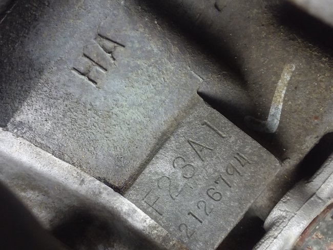

STACY ZIMMERMAN
  • 26 POSTS
Picture of number on block F23A1.

That appears to be a 2.3L. Here are the directions I have for it. These are for the single overhead cam engines. If you have something different, let me know.
These directions are from start to finish. The attached pics correlate with the directions. They will indicate timing marks.

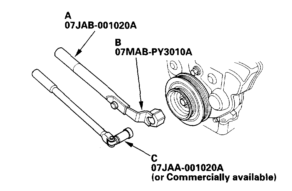

Special Tools Required
- Holder Handle 07JAB-001020A
- Holder Attachment, 50 mm, Offset 07MAB-PY3010A
- Socket, 19 mm 07JAA-001020A or a commercially available 19 mm socket

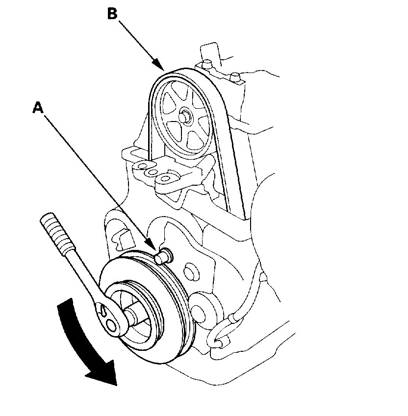

Pic 1

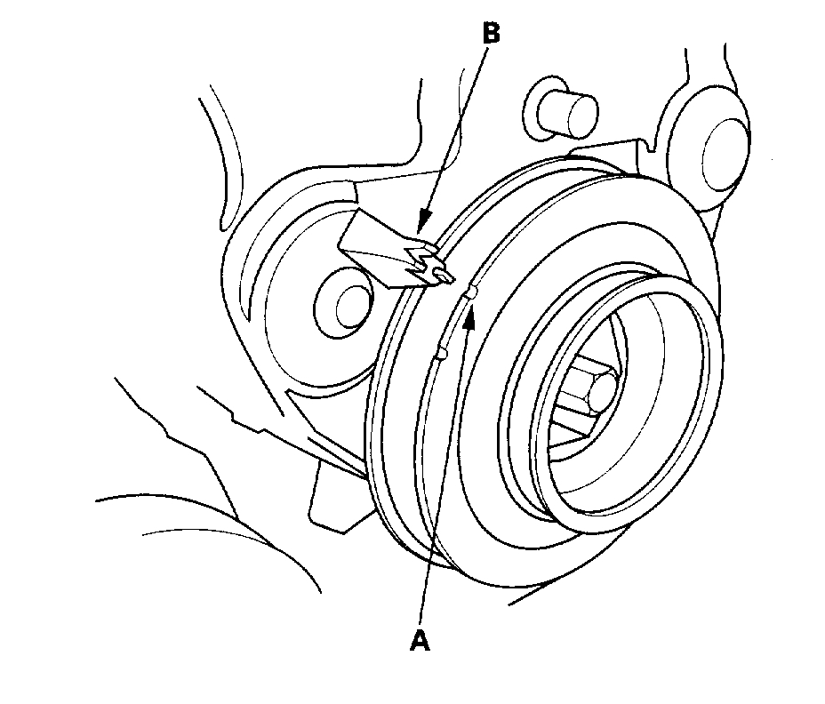

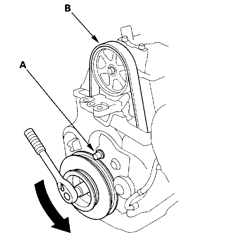

3. Turn the crankshaft pulley so its TDC mark (A) lines up with the pointer (B).

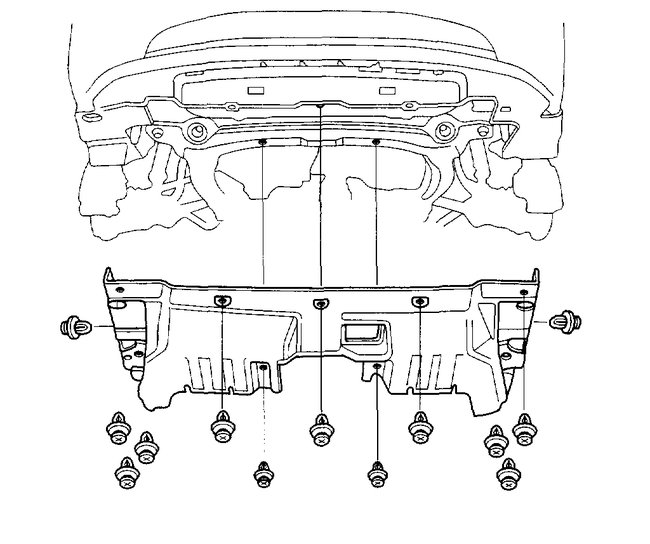

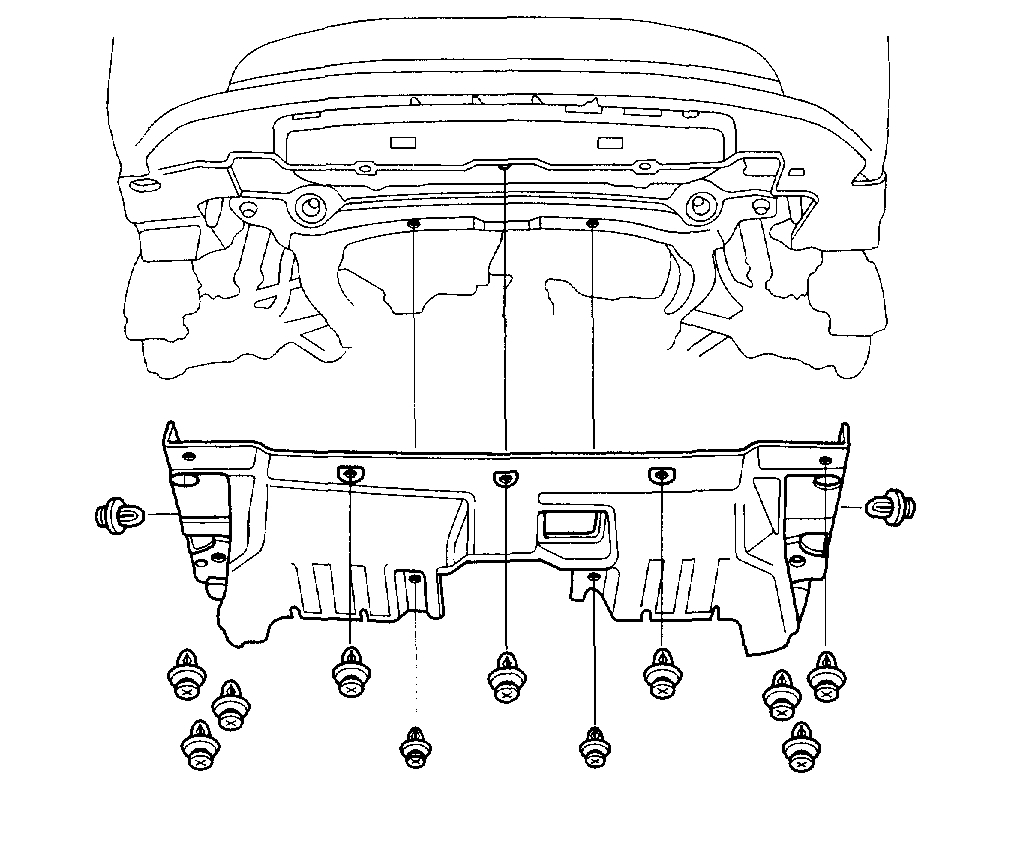

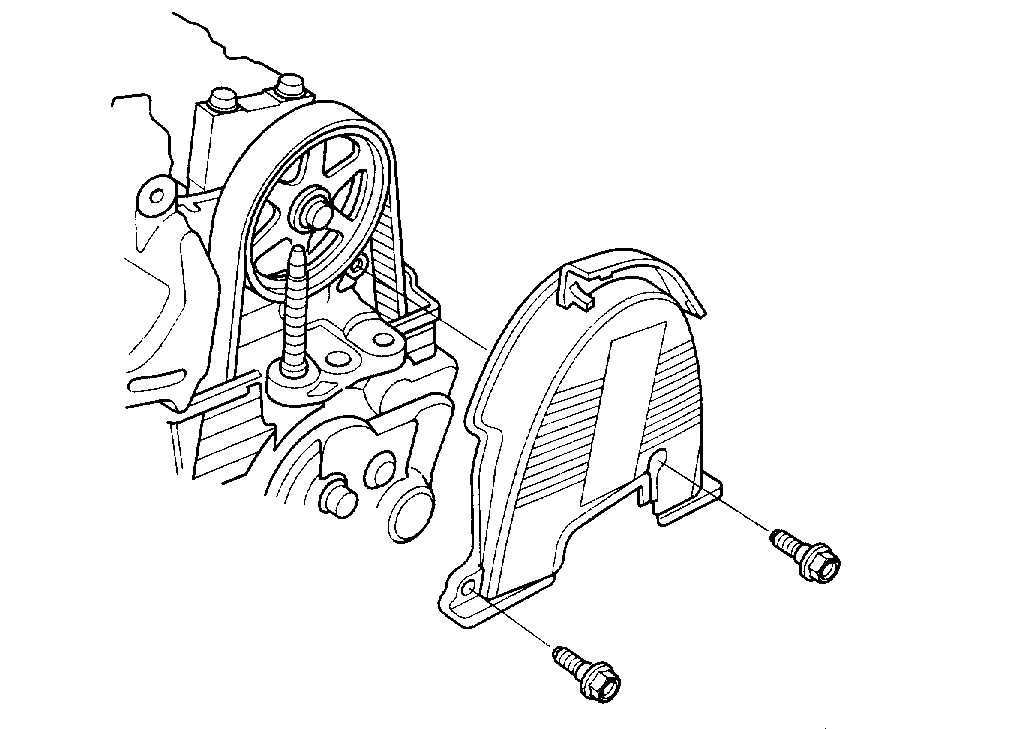

5. Remove the splash shield.
Pic 3

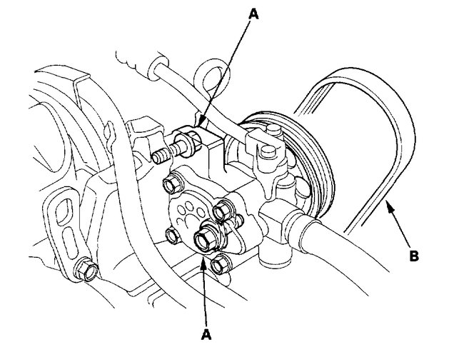

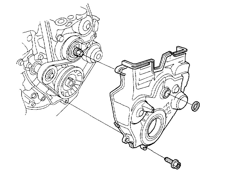

6. Loosen the mounting bolts (A), then remove the P/S belt (B).
Pic 4

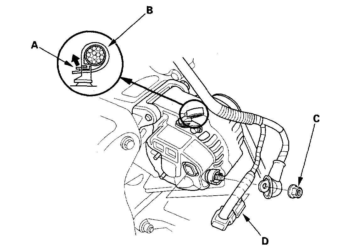

7. Disconnect the alternator wire harness.
- 1 Pull up the lock (A), then release the wire harness tie (B).
- 2 Pull back the boot and remove the 6 mm nut (c).
- 3 Disconnect the connector (D) from the alternator.

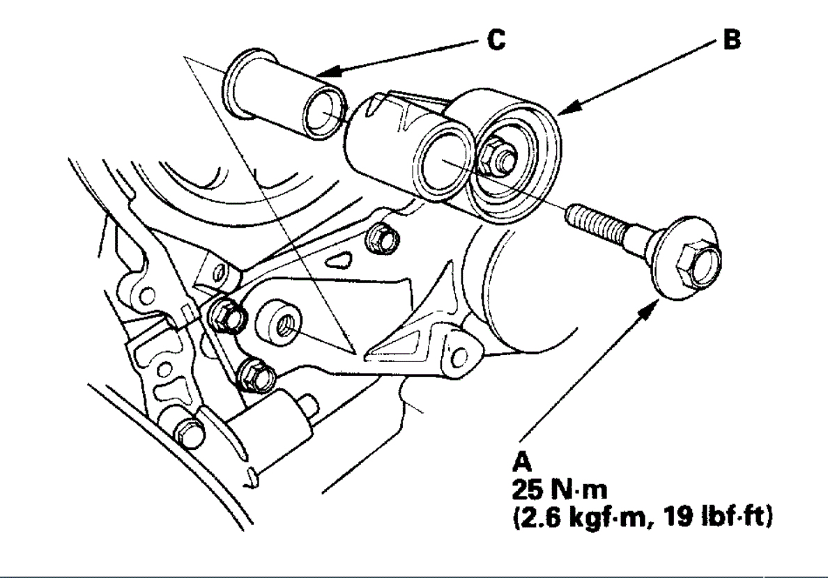

10. Support the engine with a jack and wood block under the oil pan.
Pic 5

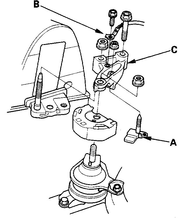

11. Remove the stopper (A) and ground cable (B), then remove the upper bracket (C).

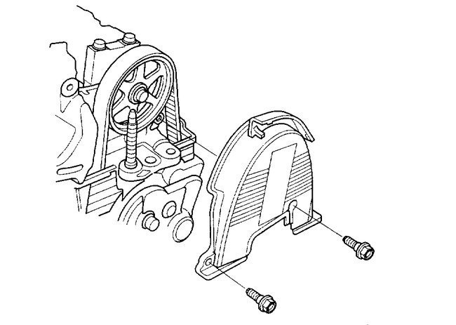

12. Remove the cylinder head cover.
Pic 6

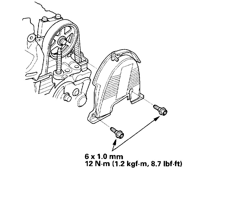

13. Remove the upper cover.
Pic 7

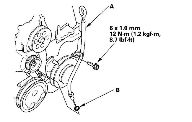

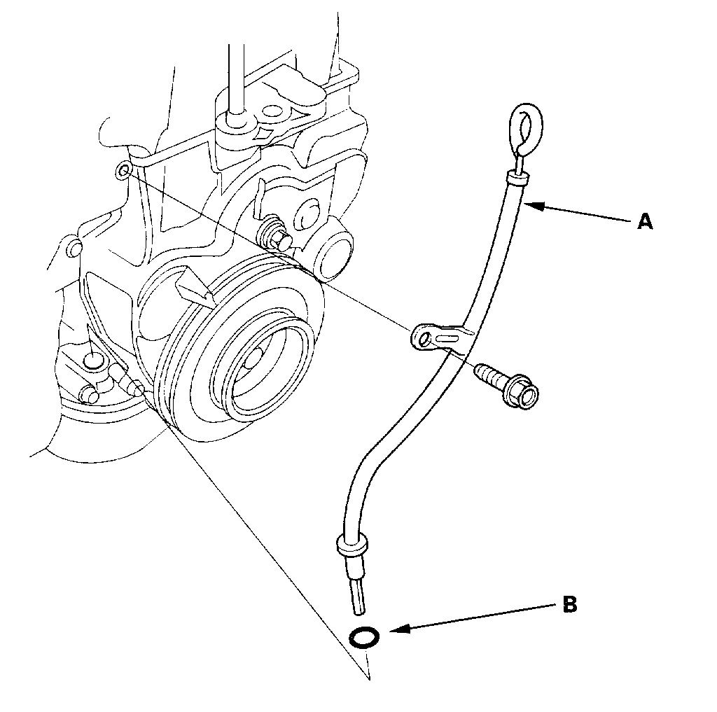

14. Remove the dipstick and tube (A). Discard the O-ring (B).
Pic 8

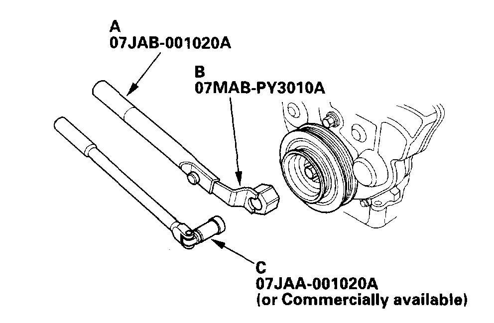

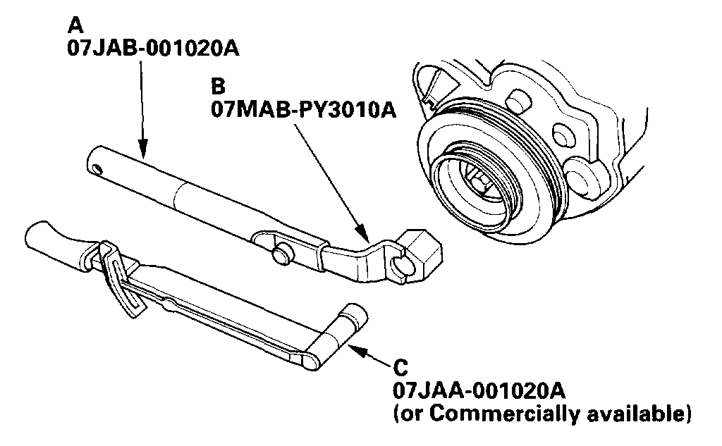

15. Hold the pulley with holder handle (A) and holder attachment (B).
16. Remove the bolt with a heavy duty 19 mm socket (c) and breaker bar.
Pic 9

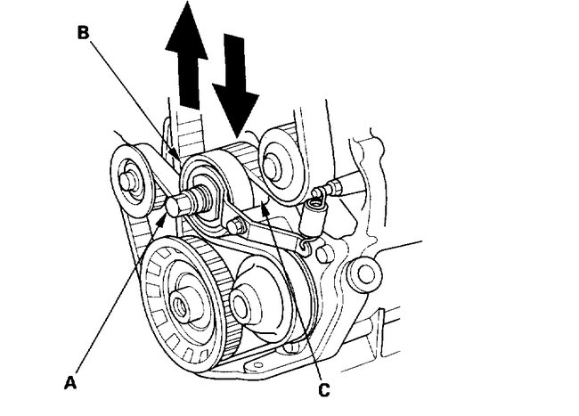

20. Release tension from the balancer belt and the timing belt:
- 1 Loosen the adjusting nut (A) 2/3 - 1 turn.
- 2 Push the balancer belt tensioner (B) up to take tension off the balancer belt.
- 3 Push the timing belt tensioner (c) down to take tension off the timing belt.
- 4 Retighten the adjusting nut (A).

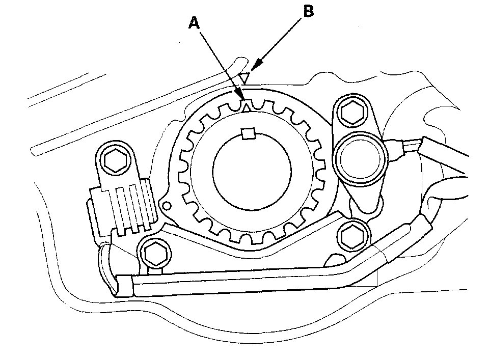

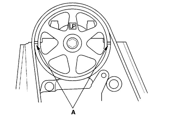

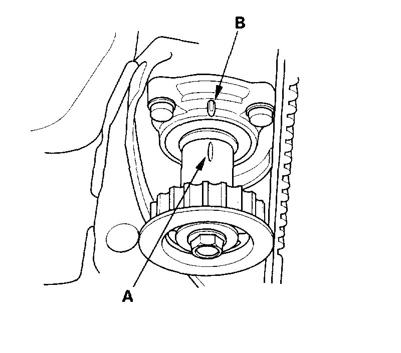

3. Set the crankshaft to TDC. Align the dimple (A) on the tooth of the timing belt drive pulley with the pointer (B) on the oil pump.
Pic 13

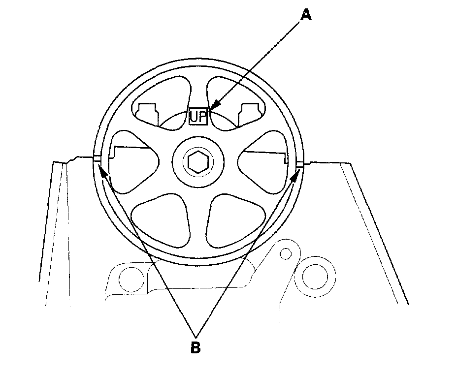

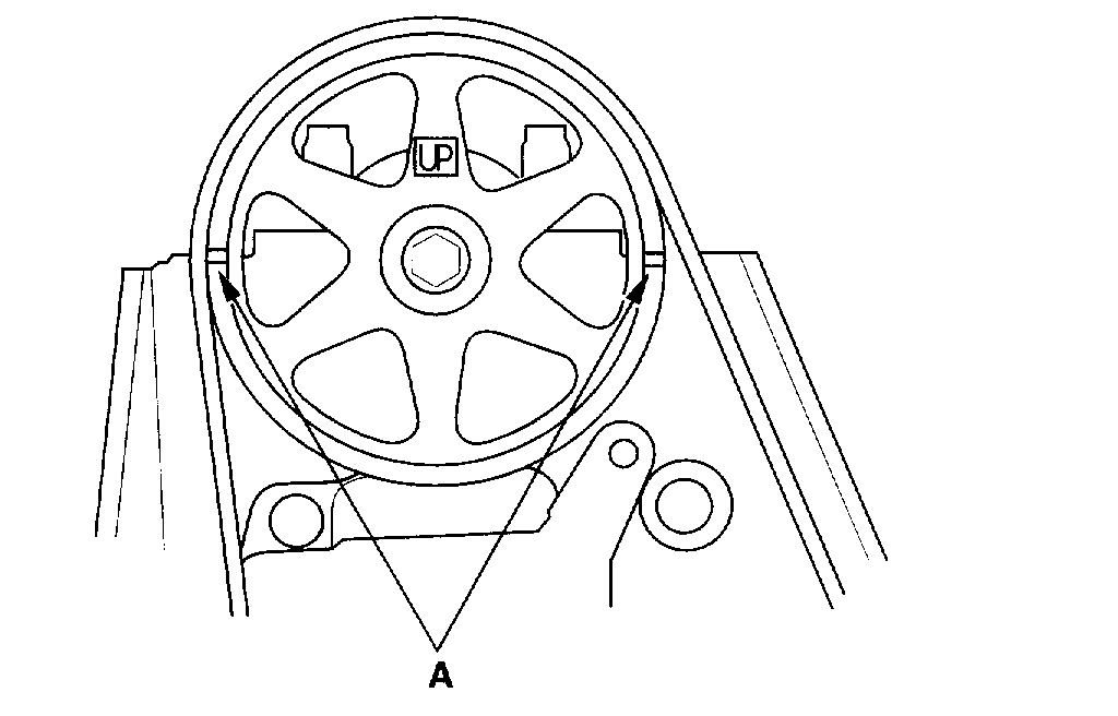

4. Clean the camshaft pulley and set it to TDC.
- 1 The "UP" mark (A) on the camshaft pulley should be at the top.
- 2 Align the TDC grooves (B) on the pulley with the too edge of the head.
Pic 14

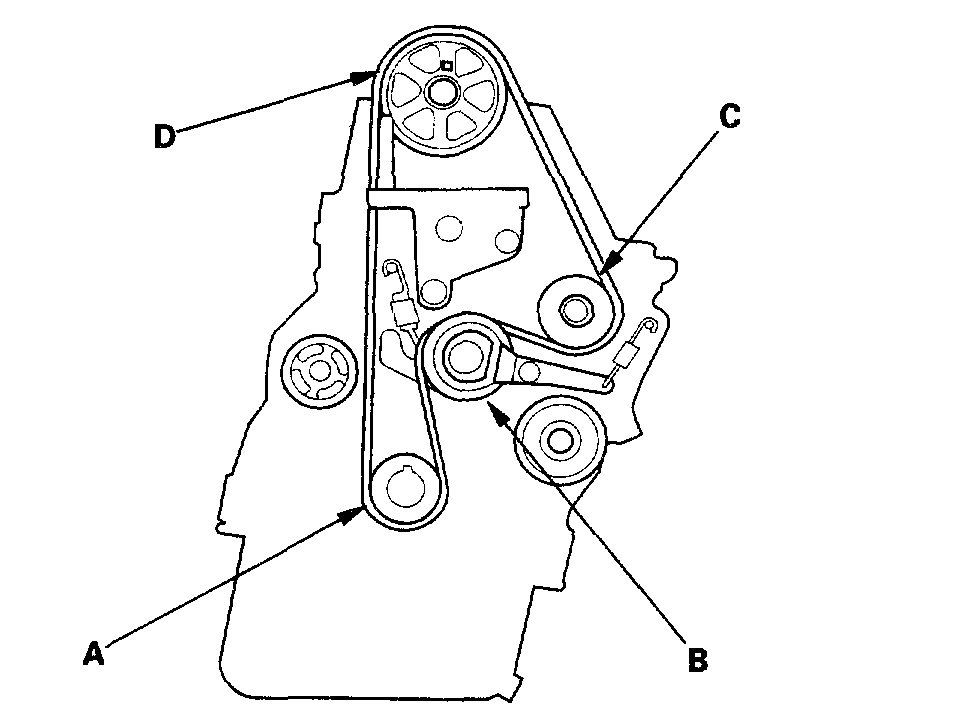

5. Install the timing belt in a counterclockwise sequence, starting with the drive pulley.
- 1 Drive pulley (A).
- 2 Tensioner pulley (B).
- 3 Water pump pulley (C).
- 4 Camshaft Pulley (D).

pic 16
13. Turn the crankshaft pulley so its TDC mark (A) lines up with the pointer (B).
Pic 17
14. Check the camshaft pulley marks.
- If the camshaft pulley marks are also at TDC, go to step 15.
- If the camshaft pulley marks are not at TDC, remove the timing belt and repeat steps 3, 4 and 5.

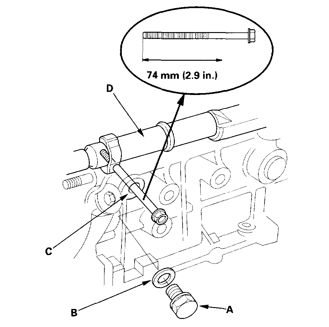

19. Align the rear balancer shaft pulley with a 6 x 100 mm bolt (or equivalent).
- 1 Remove the bolt (A) and washer (B) from the maintenance hole (C).
- 2 Scribe a line on a 6 x 100 mm bolt, 74 mm (2.9 inch) from the end.
- 3 Insert the bolt in the maintenance hole and into the hole in the balancer shaft (D) up to the line you scribed.
Pic 19

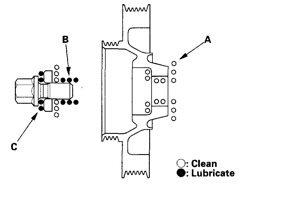

Pic 20
29. Clean all oil off the inside face (A) of the crankshaft pulley, and apply lubricant to the pulley bolt (B) and washer (C).
Pic 21
30. Install the crankshaft pulley, and hold with holder handle (a) and holder attachment (B).
31. Tighten the bolt to 245 Nm (250 kgf-m, 181 ft. Lbs.) With a torque wrench and 19 mm socket (c). Do not use an impact wrench.
Pic 22
32. Install the dipstick and tube (A) with a new O-ring (B).
Pic 23

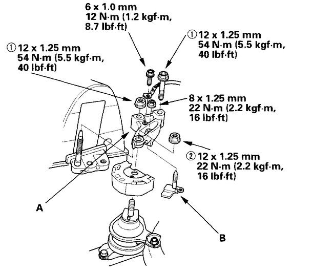

40. Install the upper bracket (A), then tighten the bolt and nuts in the numbered sequence shown.
41. Install the stop (B).

Stacy, I just sent all the info to you. If you look at pics 16 and 17, they show where the timing marks should be. I hope I didn't overwhelm you with the info. I just wanted to give you everything.
Are the marks on the crank and cam the same as the pic?
If you are worried they may be off, get them to where you feel they are right and then turn the engine by hand (breaker bar on crank bolt) to make sure it turns smoothly and nothing stops it from turning.
Let me know. Also, let me know if you have other questions.

Okay, got marks set on crank an cam pulley, but i'm having issues trying to line up the cam bolt holes on top. They're off about a 1/16 maybe. I removed the top with rocker arms so I could get timing belt back on.
Tuesday, September 1st, 2020 AT 9:04 AM
  • 110,194 POSTS
If you are unable to align the bolts for the cam sprocket, then the camshaft must need turned a bit. Have you tried that?

I gave up put the old head back on. Now i'm trying to get balancer off with small air compressor with no luck yet.
So can get in time but cant get belt on unless remove plastic cover to get to belt tensioner to release still I can hey belt over cam pulley.
Tuesday, September 1st, 2020 AT 8:03 PM
  • 110,194 POSTS
I'm not sure I understand. What are you trying to do?
Tuesday, September 1st, 2020 AT 8:14 PM
STACY ZIMMERMAN
  • 26 POSTS

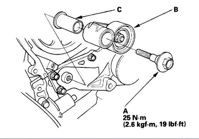

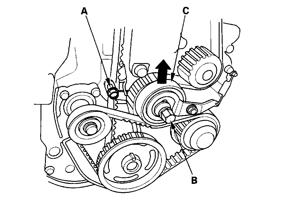

Need to access the timing belt tensioner so I can get some slack to put timing belt back on. From what videos I have seen that's how I have to do it.
The balancer on outside has marks an I can find top dead center just can't get belt on. Doubt my impact will get it off so not sure what to do keep hitting it with my impact an maybe can get itr loose, idk.
Wednesday, September 2nd, 2020 AT 4:47 AM
  • 110,194 POSTS
Stacy,
Take a look at the attached pic. Is that what you are working with?
Wednesday, September 2nd, 2020 AT 6:32 PM
