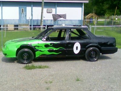

I have a 1987 honda accord 2.0 it is a dirt track car i am changing the head its a complete head off of another motor that has been ported and polished with a larger cam it is suppose to be a stock class i have a few" illegal" parts on it now but any tips on performance and maken installation of the head easier woul greatlly be appreciated
http://www.2carpros.com/forum/automotive_pictures/318925_my_racecar_1.jpg

Those motors are gutless unless you do some serious work.
In my opinion, since you are changing the head you NEED to get it tuned by a professional honda tuner. You should convert to OBD1, meaning you will need a conversion harness and ECU and software to tune on such as neptune, ECTUNE, crome, hondata, etc.
