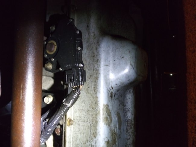

There is that pic of the plug that's not connected.
Thursday, July 30th, 2020 AT 7:58 AM
JAMESBURROW
  • 46 POSTS
Sorry wrong pic. But I was wondering what that was it's on my transmission and it has oil all over the plug wire I was wondering if maybe that caused it to go out.
Thursday, July 30th, 2020 AT 7:59 AM

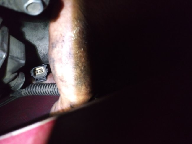

Here's the pic of the plug:

Where is that connector located and what colors are the wires?
Thursday, July 30th, 2020 AT 8:04 AM
JAMESBURROW
  • 46 POSTS
I figured out where the plug went; it's one of my knock sensors. I changed the idle control valve and now my truck runs a lot better, it's still missing in cylinder 3 and when I take off I can feel it kind of jerking a little. Like something is working and then not working, but if I hold the gas pedal in a certain spot then it is okay.
