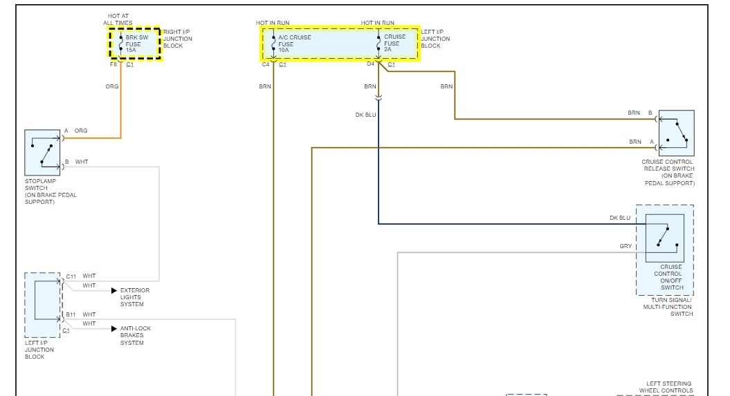

Try to use cruise control and I can't get it to work. Checked fuses and none are bad.
Tuesday, April 21st, 2020 AT 7:54 PM
MECHANIC
52,796 POSTS
Good morning,

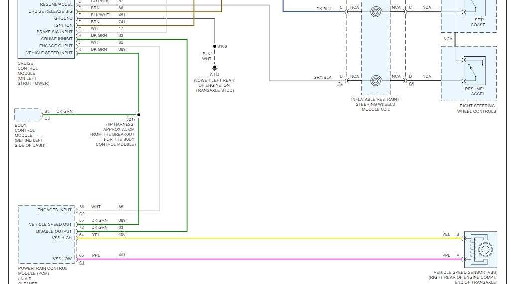

Is the ABS light on in your car? If it is, it will disable the cruise system as it uses the signal from the sensors to control the cruise.
I attached a wiring diagram for you to view. Can you get a test light or voltmeter to do some testing?
