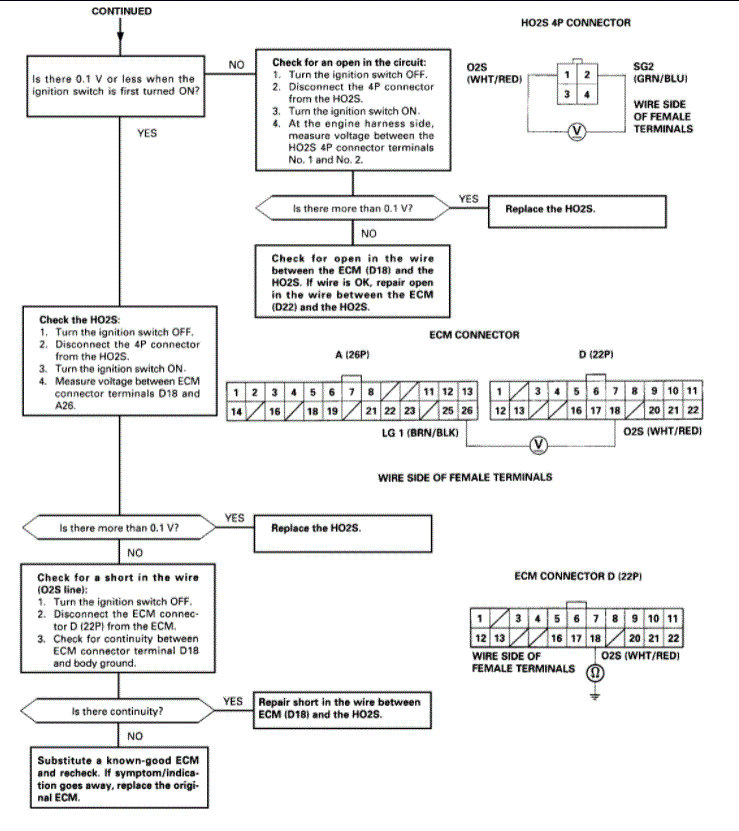

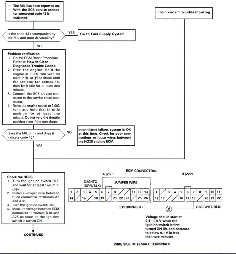

My ABS and SRS lights stay on. The only code I get is 44 fuel supply system. I had to replace the speed sensor because the other one was melted melted. I put in new spark plugs and wires I also have a new Ignition coil and distributor cap coming. I had to piece the return fuel line (rubber one) because squirrels chewed through it. I also have to replace the catalytic converter because it rusted off. The car probably has over 250,000 miles on it but I'm not sure how long the speed sensor was melted before I got it. Any advice is appreciated.

Oops code 43 not 44.
Monday, September 20th, 2021 AT 3:15 PM
  • 110,192 POSTS
The 43 is related to either the heated O2 sensor or a fuel-related issue. If you look below, I attached diagnostics specific to this code. Take a look through them and let me know if you are comfortable performing them.

What is the MIL referenced in the first diagram?
Monday, September 20th, 2021 AT 6:35 PM
  • 110,192 POSTS
MIL stands for malfunction indicator lamp. Basically, the check engine light.

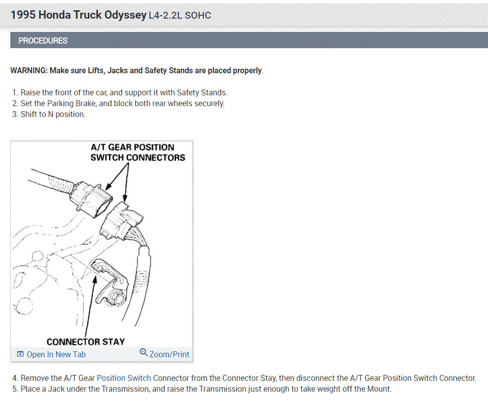

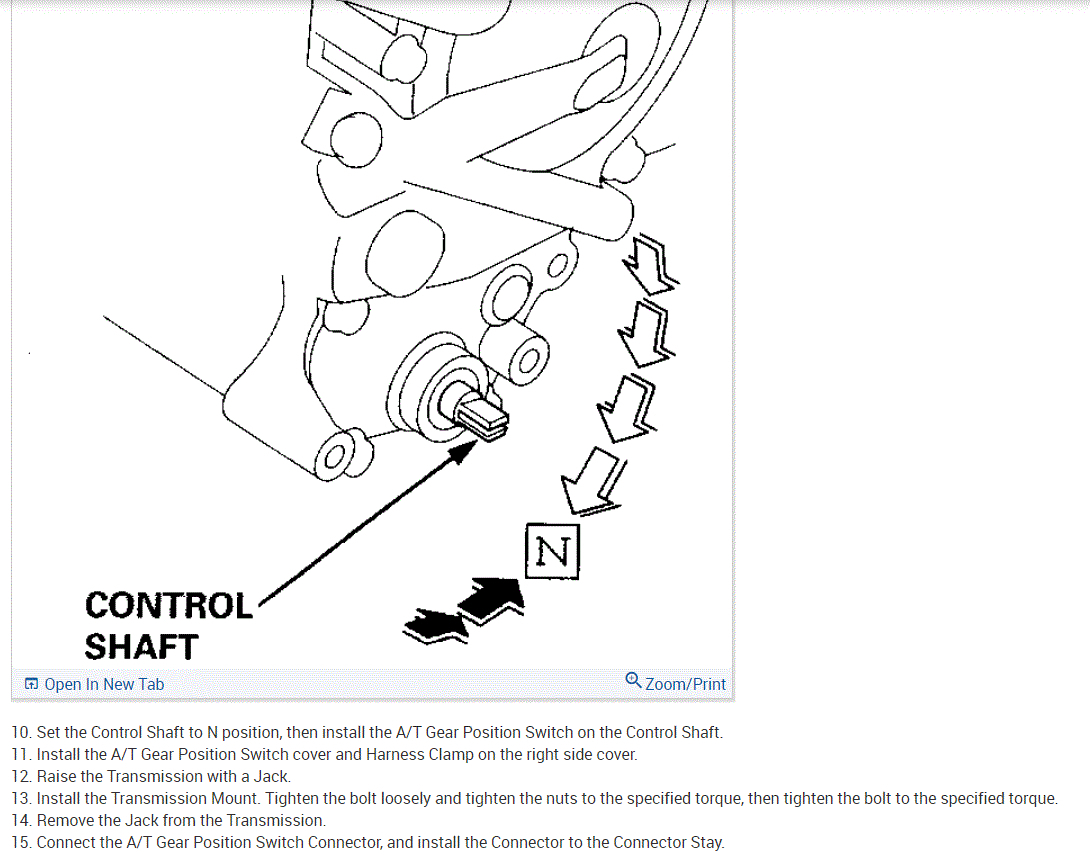

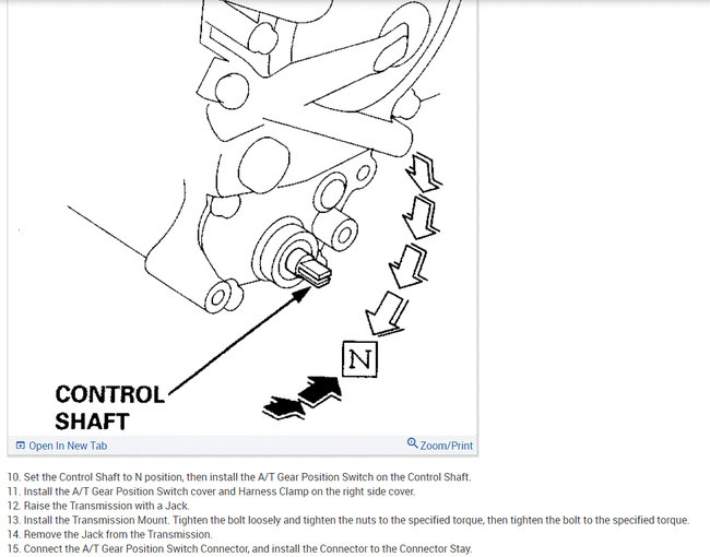

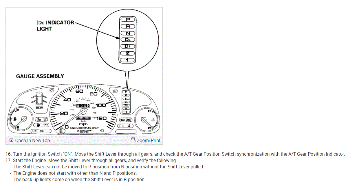

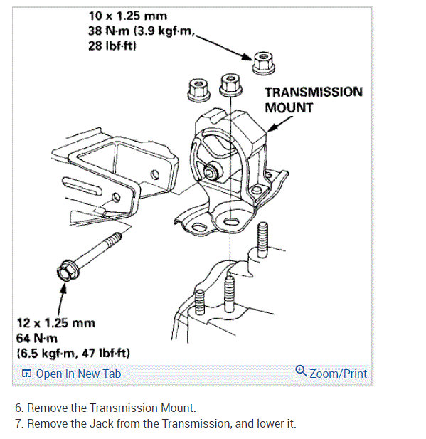

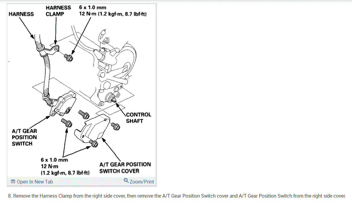

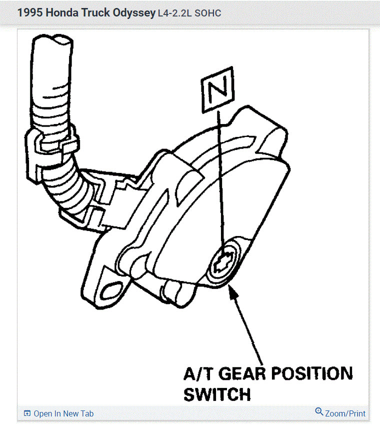

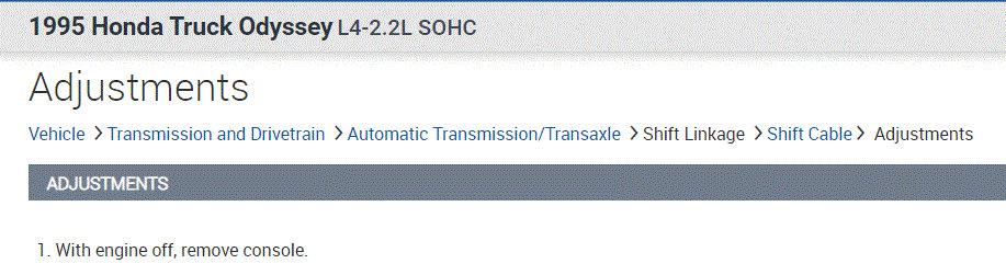

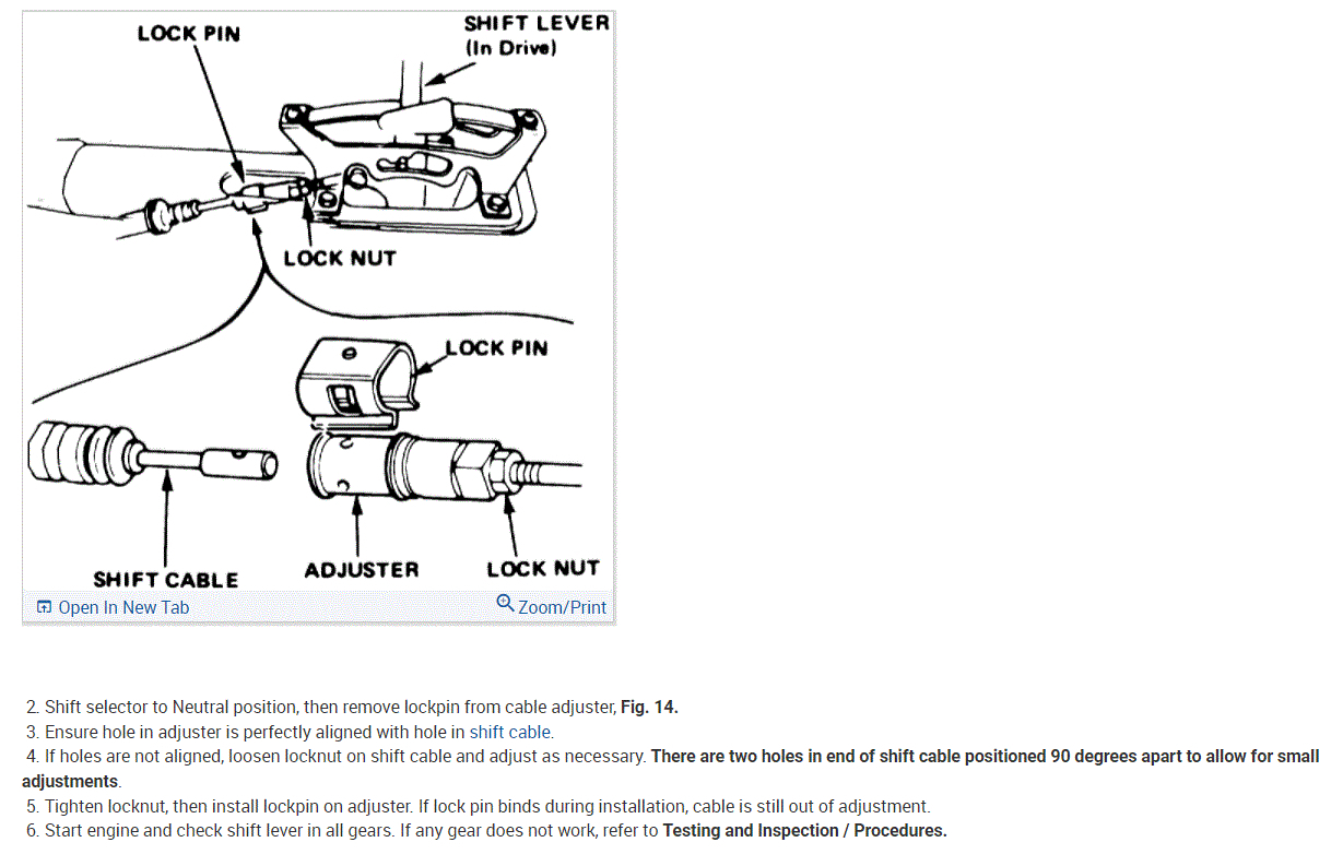

Is the transmission range switch also called the neutral safety switch? I know mine is out of whack because if I jiggle the is fijiggle the gear selector in the car in the car the cruise control works in 4th.
Friday, September 24th, 2021 AT 12:39 PM
  • 110,192 POSTS
Yes, they are one and the same. The neutral/park safety and range sensor are one thing.
Now, if you look below, I attached the directions for replacing the switch. I want you to keep in mind, however, the shift cable can be loose or out of adjustment.
There is an adjuster behind the console that you may want to check first. The last two pics I attached are for adjusting the shift cable.
