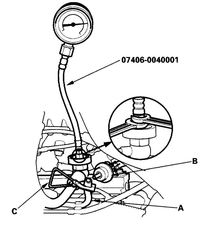

I have replaced the fuel pump fuel relay switch, distributor cap and rotor button. It started for a moment with starter fluid but not on its own.
Is there a fuel cut off switch I need to find or any suggestions?

There isn't a fuel shut off. Can you hear the pump run? Have you confirmed fuel pressure?
First, I would check fuel pressure to confirm the pump is working. It could be working and not producing. Here is a quick link that shows how to check:
Here are the specific directions including specs:
Fuel Pressure Test
Special Tools Required
- Fuel pressure gauge 07406-0040001
- Fuel pressure gauge attachment 07VAJ-0040100
1. Relieve the fuel pressure.
See picture 1

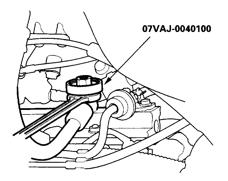

2. Use a wrench to remove the fuel pulsation damper from its fitting, then attach the fuel pressure gauge attachment.
See picture 2
3. Attach the fuel pressure gauge.
4. Disconnect the vacuum hose (A) from the fuel pressure regulator (B) and pinch it closed with a clamp (C).

6. Check to see if the fuel pump is running: Remove the fuel fill cap and listen to the fuel fill Port while an assistant turns the ignition switch ON (II). You should hear the pump run for about 2 seconds when the ignition is turned ON (II).
- If the fuel pump runs, go to step 7.
- If the fuel pump does not run, test it.
7. Read the pressure gauge (with the fuel pressure regulator vacuum hose disconnected and clamped). The pressure should be 320 - 370 kPa (3.3 - 3.8 kgf/sq.cm, 47 - 54 psi).
- If the pressure is OK and engine is running, go to step 8. If the engine is not running, repair the cause, then continue this test.
- If the pressure is out of spec, go to step 9.
8. With the engine running, unpinch and reconnect the vacuum hose, and read the gauge again. The pressure should be 260 - 310 kPa (2.7 - 3.2 kgf/sq.cm, 38 - 46 psi).
- If the fuel pressure is OK, the test is complete.
9. Disconnect the vacuum hose from the pressure regulator again while you watch the pressure gauge. The pressure should rise when you disconnect the hose.
- If the pressure did not rise, replace the fuel pressure regulator.
- If the pressure rose, but all your readings were lower than specified, check for a clogged fuel filter and for leaks in the fuel lines.
- If the pressure rose, but all your readings were higher than specified, check for a pinched or clogged fuel return hose or line.
10. Reconnect the vacuum hose, remove the pressure gauge, and reinstall the fuel pulsation damper with a new washer. Tighten the fuel pulsation damper to 22 N.m (2.2 kgf.m, 16 lbf.ft).
NOTE: Disassemble and clean the fuel pressure gauge attachment thoroughly after use.
