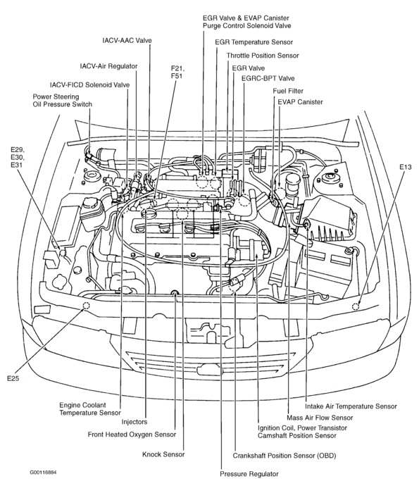

Where is the crank shaft censor? And how do you change it
Saturday, December 26th, 2020 AT 10:27 AM (Merged)
  • 75,992 POSTS
The CPS is on right rear side of cylinder block

Where is the crankshaft positioning sensor and how do I go about replacing it?
Saturday, December 26th, 2020 AT 10:28 AM (Merged)
  • 75,992 POSTS
See location below:
https://www.2carpros.com/forum/automotive_pictures/12900_ckp_2.jpg

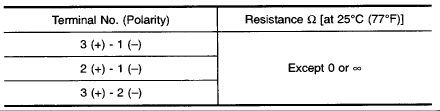

Testing and Inspection
Component Inspection
https://www.2carpros.com/forum/automotive_pictures/12900_c1_9.gif
https://www.2carpros.com/forum/automotive_pictures/12900_c2_8.gif
Disconnect crankshaft position sensor (POS) harness connector.
Loosen the fixing bolt of the sensor.
Remove the sensor.
Visually check the sensor for chipping.
https://www.2carpros.com/forum/automotive_pictures/12900_c3_6.gif
Check resistance as shown in the figure. If NG, replace crankshaft position sensor (POS).

Where is crank position sensor and what tools do I need to replace it
IMPALASS
  • 3,112 POSTS
Located on lower left front of engine. It may be held in by a 10mm bolt. However, depending on clearance you may need a wrench. So this will have to be determined once you are looking at it.
