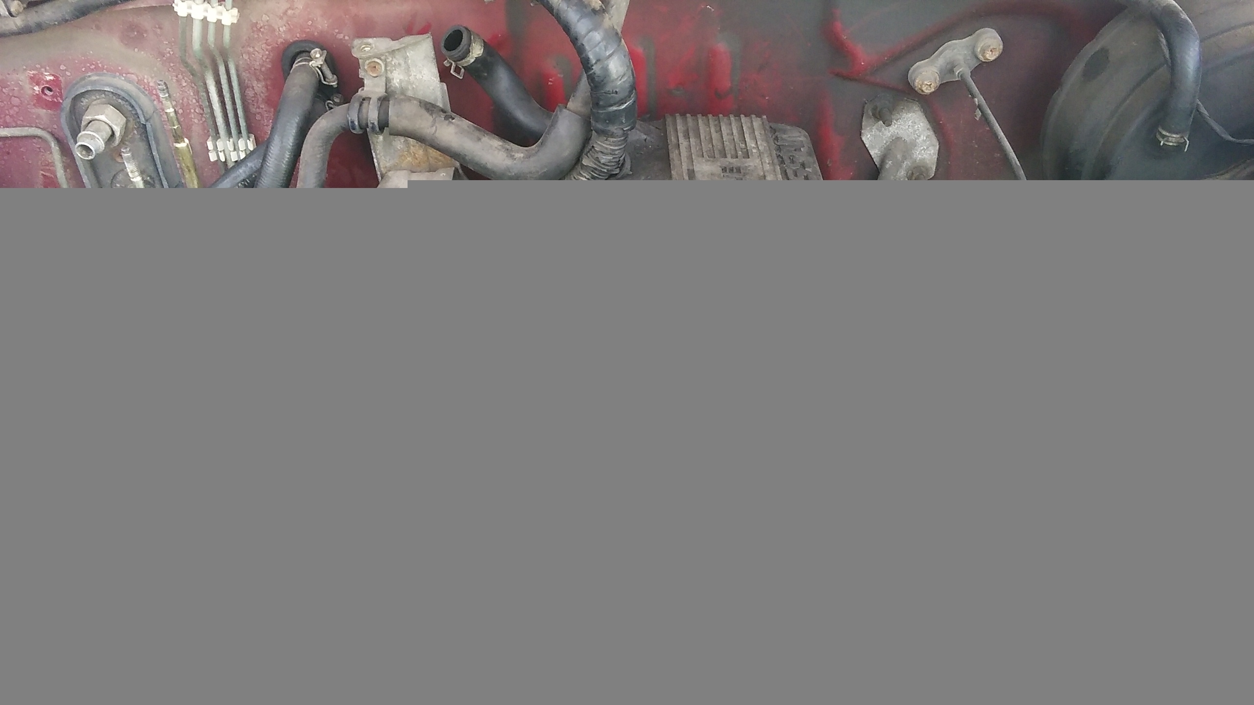

Replaced oil pump. Wont start now didnt do anything else. I checked the timing. Spark. Fuel. Compression. All checked out fine truvk ran great when parked. Only took a week to get the pump so I had the battery out for the week it was on trickle charge till I replaced the pump then now it just cranks but wont start. Any ideas anyone?

Well just went out to try an start it with a little starter fluid its poping out of throttle body. I dont know but if its doin that im thinkin bent valve or valves not closing all the way

HMAC300
  • 48,601 POSTS
Checkfor a valve problem like bent pushrod if pushrod engine or follower fell off if overhead cam
Monday, January 25th, 2016 AT 8:39 AM

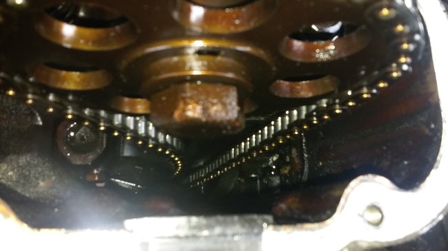

Here is what I see

It's not a complete pic but looks like overhead cam. Check compression on all cylinders.

There is alot of play in this chain I believe a tentener has broke on rite side

If there is a lot of slop in it I imagine so. Hopefully it didn't damage anything in motor. That is an interference motor so check for bent valves.

Ill seeif I can do a pic
