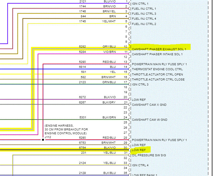

The codes you provided indicate there is a short to power at the exhaust cam actuator. Disconnect it and check for a 5v reference to it. Let me know what you find.

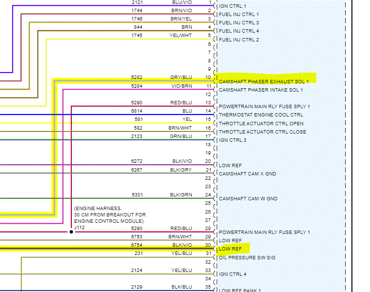

At the actuator, there should be a gray wire with a blue tracer and a black wire with a violet tracer. The gray/blue should have the 5v reference. The black/violet is a low reference wire which is basically a ground provided via the PCM.
Take a look below at the pic.
See pic below.
Sunday, June 12th, 2022 AT 8:10 PM

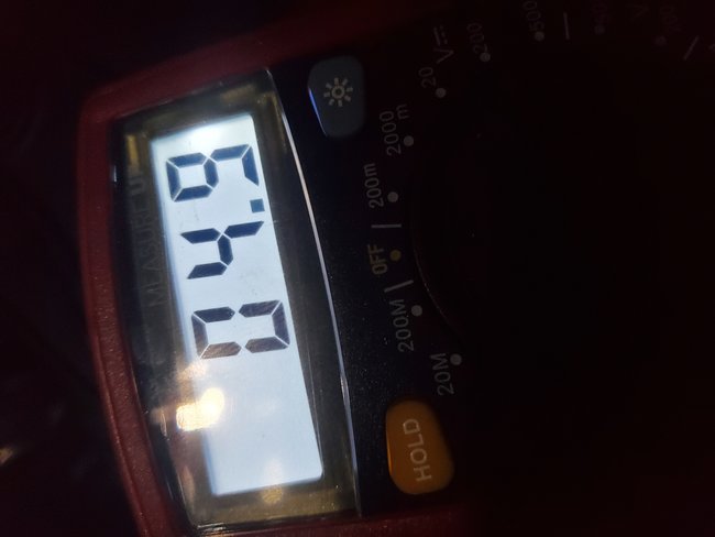

This is voltage to the hot wire on both camshaft actuator solenoids intake side and exhaust side which is 11.2.

This is voltage to one of the 3 wire plugs on both camshaft sensors intake side and exhaust side which is 4.9 volts.

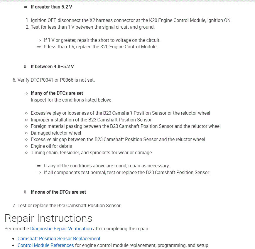

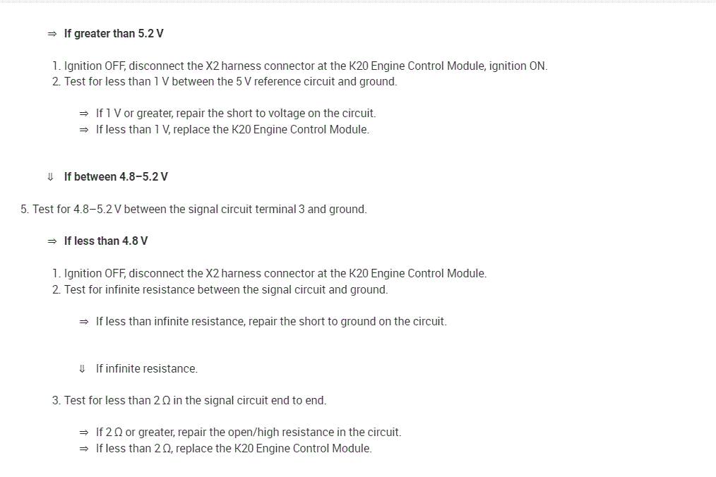

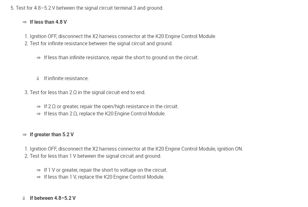

You are basically getting battery voltage to the sensors. That's the problem. You asked the probability of it being a computer. I don't like saying it, but the chances are higher than I would like. However, it could simply be a short.

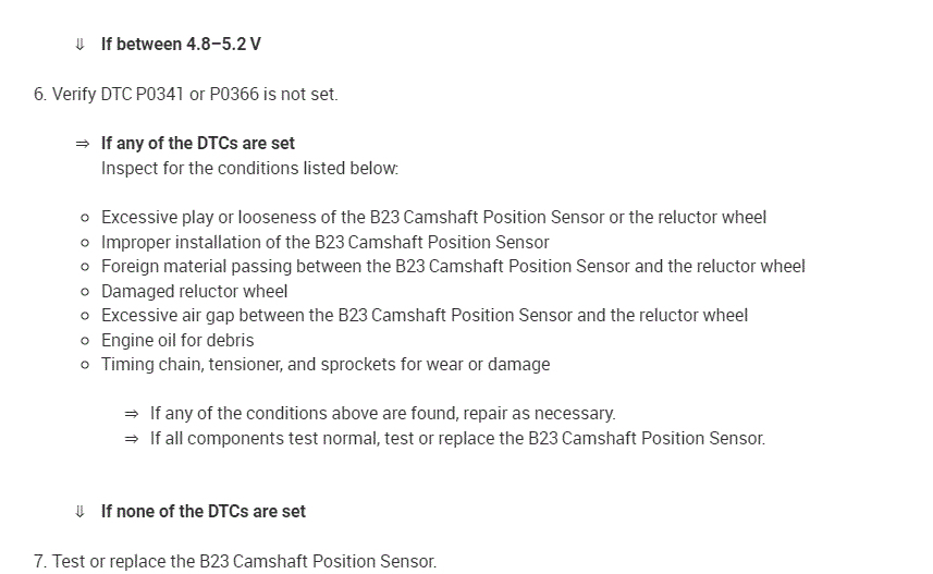

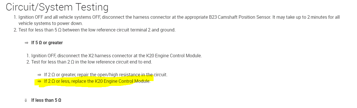

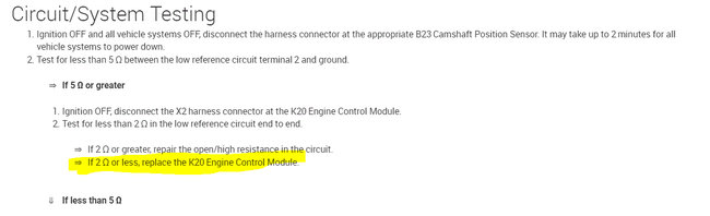

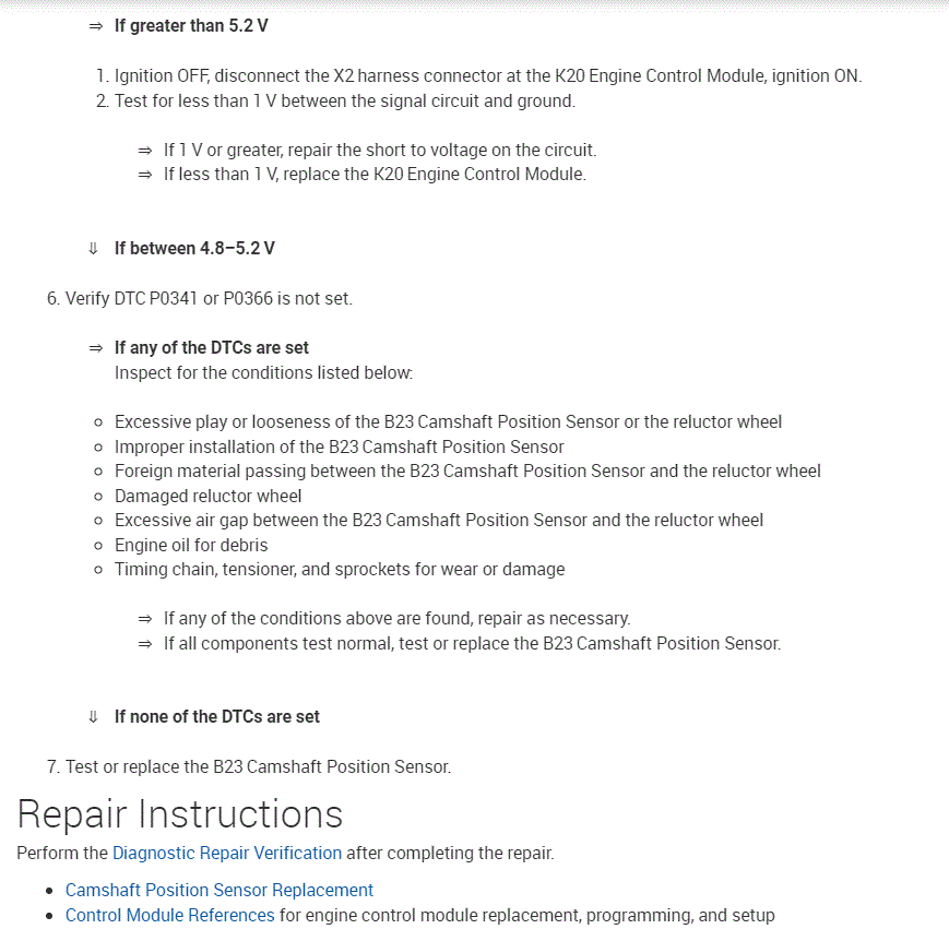

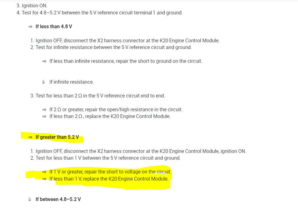

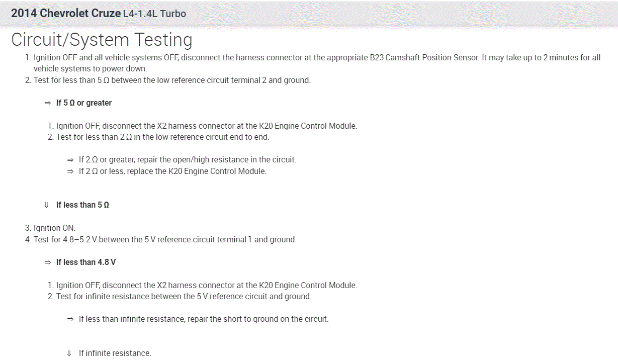

I attached diagnostics to further your testing below. They are broken into steps. You have already completed some of the preliminary tests. Read through them and see what you find. After I read through them, I feel you either have a short to B+ on the 5v reference or the ECM is bad.
If you look down to step 4 of the diagnostics, you have already verified there is too much voltage, so the directions are indicating to disconnect the ECM and start checking at the ECM K20 module. In section 4, go down to where it indicates more than 5.2V and continue from there.
Remember, The ECM can supply 5v or 12v to various sensors. This is done through a pull-up resistor to regulate the power supplies within the ECM. If you get B+ voltage to the 5v signal wire right at the PCM, the resistor has failed.
Take a look through the diagnostics below and let me know if you have questions.

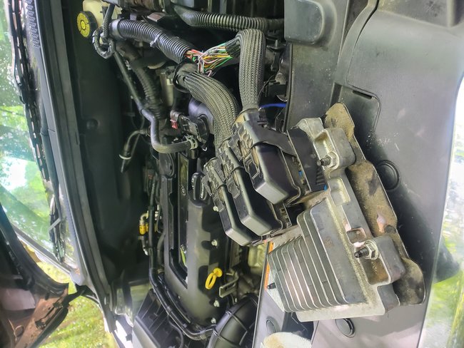

I'm getting battery voltage at solenoid actuators intake exhaust side and no volts at ECM wiring of either of the four wires running out ECM plug to solenoids.

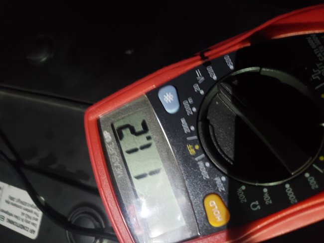

I've test the wires hooked up to ECM with key on and off also checked wires unhooked from ECM with key on and off no voltage at ECM, but has the battery's voltage at solenoid actuators even now that my battery is down to like 8.3 volts since car not running and me not putting charger on it. It reads the 8.3 volts at solenoids when it was reading 11 something volts at solenoids before when battery had the more volts. This this car has me so messed up.

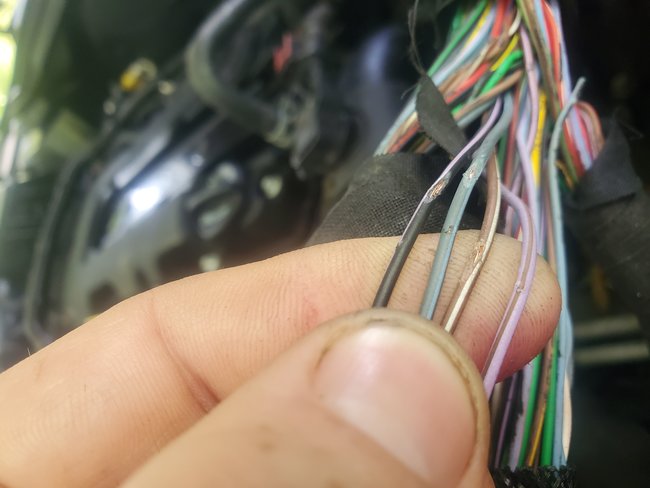

Are you getting power from the ECM? You indicated you don't. But, when you connect the ECM, do you have B+ voltage to the solenoids? I ask because that doesn't make sense to me unless there is a short to power in the ECM wiring harness. Also, if you are getting no voltage right at the ECM, chances are it has failed, and needs replaced.

At the black connector on ECM with key on I'm not getting any voltage at the wires but at the connectors of the solenoid actuators I'm getting battery voltage whatever's in my battery. There's a blue black and gray connected on the ECM the wires I traced back from the actuator's go to the black one.

If you are getting nothing at the ECM, I suspect it's bad. As far as the power at the actuator, B+, I suspect you are getting power from the ECM through the wrong wire, or when you connect the ECM, there is a pin that is shorting power to it. Otherwise, nothing would make sense. If you traced the wires back to the ECM and there was nothing damaged or shorting, that is what I suspect is happening. Something in the ECM has shorted. Even if there was a pin in the connector that was bad, that wouldn't explain why you don't have a 5v reference at the ECM.

Okay, I went back over everything I'm getting battery voltage out of ECM on both 5v reference wires I assume that assures me going to need new ECM and it flashed to my VIN.
Thursday, June 23rd, 2022 AT 5:21 PM
  • 110,192 POSTS
It sounds like something shorted internally. I suspect you are correct. Here is what I suggest.
