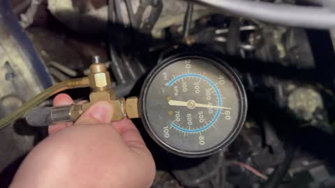

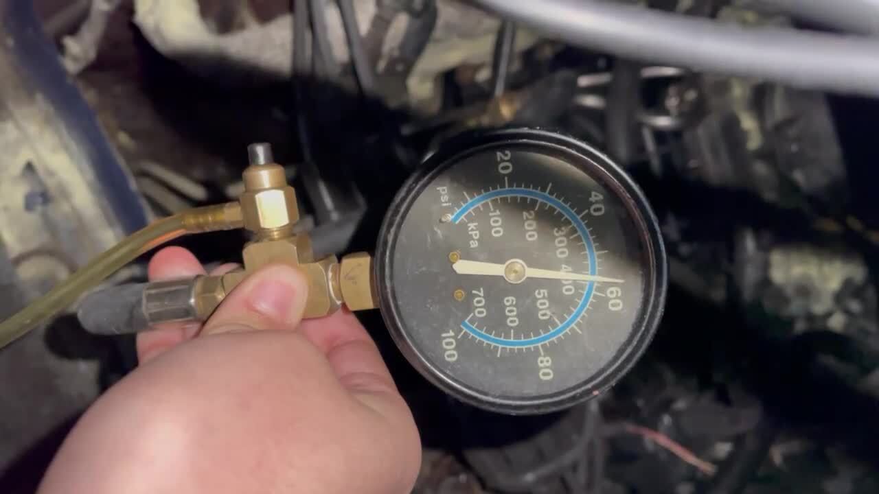

Check fuel pressure key open says 60 PSI and holds.

Can it be the fuel pressure? I can't find what fuel pressure the MFI spider upgrade should be at, I've read conflicting specs on forums that call for 61-66 PSI, but someone had said that's for stock poppet valve spider system CFI. MFI needs less PSI to operate.

Thanks for the video, it helps. The fuel pressure should not jump down like that first of all, but can you remove the spark plugs to see what they look like please? Upload the images with your response. You may have a catalytic converter that is clogged up. If the plugs are black, we have found the problem, replace the spark plug with new. Also, when cranking try starting fluid again to see if the condition changes. Let me know. I will pass this on to Joe as well.

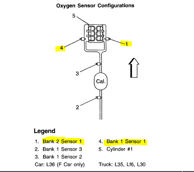

Ken let me know you were in touch. What he is suggesting is important. It could simply be the spark plugs are fouled. Let us know if they are wet/black in color. If they are, replace them. Also, you may want to remove one of the oxygen sensors before the catalytic converters. See pic 1 below for locations. If you have a plugged converter, this will allow an escape of exhaust. It may not run perfectly because there is still a restriction, but it will certainly make a difference if the problem is related to the converter.
I watched the video. I don't like how the fuel pressure gauge dropped when you first started cranking the engine. Does it do that every time? Also, is the metallic sound coming from the starter area?

The gauge does do that drop a lot when cranking.

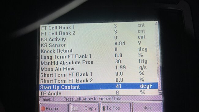

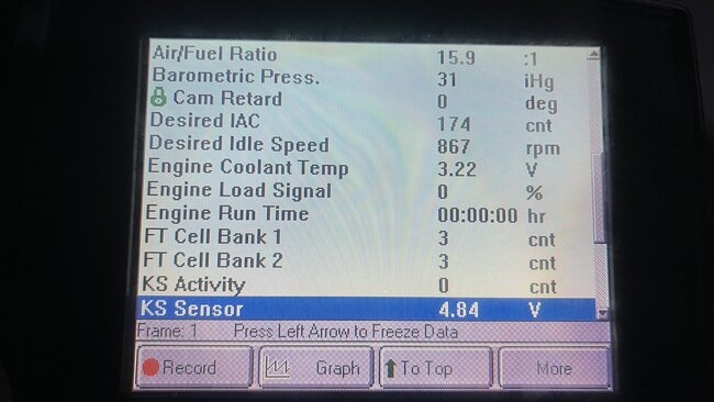

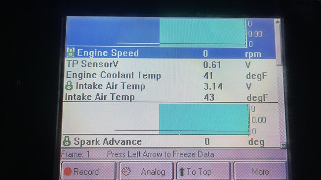

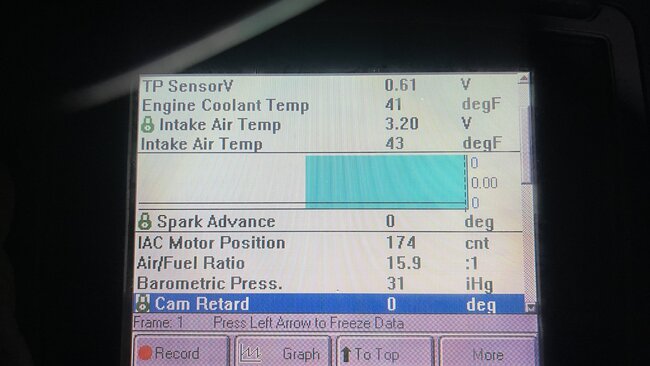

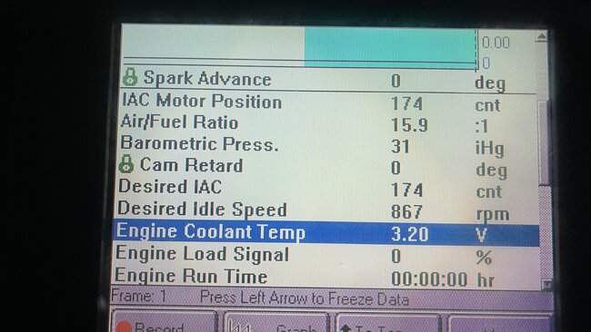

I do have another thought. If you have a live data scan tool, confirm the engine coolant temperature sensor signal seems accurate. I dealt with one of these that drove me crazy. The ECT was telling the PCM it was 40 degrees below 0 F. As a result, it was flooding the engine.

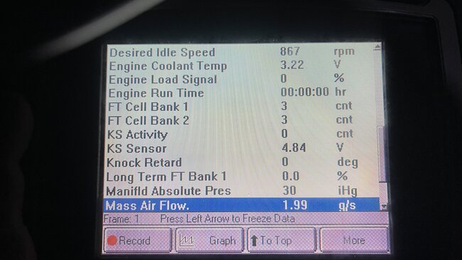

I will post some pics but the reading on the coolant temperature sensor seems normal as it matches the outdoor ambient temperature by a few degrees. I couldn’t crank it as it’s 3am and I don't want my neighbors bickering. Took screen shots of some info on the scanner. The weather screen shot was taken when I took the readings.

I looked through the pics and suspected the engine wasn't running at that time. As far as the catalytic converter is concerned, it's possible, but if it is that new, chances are that isn't the cause.

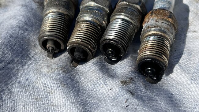

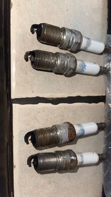

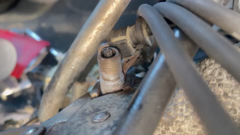

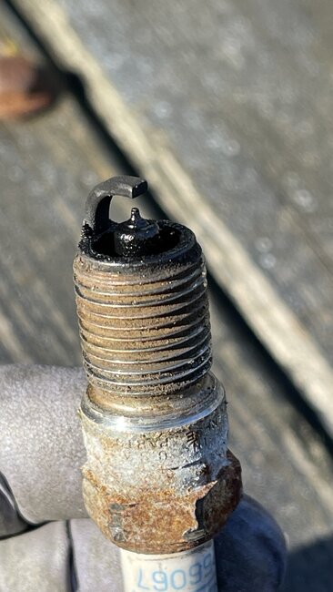

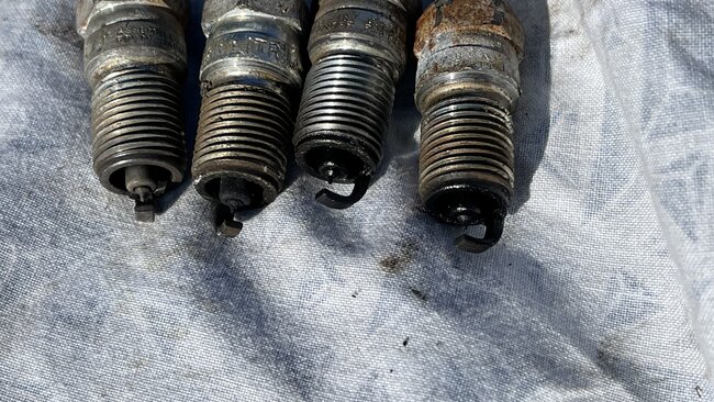

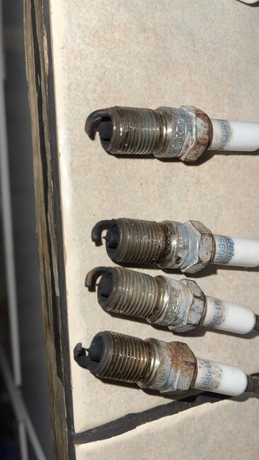

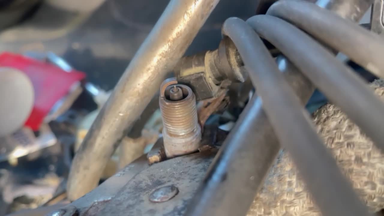

Hi fellas, hope you have a good morning. So, I got around to taking out four of the spark plugs on driver side, and they were all wet and fouled as in burning rich. My guess is that they were fouled up from so much cranking and no start I put in a brand-new distributor since I had it under warranty before I took out the plugs and still no start. The plugs were put in 2018 and they are iridium AC Delco, one thing that I did notice while cranking is that the spark is kind of weak. I have an extra coil, but it does the same weak, spark, or maybe I think it’s weak. Ignore the first spark plug on the left, I cleaned it up a little bit.
So brand new distributor, which comes with a brand-new cap and rotor and then I tested with a good known ignition coil and still no start. Cranking has been done with a battery charger on the engine, so that’s why it sounds so eager to crank. I ordered a fresh set of spark plugs and they get here on Wednesday.

I wanted to add that the plugs looks bad because back in May of this year the engine started smoking a lot of what appeared to be white smoke I was on my way to work and really thought the engine went bad. Turned out to be the O-ring for the MAP sensor went bad and wasn't reading. I never did change the plugs after that.

Looking at the plugs, they are a mess. LOL Let's see what happens with the new ones. Actually, the electrode seems to be missing on one of them.
Let us know how things turn out for you.

Yeah, that electrode I also thought was missing.

Hi again. I am in shock as my engine started today after installing the spark plugs. In all my life of tinkering with cars, I have never run into a situation like this. I am in shock. I know they were fouled up but what do you think happened or is it because the Vortech engine is so sensitive to spark being weak?
Wednesday, December 21st, 2022 AT 2:44 PM
  • 110,192 POSTS
No sir, that is common when the plugs get fouled. The one without the electrode certainly wasn't working. The others were simply in poor condition.
