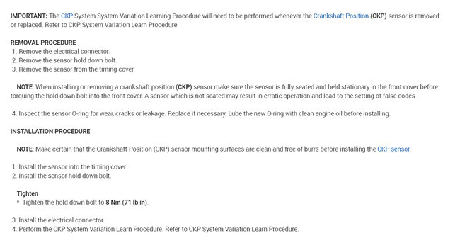

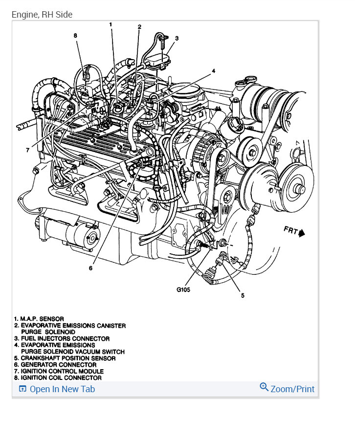

This sounds like a common problem when the crankshaft angle sensor goes out. here is a video of the job being done to help you fix the issue:

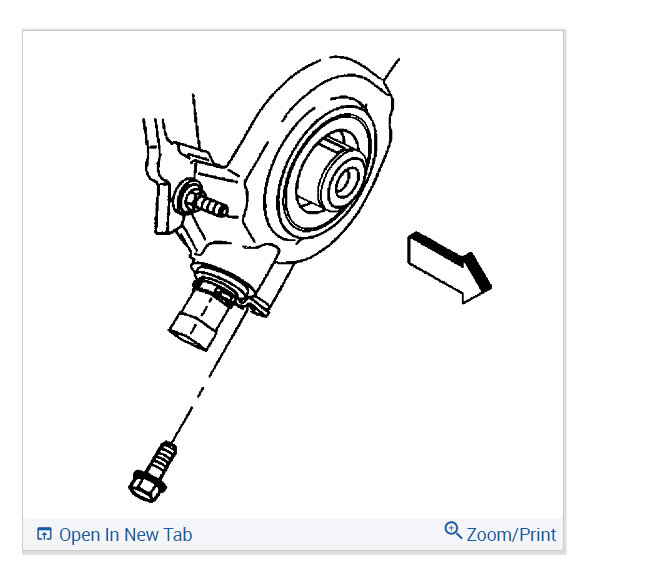

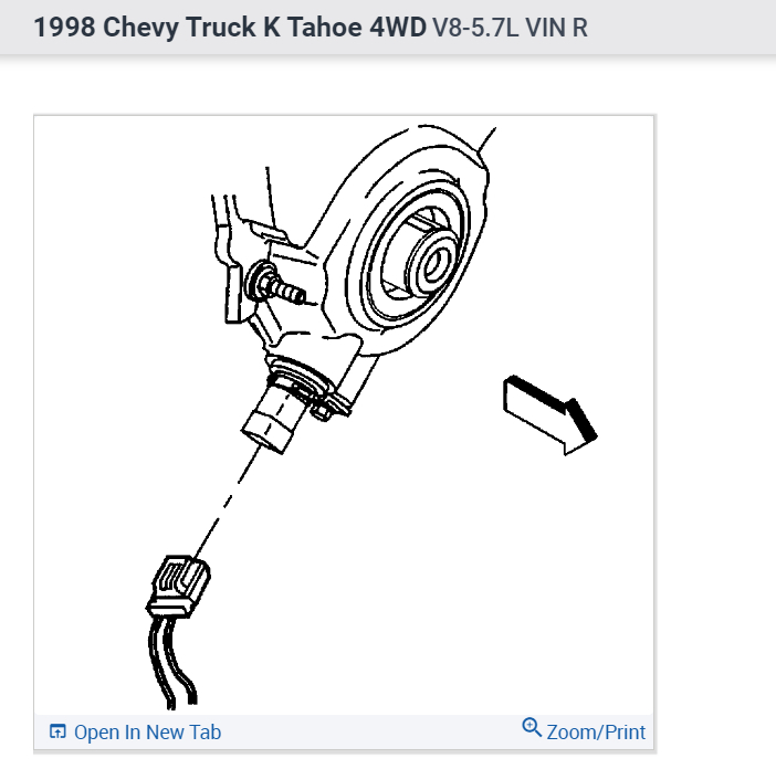

Okay, this was a split year here is the location of the sensor. Check out the images (below). Please let us know what happens.
+1

Good thought on crank sensor, soon as I can get on hoist going after clean grounds and I will replace sensor. Thanks

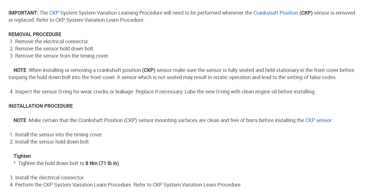

Here is the relearn procedure.
CRANKSHAFT POSITION (CKP) SYSTEM VARIATION LEARN PROCEDURE

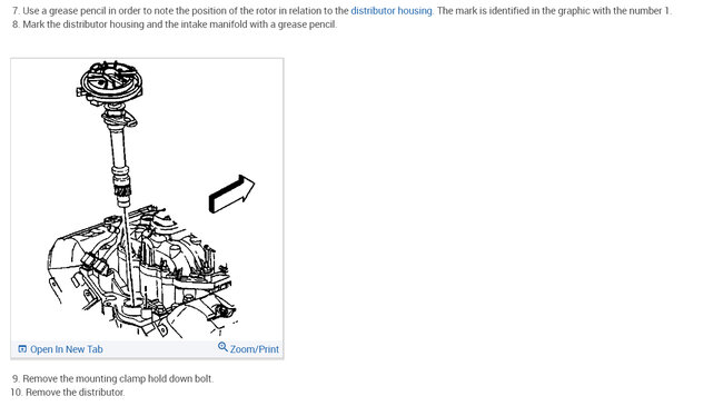

New crank sensor, cleaned engine grounds still don't start. Has 61lbs fuel pressure, spark at #1 cyl and#2 cyl that I checked and not erratic, tack pluses while cranking, watch ing voltage on scan tool has voltage with key on and during crank. Poured 1 ounce of gas in throttle body still dont even try to start( 40 degrees out). This problem was intermittent, when truck runs it runs good now it inop hasn't ran since in warmer garage last week. Got spark, compression, give it fuel source I am stumped. There are no converters on exhaust.

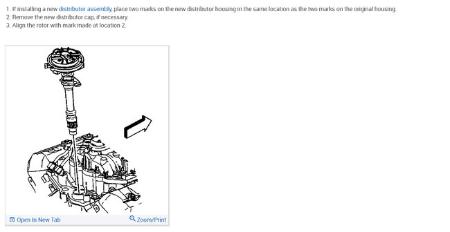

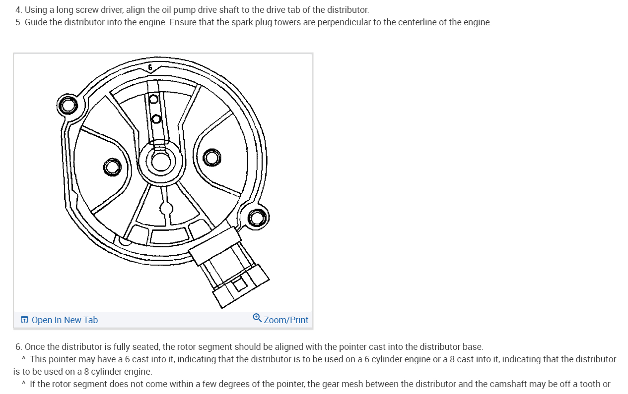

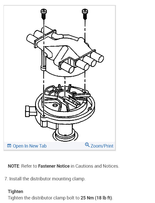

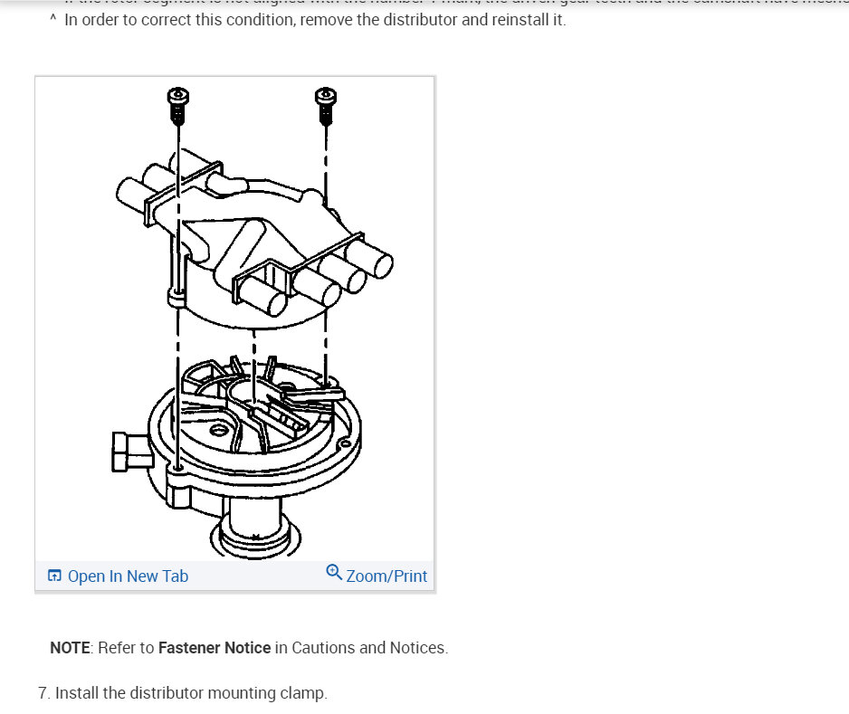

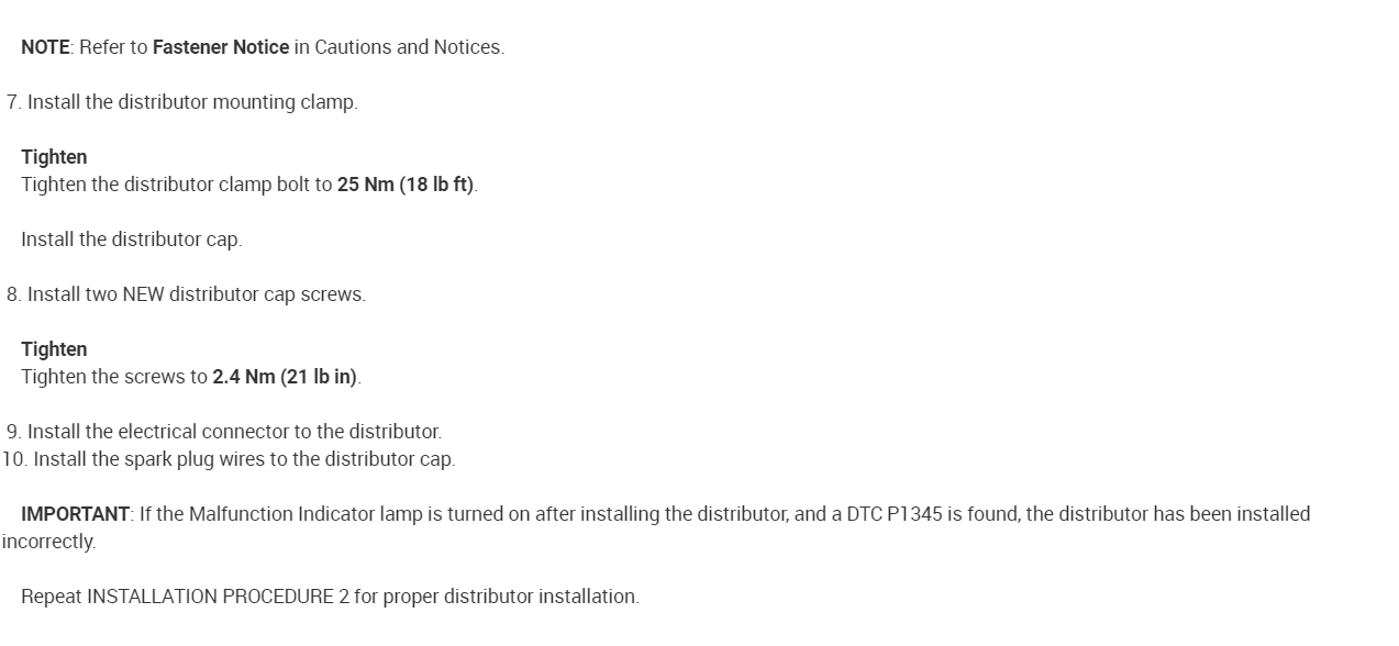

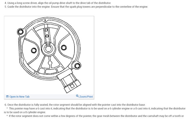

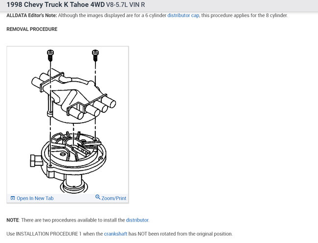

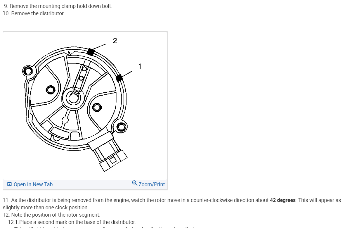

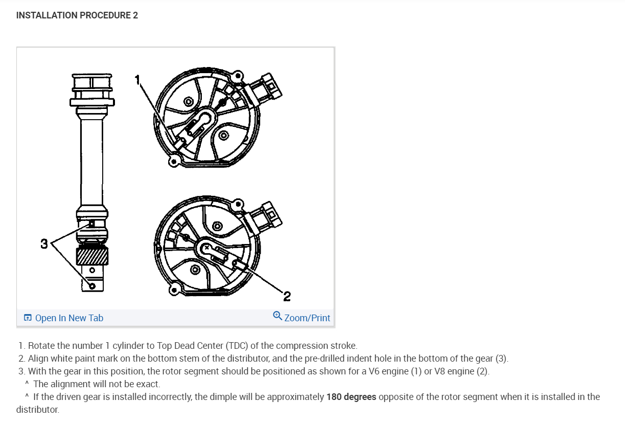

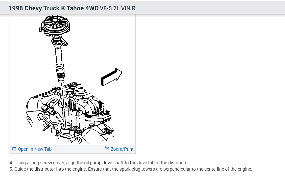

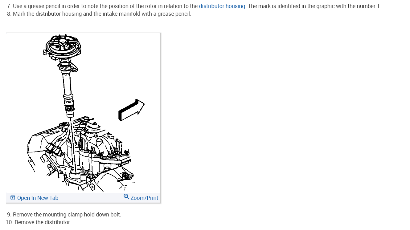

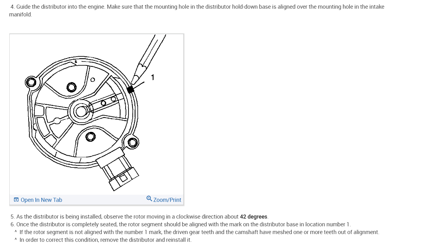

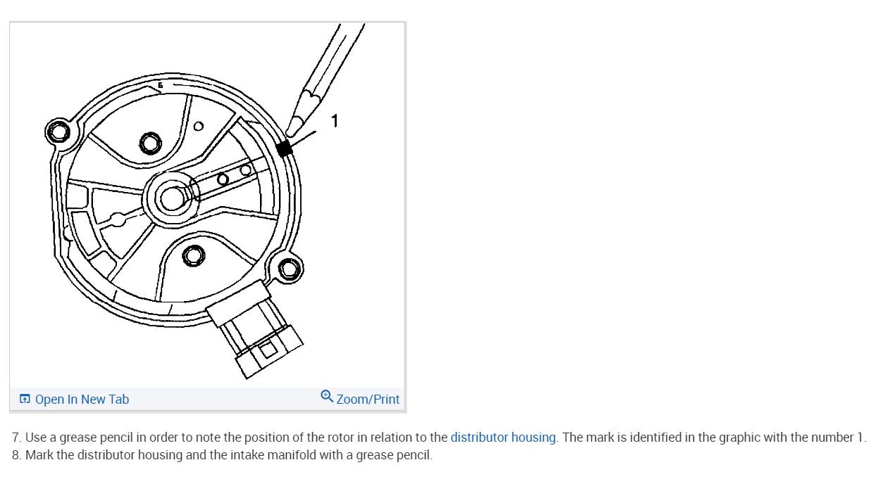

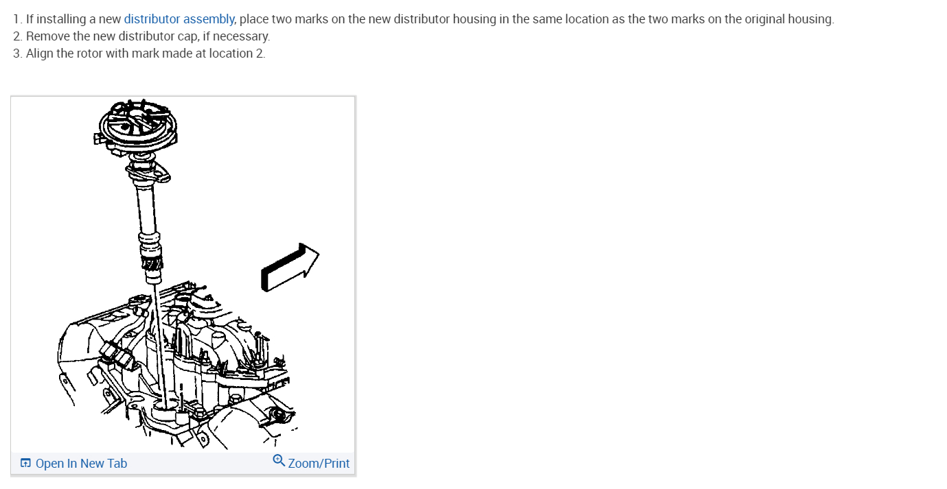

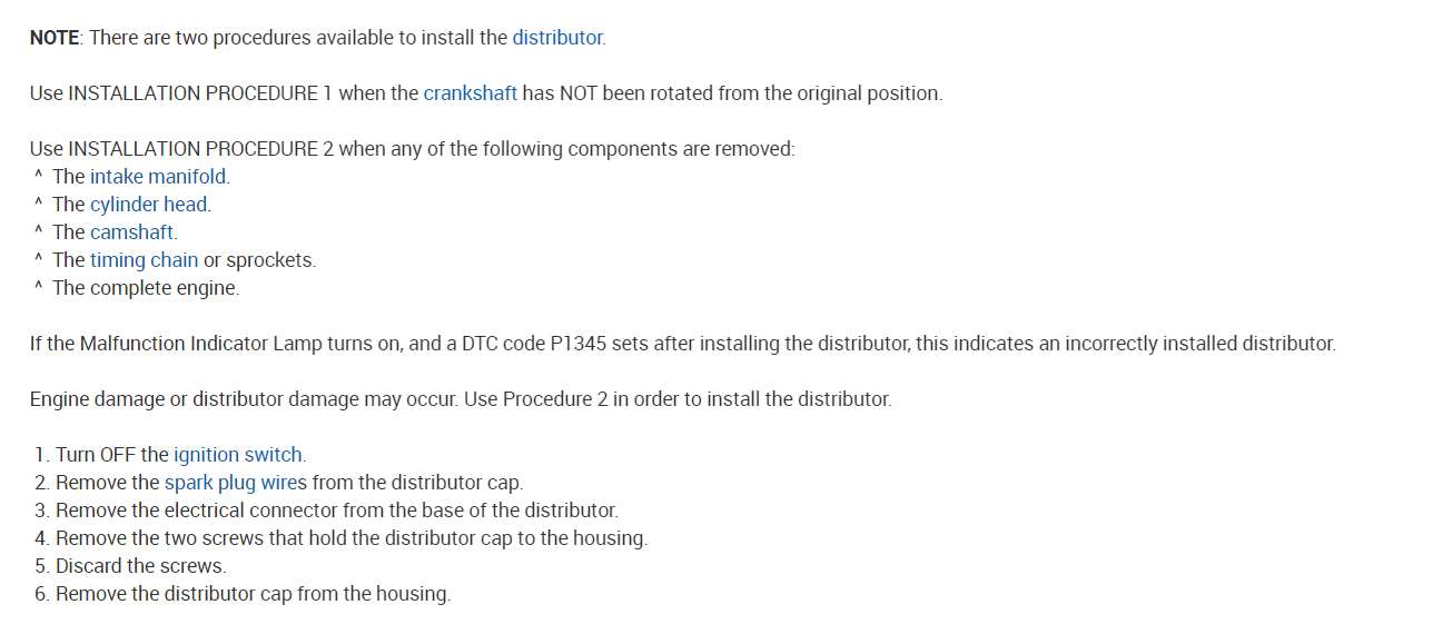

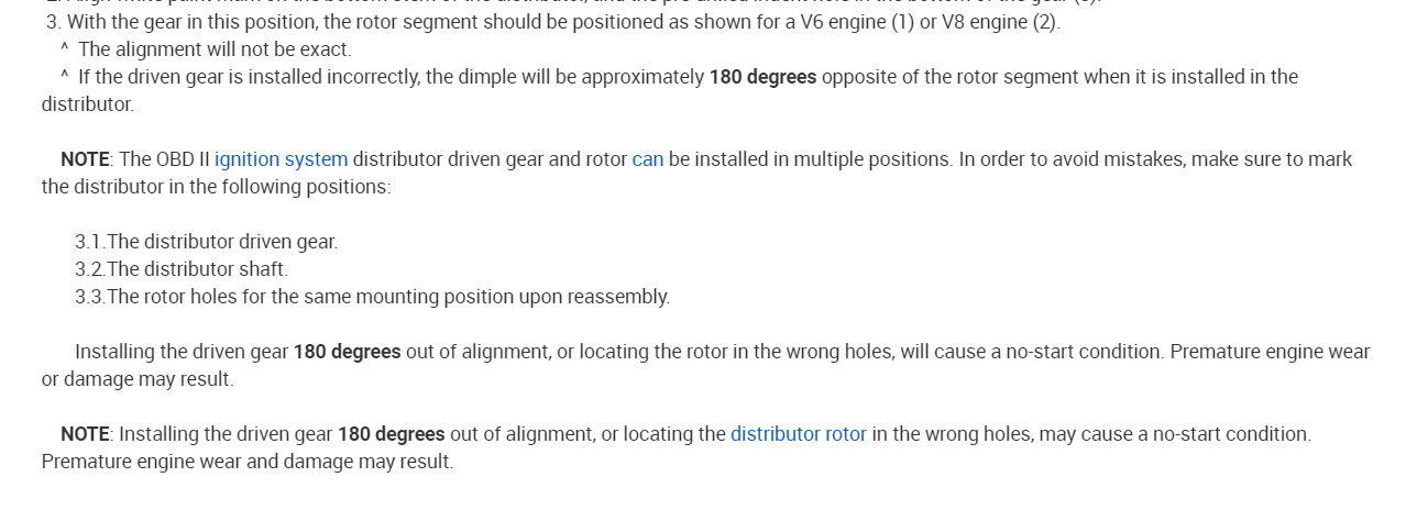

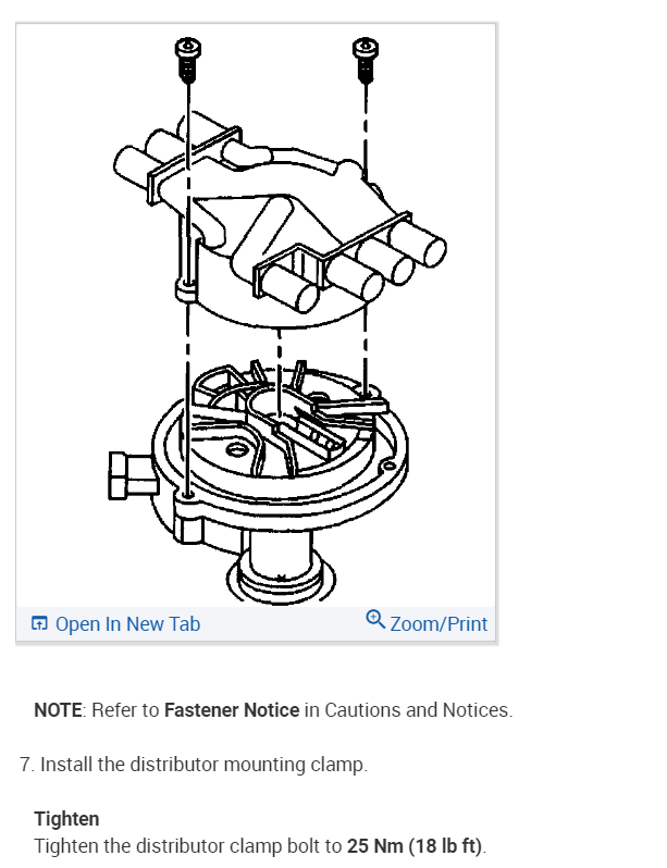

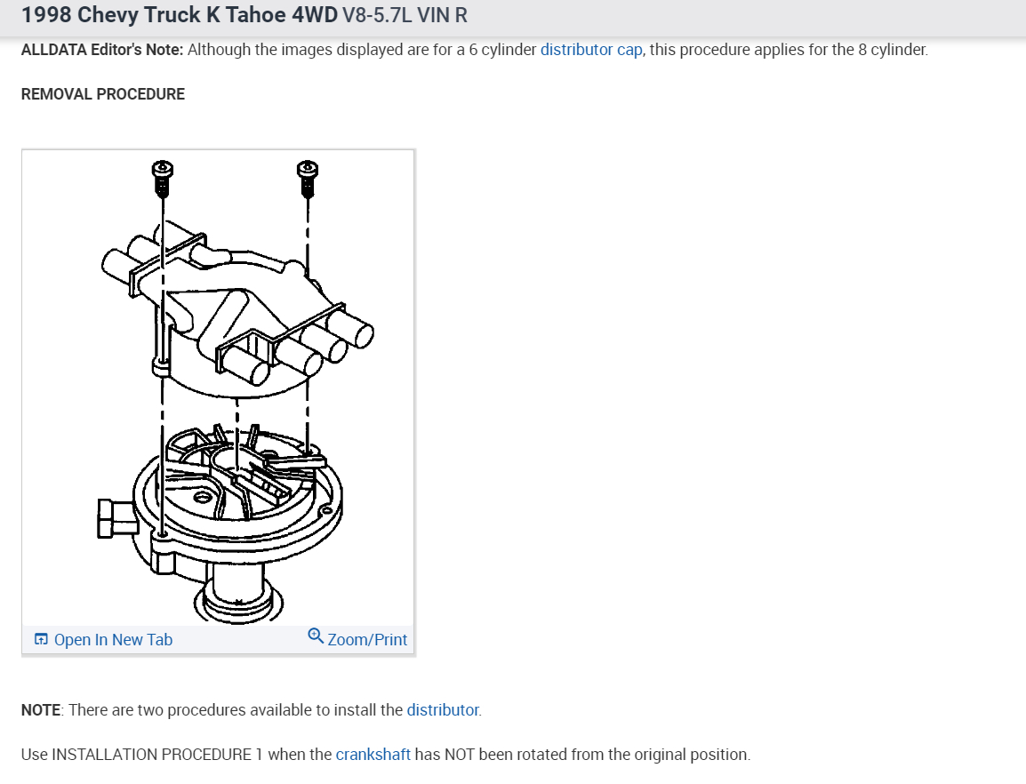

Let's remove the spark plug to see if they have soot on them (black), also do all of the spark plugs get spark? New cap and rotor? Plus, we should check the rotor position as well to make sure the distributor drive has not sheared which will cause the spark to be at the wrong time. Check out the images (below). Please let us know what happens.
+1

Well did nothing but pull the truck into heated building for 2 days while out of town, when I came home truck started right up runs and idles perfect. Took fuel sample off fuel gauge fitting, good gas. When thetruck was outside 30 degrees cranks no start, bring into 60 degree shop starts and runs perfect. 55lbs fuel at idle rap throttle jumps to 60. When outside looked at data sensons read appropriate values, no check engine light on, did not look at history codes.I got a mess here glad its my plow truck and we have no snow. Lee

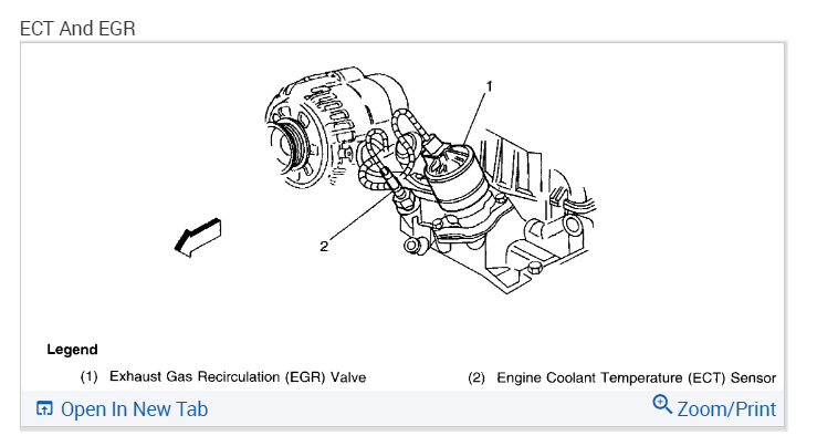

Ah! I have seen the engine coolant sensor short out in cold weather causing the engine not to start. Here is the sensor so you can unplug it to see if that makes a difference. Please go over this guide and report back.

Okay, here is the scoop: I contacted a friend that has a friend who's worked at a chevy dealer for 30 years. I told him that the truck will not start in cold, he asked if I had good spark, I told him had spark but don't know good or bad, he told me the coil is weak.I replaced coil now the truck starts fine in the cold, I must of over looked quality of spark, checked with spark plug tester.
