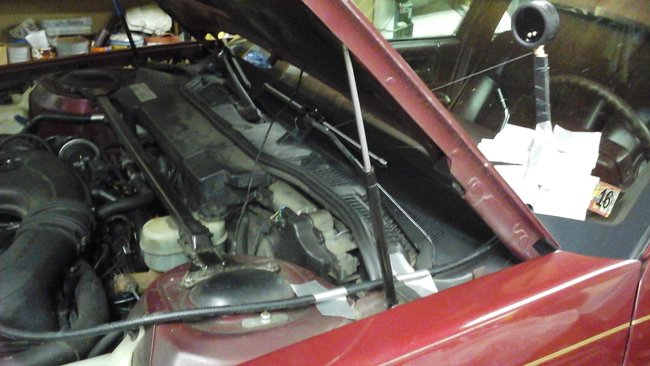

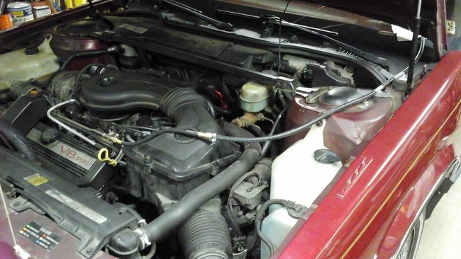

Set up the pressure gauge, and tried driving in the lot, but I can only get it to 15 or 16 mph, so I will have to take it on the road anyway, will post what happens, the gauge read 35psi whenI started it and stayed there for quite awhile after shut off.
