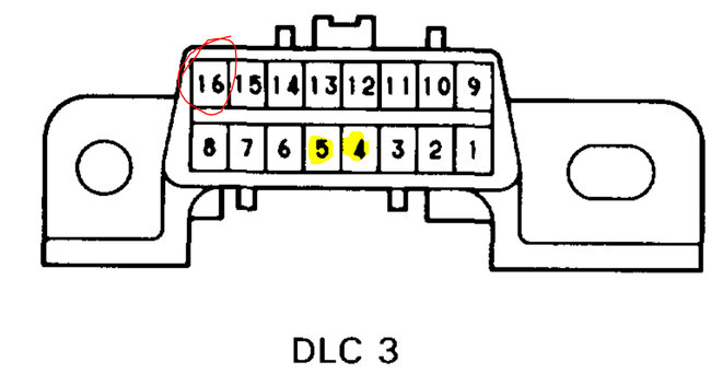

Not necessarily. When you say it won't stay running, explain what is happening. For example, does it start and then stall as soon as you allow the key to return to the run position? Or does it start for a while and then stall? Also, does the vehicle restart right away? Does the check engine light turn on when the key is first turned on?

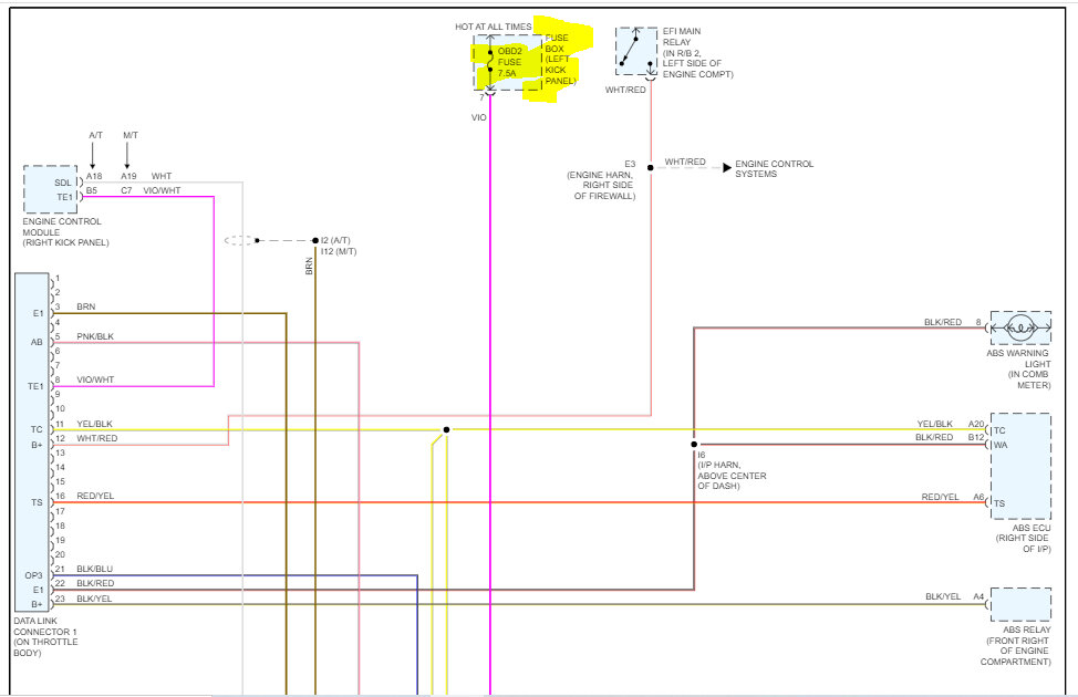

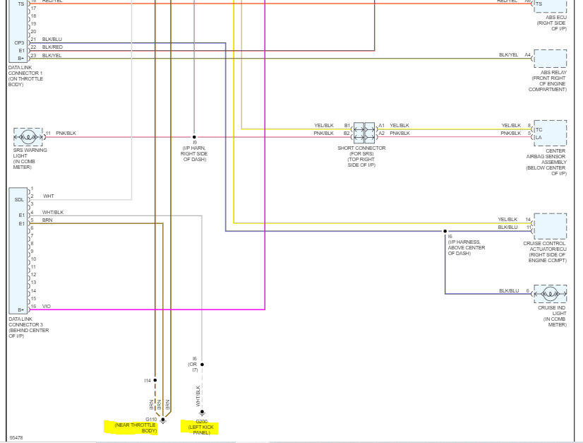

Do me a favor. Take a look at the wiring schematic below. Make sure the OBD fuse in the fuse box under the dash is good. Additionally, make sure there is power to and from it.
If the fuse is good and has power to and from it, check pin 16 in the DLC for power. It should have power at all times.
If that has power, confirm fuses 4 and 5 have continuity to ground.
Let me know what you find.

Yes, it dies as soon as I allow the key to go back to the run position and yes it will do the same thing over and over again until battery dies. No, the check engine light never comes on. Even when I got the truck and there was 2 stored error codes the light was still not present. I just noticed tonight that the radio stations that the lady had set from 2019 are still set. This truck sat for 3 years with a dead battery and since I have had it I know I have had the battery disconnected a couple of times for more than 24 hours. One of those times the EFI fuse was pulled for the whole 24 hours as well because I changed the fuel pump and fuel filter. I even pulled the ECU recently to do a visual inspection thinking that a capacitor may have went bad and had it unhooked for over 24 hours. It is not possible that someone could have played a prank on me either because I am the only one here. Both legs of the fuse for the ECU are good. 16 has power. 4 and 5 have continuity. I also straight wired my fuel pump and truck ran just fine.

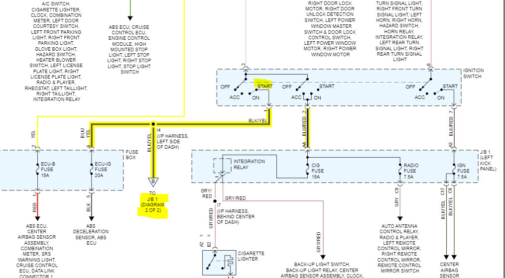

I think we have an issue with the ignition switch. As far as the 10v when cranking, that is because there is a heavy draw on the battery by the starter. I was always taught it needed to be a minimum of 9.6v for the engine to start, so that is okay. However, when you let the key return to the run position, the voltage should then go to 12v.
This is a theory, but I feel the ignition switch itself has failed internally. If you look below, the switch should be providing power in both start and run positions. See where I highlighted. It does get it in the start position, but it returns to the run position, we lose power. This is where I believe it is happening. Also, with the key off, there should be no power from the switch. There will be power to it, but once off, nothing should come from it.
Disconnect the ignition switch and see if the .22v is gone. At least we will confirm there isn't a short to power from a different source.

See pic below.

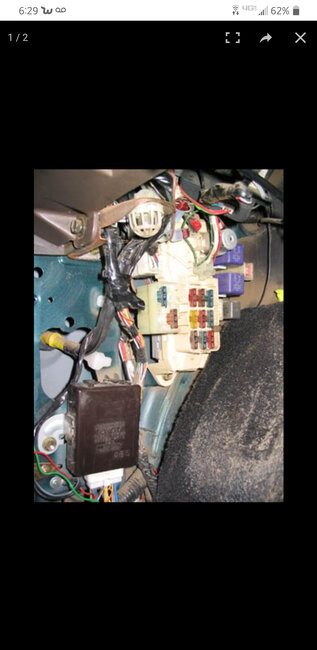

My fuse box doesn't have the two metal contacts inside of the ECU-IG fuse spot. I attached an image of what my fuse box looks like.

I hope I'm not confusing you. If I had the car, I would locate the ECU/IG fuse in the fuse box. With the key off, it should have no power. Have a helper turn the key to the run position to confirm there is power present. If there isn't, turn the key to the start position to see if it is present then. If it is, the ignition switch is my first suspect.
Nov 17, 2022 at 8:39 PM
JOEY GANN
  • 8 POSTS
Key off- no power.
Key on acc- power.
Key in starting position- power.
Key in run position- power.
