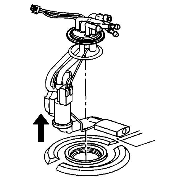

It started running really to rough and it would shut off at stoplights Then it lost power and barely go about 10 mph and I would put it in neutral and floor it to keep it running but sounded like it was misfiring and could not get the RPM's up.
Now it won't start. I have spark and fuel pressure. I did spray shot of starting fluid in to see what it would do and it fired but would not run. Help!
Wednesday, May 15th, 2019 AT 6:22 AM
Good morning,
What is the fuel pressure? It sounds like a fuel delivery problem from low fuel pressure.
REMOVAL PROCEDURE
1. Remove the negative battery cable.
2. Relieve the fuel system pressure. Refer to Fuel Pressure Relief Procedure. See: Fuel Delivery and Air Induction > Procedures
3. Raise the vehicle.
4. Remove the fuel tank. Refer to Fuel Tank Assembly. See: Fuel Tank > Procedures
5. Remove the fuel sender unit assembly by turning the cam lock counterclockwise using tool J 39765.
6. Disconnect the fuel pump from the sender assembly.
- Pull the fuel pump up into the attaching hose while pulling outward from the bottom support.
- Do Not damage the rubber insulator or the strainer.
7. Inspect the fuel pump attaching hose for signs of deterioration.
8. Inspect the rubber sound insulation at the bottom of the pump.
9. Inspect the strainer.
