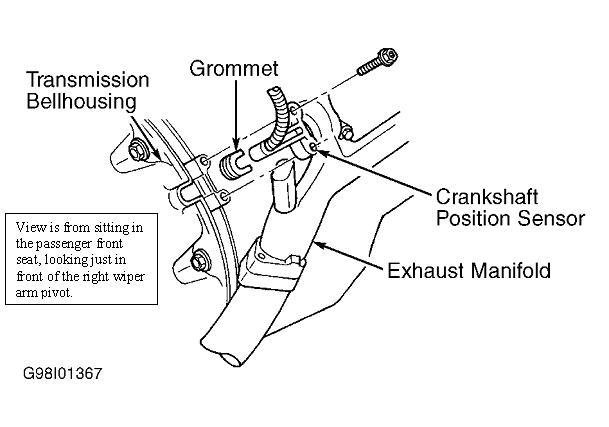

I have had this truck one week, while idling the other day the truck just stalled out! Was furious as when I got in it to restart it, it would crank over normal, but would not fire. I noticed that the fuel gauge would not register. I had just filled the tank and thought that someone had hit my tank, put three gallons gas in to find it still full. Upon further checking, I am not getting spark at the plugs, no juice to the coil, no juice to the o2 sensor. Do not know what to do next.

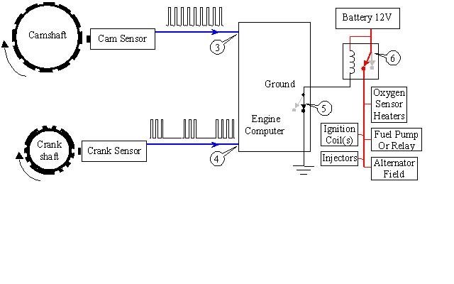

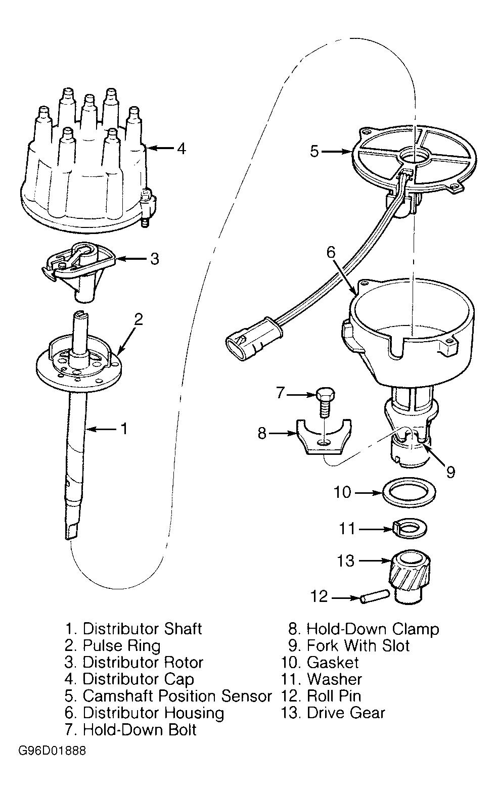

First let me describe how this system works. When you turn on the ignition switch, the Engine Computer turns on the automatic shutdown, (ASD) relay for one second. You might hear the hum of the fuel pump during that time. When you start cranking the engine, the computer receives signal pulses from the crankshaft position sensor behind the rear of the right cylinder head, and the camshaft position sensor. That is a disc under the rotor in the distributor. The signals from the two sensors tell the computer the engine is rotating, (cranking or running), so it turns the ASD relay on again. That is the step that most commonly does not occur, due to a failed sensor.
The ASD relay sends current to the ignition coil, injectors, oxygen sensor heaters, alternator field, and fuel pump or pump relay. The purpose of this safety system is in the event of a crash in which a fuel line gets ruptured, the pump would dump raw gas on the ground creating a serious fire hazard. With a broken fuel line there cannot be any fuel pressure. Without pressure, no fuel can spray from the injectors, so the engine stalls. Once stalled, the signal pulses stop arriving from the two sensors, so the computer turns the ASD relay off. That stops the fuel pump.
If you have access to a scanner, use it to view live data and look at how the two sensors are listed. I have a Chrysler DRB3 for all of my vehicles. That lists the sensors with a "No" or "Present" during cranking. Aftermarket scanners should have a similar way of showing this. If you find one that stays on "No" during cranking, or if you find a diagnostic fault code related to one of them, that only indicates the circuit that needs further diagnosis. There is only about a fifty percent chance the problem is actually caused by the sensor listed in the code. You first must look at wiring and connector terminals, and for mechanical problems related to that sensor. For example, on older models, the critical air gap for the crankshaft position sensor was set accurately with a glued-on paper spacer. If that is not used, you can run into an intermittent stalling problem, (do not ask me how I learned that!), a crank/no-start, or the sensor can hit the flex plate and break. That sensor in 2002 uses a different-style bracket that prevents the air gap from being set incorrectly, so that is one thing we do not have to worry about.
When you do not have a scanner, the fastest way to determine if the ASD relay is being turned on is to measure the voltage at the ignition coil, any injector, or either smaller wire on the back of the alternator. That wire at all those places is always the same color; dark green/orange. A test light works best for this because you can see it from inside the truck, and digital voltmeters usually do not respond fast enough. You should see the test light turn on full brightness for one second when you turn on the ignition switch. What is important is if it turns on again during cranking. If it does, you have a failed fuel pump or a failed ignition system, but not both. These two symptoms account for only about five percent of crank/no-starts.
When the light does not turn on again during cranking, you will have a failed fuel pump, no spark, and no injector pulses. This accounts for the other ninety five percent of crank/no-starts. Most commonly it is caused by the cam or crank sensor, but as I mentioned, we do not want to just throw a new sensor at it without checking the wiring first. Either of these sensors on any brand of car or truck often fail by becoming heat-sensitive, then they work again after cooling off for about an hour.
This first diagram is a representation I drew up to show what is involved with this circuit. The second one shows the location of the crankshaft position sensor, and the third one shows what is involved in replacing the camshaft position sensor.

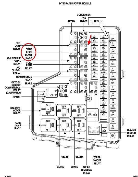

I followed as you said, hooked a light up to the injector wire and turned the key on, no light at all!

Assuming you checked the light's connections, if it really never turns on, we have to look at the ASD relay and its fused supply circuit. The red arrow in the first diagram is pointing to it in the under-hood fuse box. Terminal 30 must have 12 volts all the time. Be careful to just touch the terminals with the probe of your test light. Poking into a terminal can stretch it resulting in miserable intermittent problems in the future. Your ASD relay will look like the one on the right in the second drawing. Sorry that I can't remember which one is terminal 30, so check both of those with arrows pointing to them. One must have 12 volts. If it is missing, check fuse # 2, a 30-amp cartridge fuse.
The fuel pump relay is right below the ASD relay in the drawing. That one must also have 12 volts on terminal 30. You can use it for reference because it uses the same terminal numbers, and terminal 30 will also have 12 volts all the time.
If you do have 12 volts on terminal 30 of the ASD relay, it should also be on terminal 85. That's one of the two smaller terminals in the two corners. If you can reach the other corner terminal, (# 86), with the probe, with the relay partially-installed, you will find 12 volts there too. Terminal 86 is supposed to get grounded by the Engine Computer when it wants to turn it on. If that is not happening for that first one second, the computer is the best suspect, but we should check that all its power supplies are present before we condemn it.
