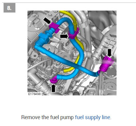

It could be bad fuel, or a bad injector pump which is common or low compression, I don't think the individual injectors are bad because they would all need to go bad at once. Can you confirm there is fuel getting to the high pressure fuel pump? Turn the key on and fuel should be present. Check out the images (below). Let us know what you find.
Tuesday, September 10th, 2024 AT 9:25 AM
MYFATHERSSON
  • 26 POSTS
Hi Ken,
Yes, the fuel is getting to this pipe.
Many thanks
Tuesday, September 10th, 2024 AT 11:03 AM
KEN L
  • MASTER CERTIFIED MECHANIC
  • 55,535 POSTS
Okay, so those are the choices, bad fuel, (doubtful), bad high pressure fuel pump or low compression.

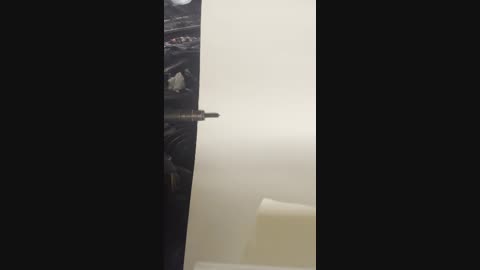

MYFATHERSSON
  • 26 POSTS
Hi Ken,
So, after my son recorded it for me whilst I cranked the engine, it turns out it doesn't spray very regularly at all. The video is attached.
Many thanks
Friday, September 13th, 2024 AT 12:20 PM
KEN L
  • 55,535 POSTS
Good call, it is hard to see against the white background but it doesn't look good.
