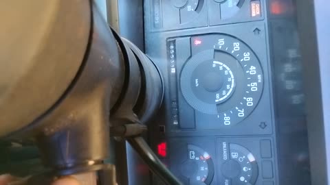

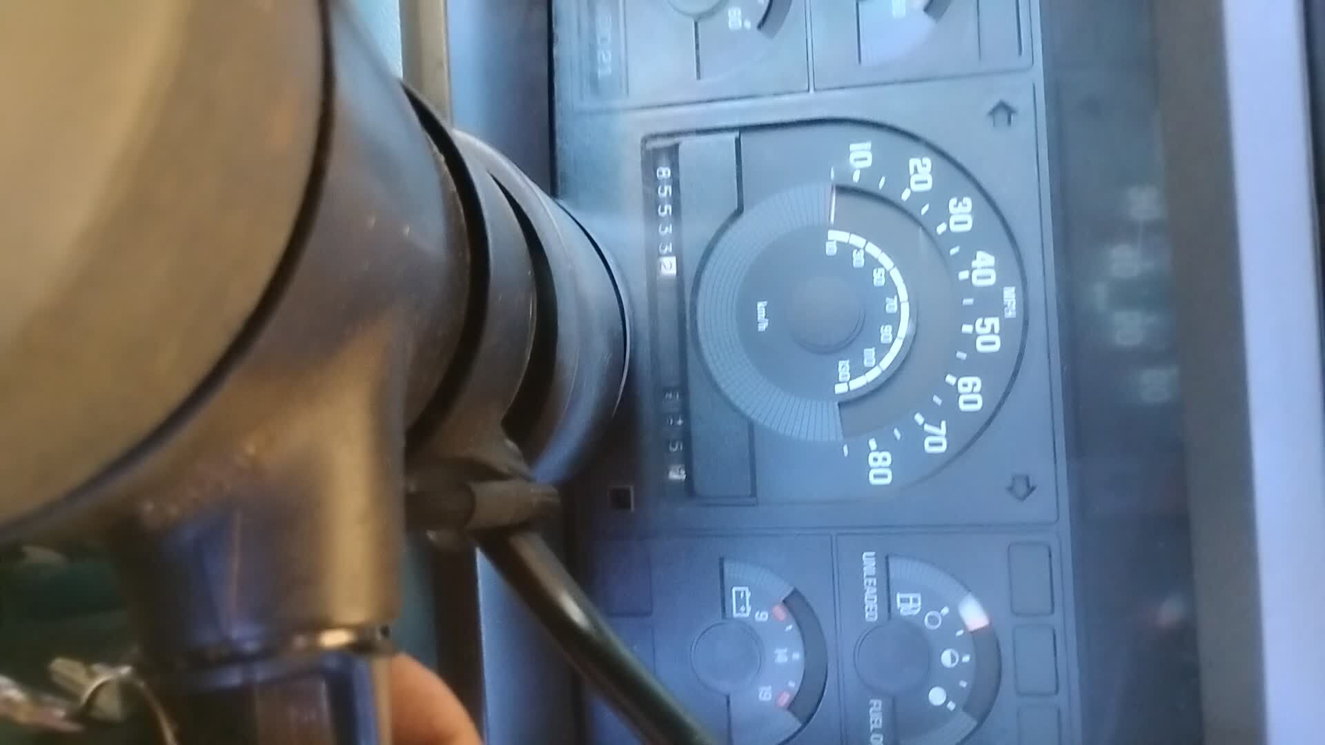

Here is a video of what I mean by cranking.
Jul 26, 2025 at 2:12 PM
STEVE W.
  • 15,171 POSTS
Okay, is that the security light I see flashing? If so, then you have an issue with that shutting off the fuel because it doesn't see a valid key. That will cause it to crank over and maybe run a second or two, then it won't run after that. From the minimal amount I heard it fire it is in time. If it wasn't you would hear it backfiring out the intake or exhaust. Has the ignition been changed or a key without a pellet being used? Yes, it would start with the EGR off, it would be LOUD though.

No that's not a security light; there is no security offered in 1991. There is a lot of play in the steering wheel, and I've trouble at times with the key being hard to twist on and it won't Go back at all.
Jul 26, 2025 at 5:15 PM
STEVE W.
  • 15,171 POSTS
Blew the video up and it looks like the CEL flashing. The key not turning Can cause that if the end of the cylinder isn't turning the insert and the switch fully. If you have someone spray it, will it run then? If yes, then you have a fuel issue. Have you tried using the pump prime circuit to hold the pump on while you try starting it?

the service engine soon comes on, but it goes off. I don't know if I mentioned it or not but I'm alone and don't have anybody to spray it. I have to get out and spray it and I'll jump in try to crank it. I don't know what the pump prime circuit is but what I've done is I run a wire from the battery up under to the dash where I put it into the fuel pump slot in the same place you would hook a code reader t,so it was constantly running then sprayed starter fluid and jumped in and tried to crank it. But I originally thought it was the ignition switch and was told differently so I just left it alone but know it sounds like you are saying that it could be the ignition switch? The answer to your question is no it still doesn't run when starter fluid is used. I already have to buy an EGR valve, and I am not sure if I can afford much more.

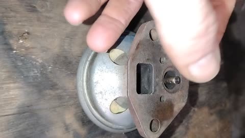

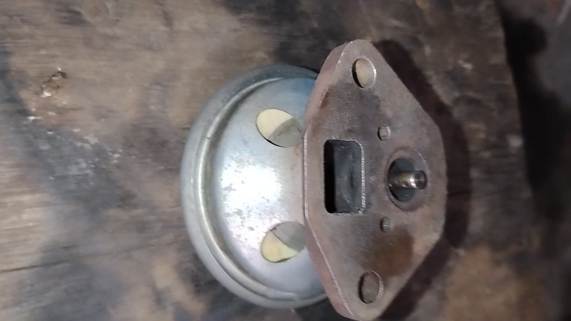

Update.. EGR valve is definitely bad I performed the vacuum test on it and also I pushed in with my hand and I sealed off the other hole and the diagram did not stay down and went straight back up so I'm going to order a new one but I was wondering shouldn't I be able to still crank the truck to where it is running even with the EGR valve off the motor. Cuz I'm thinking like I replace the EGR for sure but it's a truck still won't crank in the same place I am now.

It would start without the EGR installed, it would just be loud and run poorly, but it would run. The EGR opens the exhaust and intake bot. A bad EGR like you have basically becomes a block off plate. So, although it is bad, it isn't the problem.
