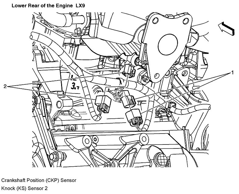

I am attempting to locate the pc519 crank shaft position sensor on the car listed above LS model.

This is for a 3.5L engine. It's shown as being on the back of the engine. Most likely you'll need to get at it from underneath.
Image (Click to make bigger)
