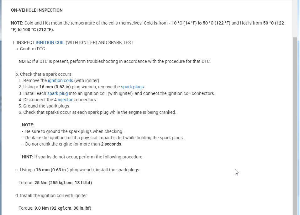

Okay, so I had time to work in it and here’s the thing: now there is power to fuel pump, there is power to injector but there is no spark on any cylinder.
Friday, May 21st, 2021 AT 5:56 PM
Okay. I attached the testing that we need to find out why we have no spark. Let's run through this and see what we find.
WROJAS0919
  • 13 POSTS
Thanks for the instructions. So, yes there is no spark on non of the cylinders and there is a code for coil 1 cool 2 coil 3 and coil 4. Also I got a code that says immobilizer not set up.
Okay. What are all the codes that you are getting so we can work through this? Thanks
