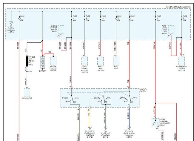

Vehicle just stopped would not start, cranks over fine?
KEN L
  • MASTER CERTIFIED MECHANIC
  • 55,266 POSTS

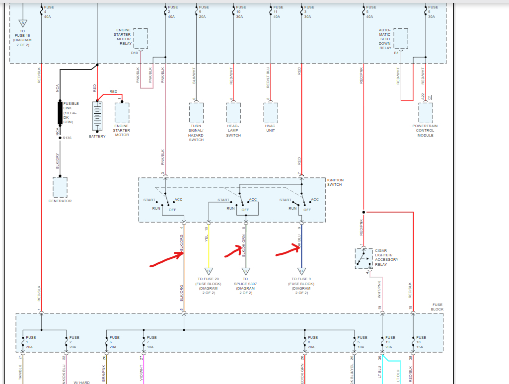

Okay, it sounds like the ignition switch is bad. here is a guide to help check for power and I have marked the wires you need to check for power when the ignition switch is in the "on" position:
Check out the images (below). Let us know how it goes.

Check switch and power with switch on it's okay.

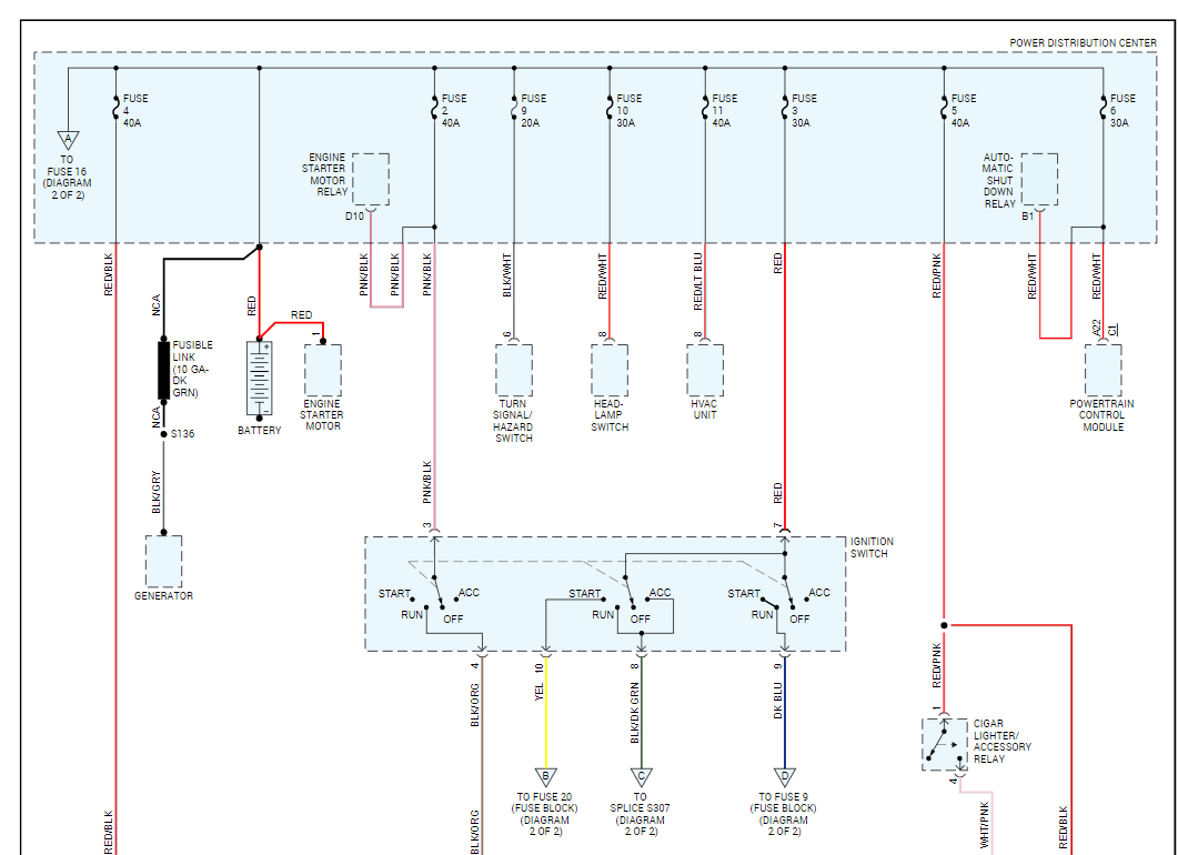

If you don't have power to fuse #6 (please double check) then the PDC had gone bad. Here is the wiring diagram to show you what powers fuse #6. You might be able to piggyback power onto the red/white wire from the PDC to fix it as well, I would use an inline fuse. Check out the images (below). Let us know what you find.

Sorry about how long it took me to respond but my Jeep is outside, and the weather has been too wet and cold, so it makes it hard to get much checking done. I appreciate your help.
I will try to do what you have requested soon.
