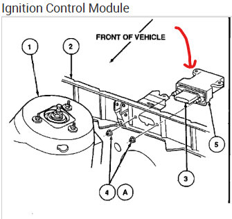

Okay let's see I was running on road to live intern going down hill car cut off pulled over and stop try to start it back started run for second cut back off started again run for second cut off try to crank it again and nothing just turning over like it's not getting fire or not getting gas got over here to check it getting gas still turning over like it's not firing check the call to get fired for a second and then it wouldn't turn it over get fire to the coal but the coal is not firing there's three wires on the coil is white wire a red with a green stripe and red with a Gray stripewhere it plugs onto the coal when it's plugged in I got hot on both sides of the wires that's the two red wires or tied together inside the plug you might work by itself but when I plug it up it's got fire on white wire and the other two red wires but when I unplug it only got hot on the red wires I think yes two reds hot when unplug it plug it into the coil and all three hot

The coil is getting power correctly, it is just not getting a close signal which makes the coil fire. I would unplug the MAF sensor first to see if anything changes, if not I would replace the ignition control module which is on the right side of the engine bay, this is usually the problem on these cars. Check out the images (below). Let us know how it goes

Okay I replaced the cold button cap the control module I replaced a week ago still just turning over I'm getting gas getting fire from the coil could the crank sensor make it not start and still get fire
