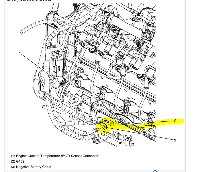

So, I parked my truck the other day and went to leave again. It hasn't started again since. I replaced the crank sensor, fuel pump, and cam sensor. Turns over no fire replaced all coil packs checked all fuses relays all good. So could be the harness or PCM?

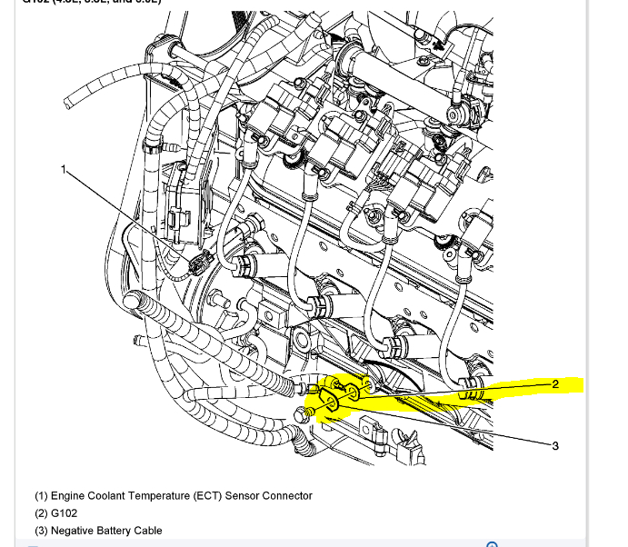

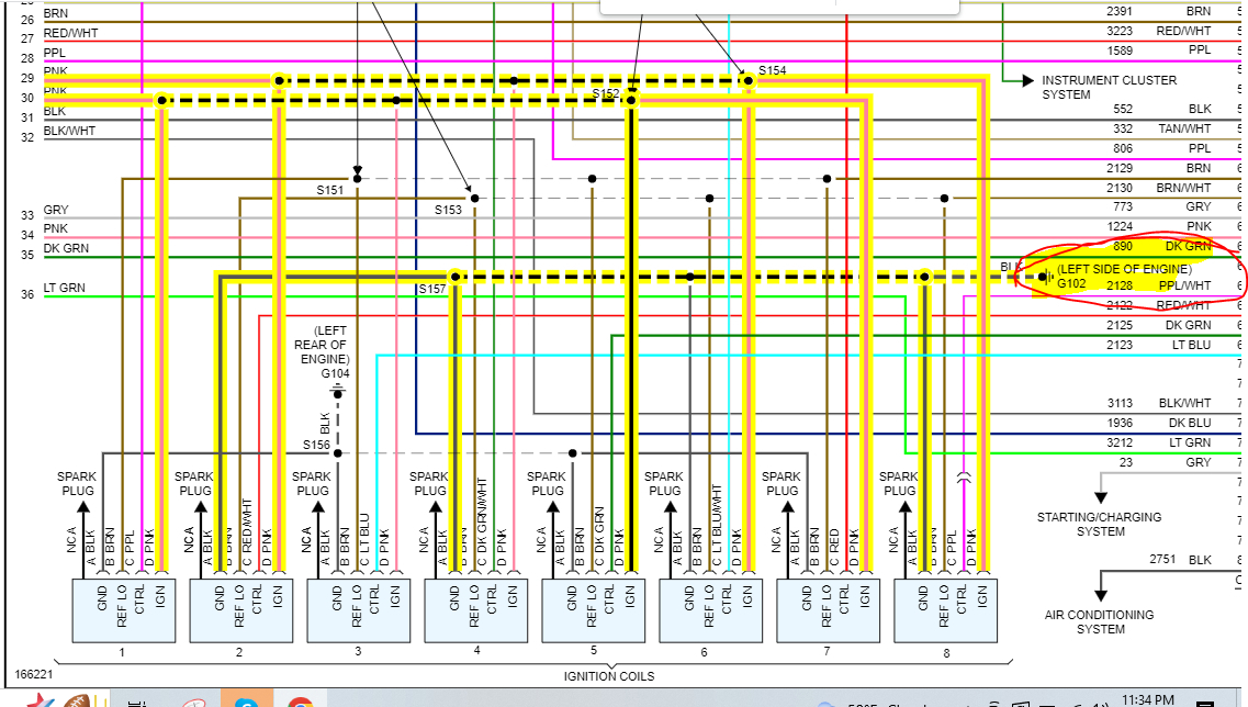

The first thing I need you to check is the ground for the ignition coils. The coils share a common ground, and they are known for failure. I have a feeling that is the issue.
If you follow the harness, you will find the ground wire (black wire) runs to the driver's side of the engine. It should be toward the front of the engine block. Check the connector and connection. The eyelet used to attach the wire to the block is likely ready to fall apart or is already broken.

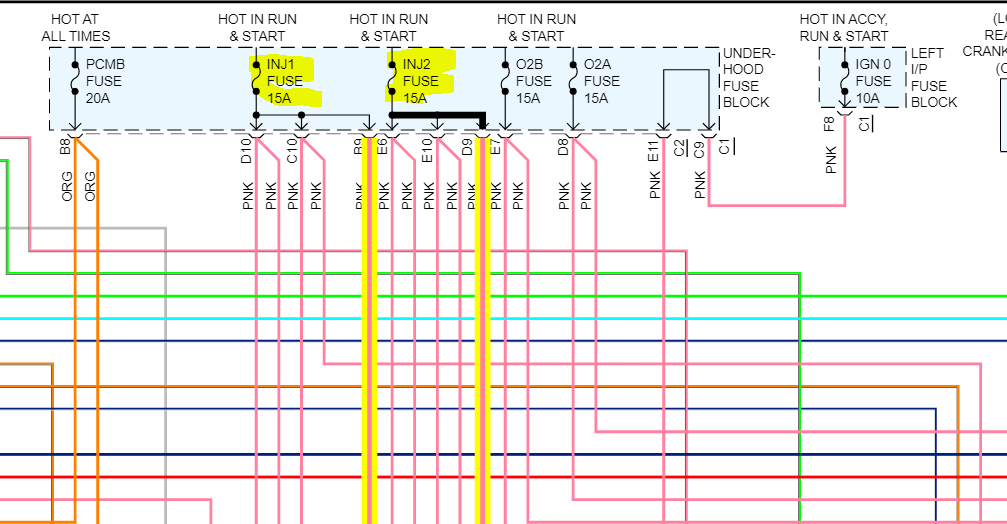

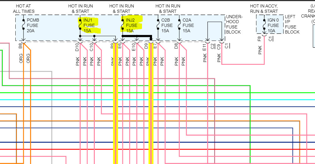

If the ground is good, then check the dark pink wires at each coil to see if there is power with the key in the run position. Note that the power is supplied via injector fuses. I don't know if you may have missed that.
Pics 1 and 2 show the fuses and coil wiring. Pic 3 is the location of the ground wire I'm referring to.
Let me know what you find.

See pic below.

I will check power again but had power and harnessooks good truck ran fine then went to leave again has started since key you hear throttle plate open and all clicks under the hood fuel pressure good no fire on any cylinder.

Were you able to locate the ground I mentioned? As far as the crank sensor is concerned, check to see if there is an RPM signal when cranking the engine. You need a live data scan tool to check it.
Friday, April 28th, 2023 AT 10:47 PM
CURE4SALVATION
  • 5 POSTS
Yes, I did turns out there were 2 faulty crank sensors just received ac Delco sensor and connector starts up. Crazy 2 new sensors no good from AutoZone. I do appreciate you taking the time out of your day to assist this matter.
