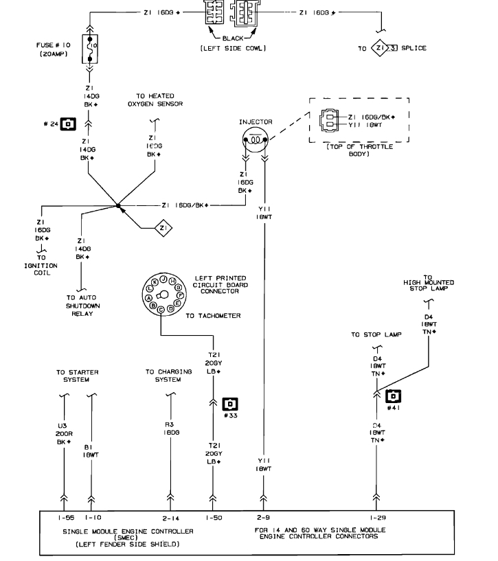

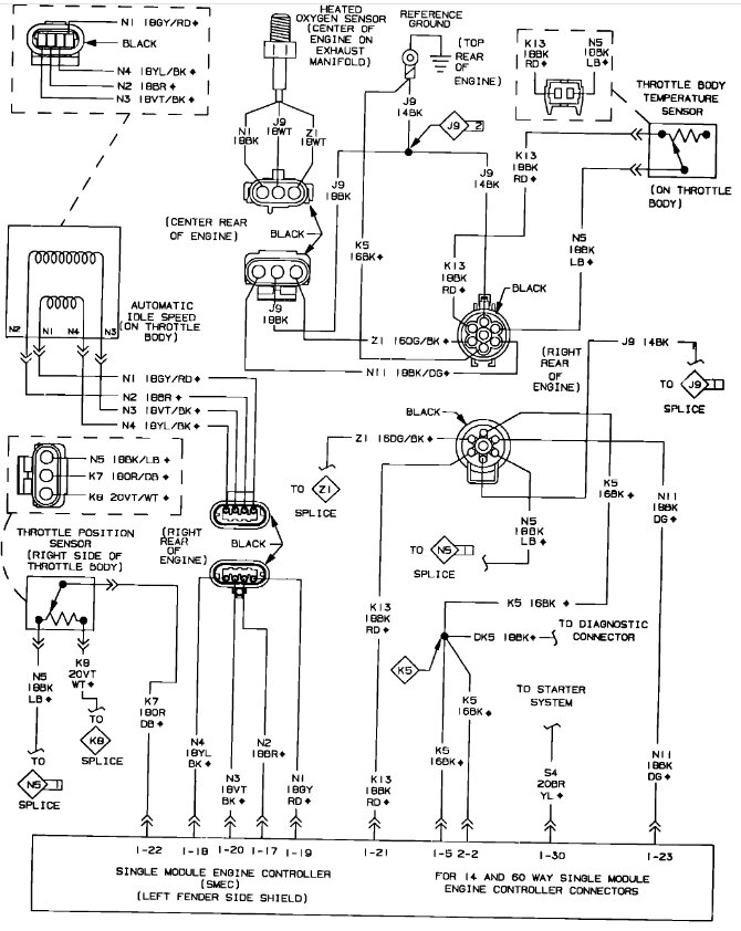

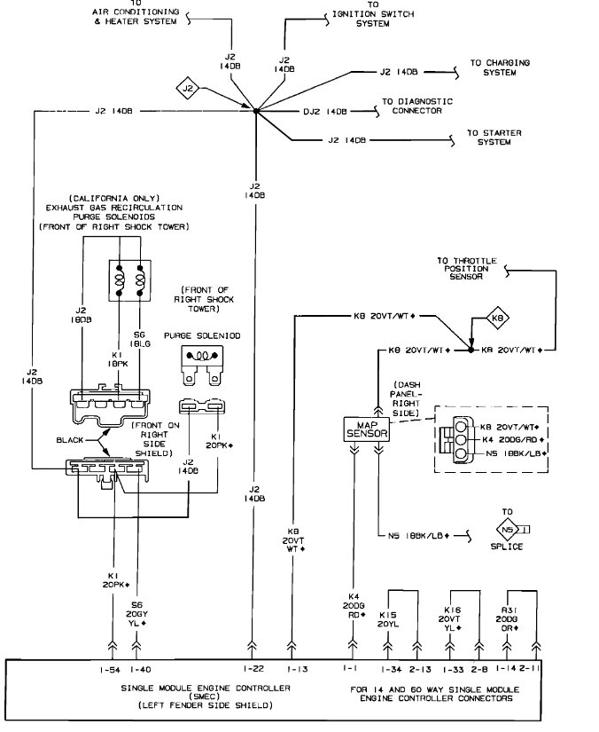

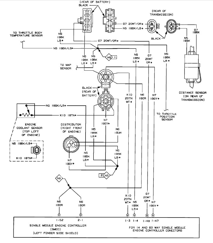

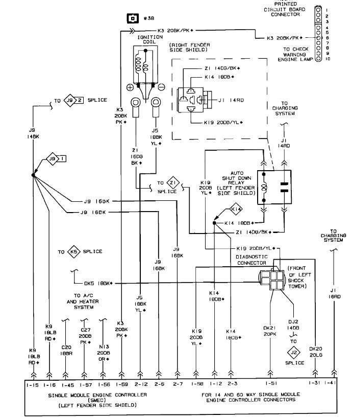

KEN L
  • MASTER CERTIFIED MECHANIC
  • 55,291 POSTS

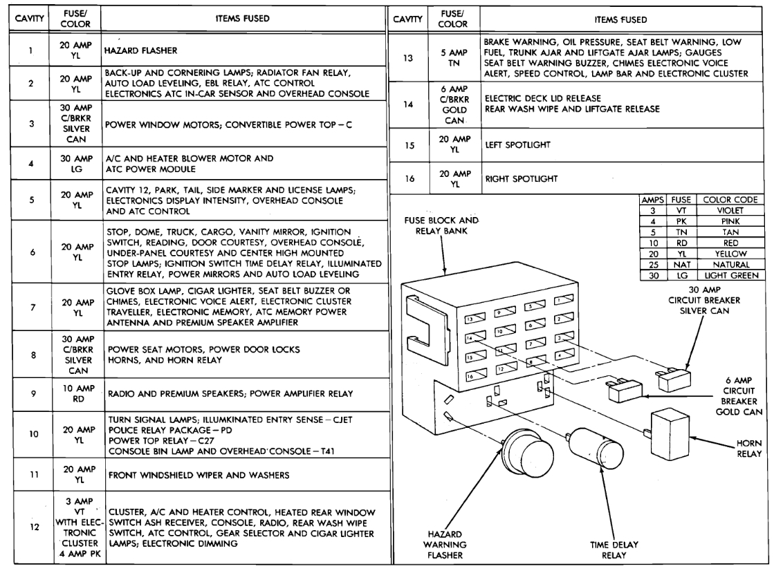

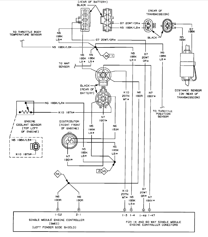

Let's go back to basics, please turn the ignition switch on and check all of the fuses, also while the switch is on check the positive side of the coil for power.
This guide can help:
Here are the engine and computer wiring diagrams so we can be on the same page and be able to see how the system works. Check out the images (below). Please upload pictures or videos in your response to the problem so we can see what's going on.
Wednesday, January 24th, 2024 AT 10:00 AM

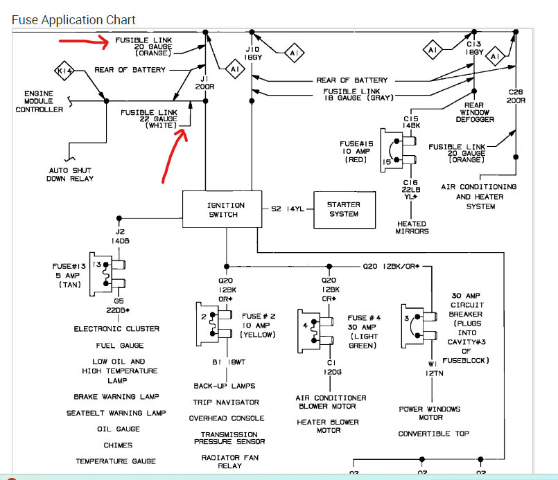

KEN L
  • 55,291 POSTS
There are fusible links near the battery, pull on them to see if they are connected. These are wires that burn up inside, you will need to replace them. Check out the images (below). Let us know how it goes.

JERRY ULLOA
  • 36 POSTS
So, I turned on the ignition no power at the coil.
Friday, February 2nd, 2024 AT 2:23 PM
KEN L
  • 55,291 POSTS
The power to the coil comes from the auto shutdown relay, did you replace it? If so, I would swap out the ignition switch. Also, check the fusible links by the battery.
