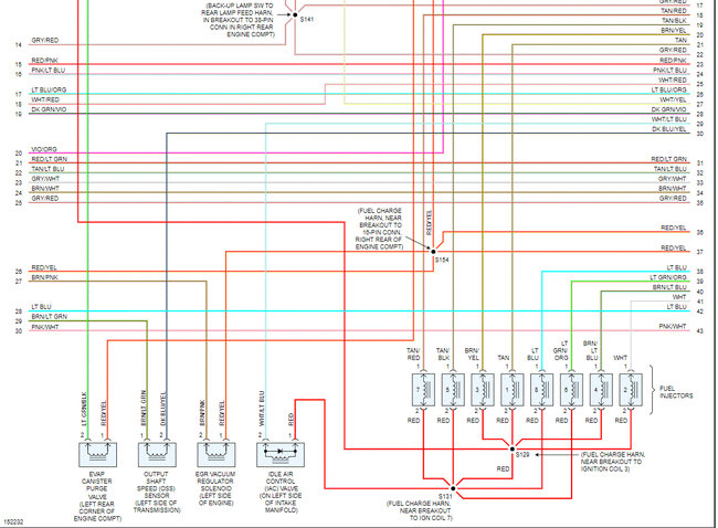

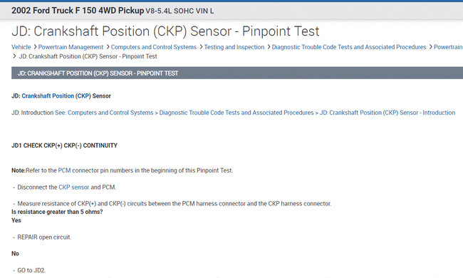

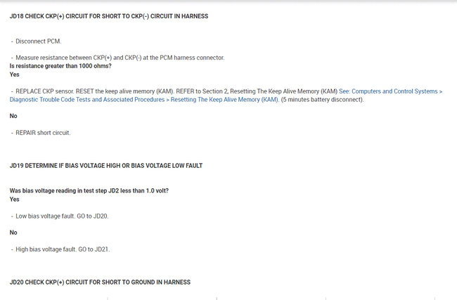

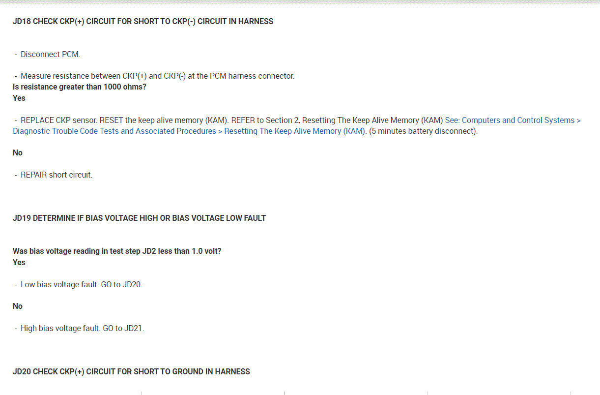

  • 110,192 POSTS

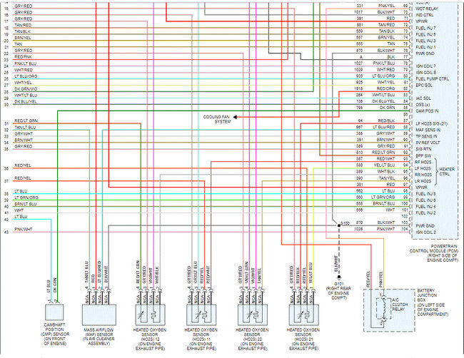

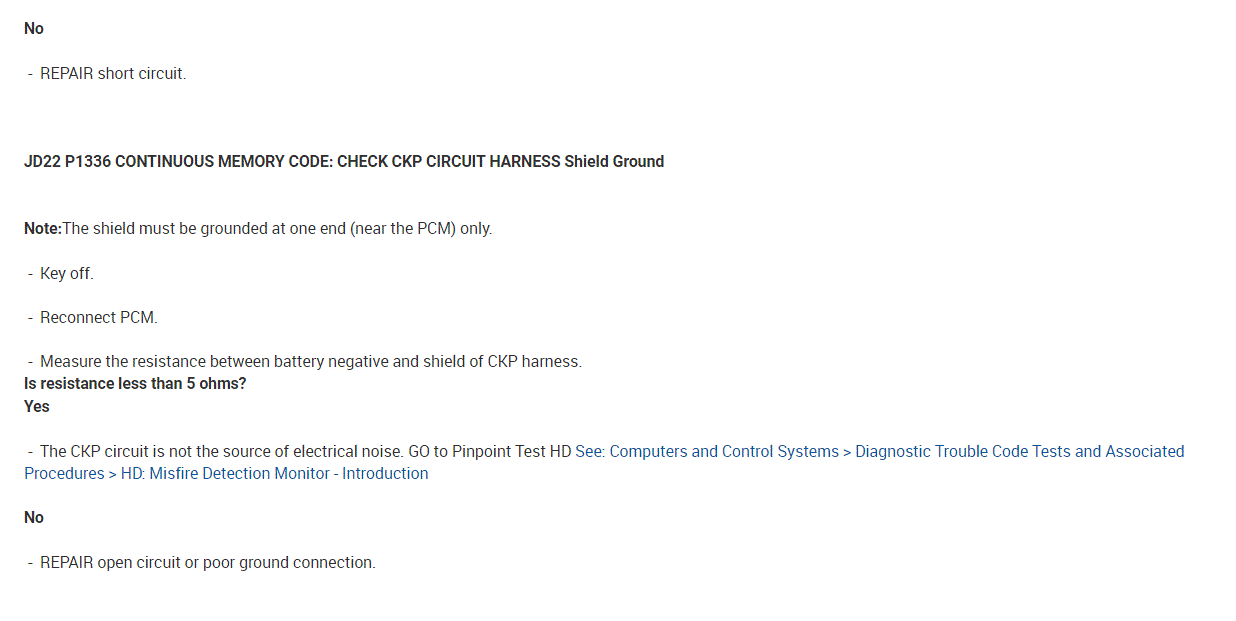

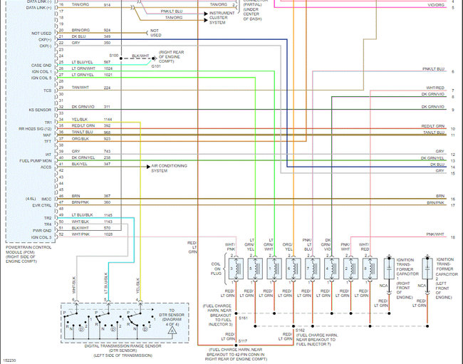

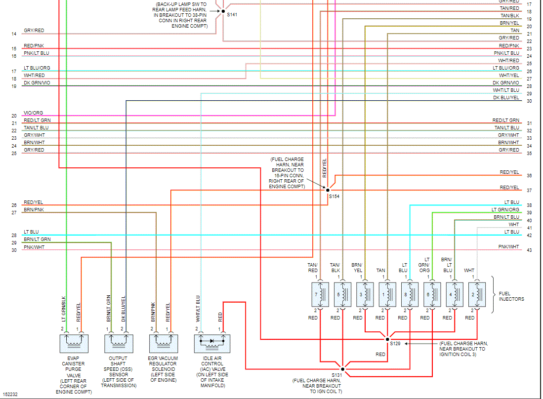

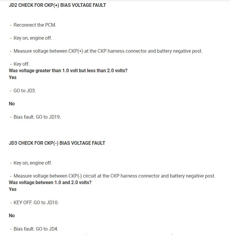

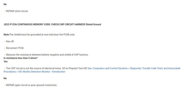

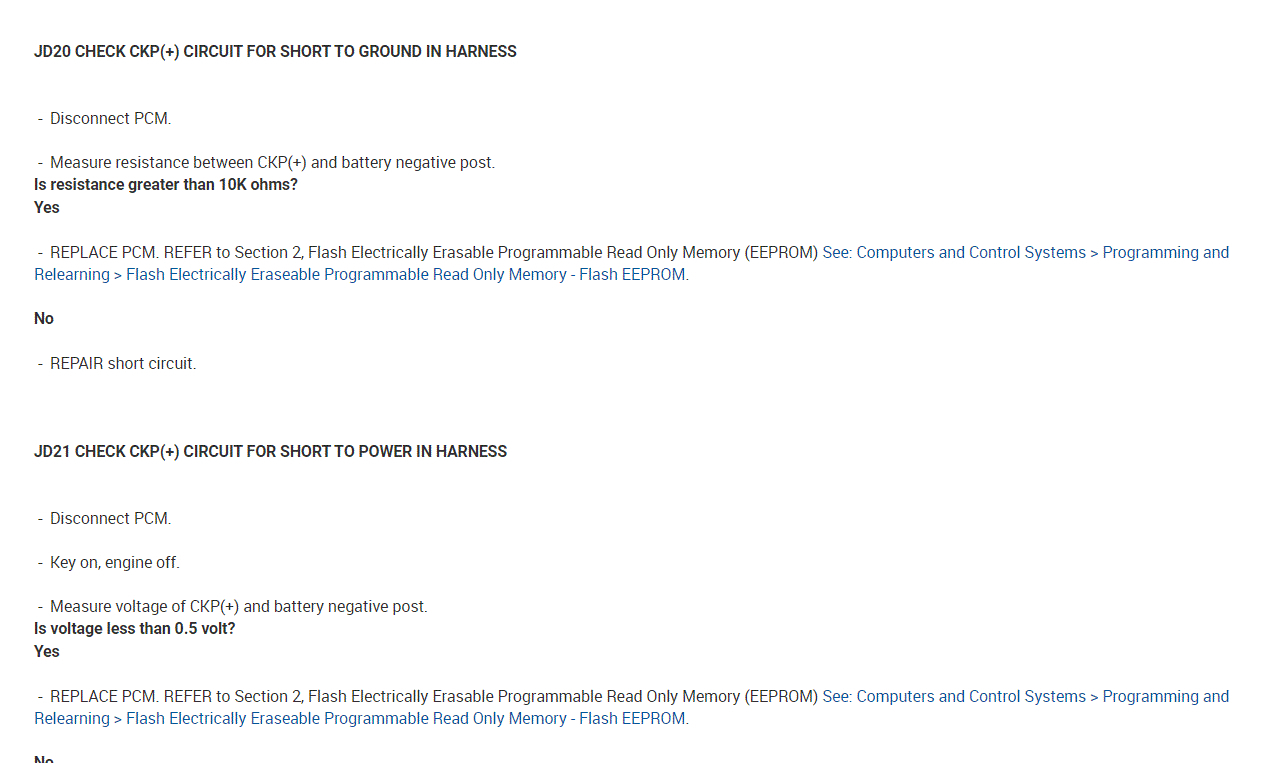

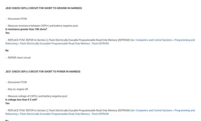

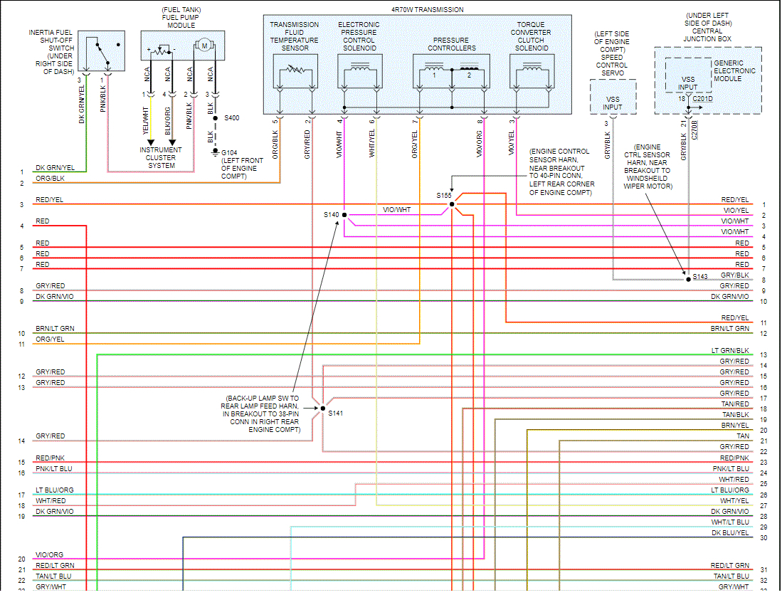

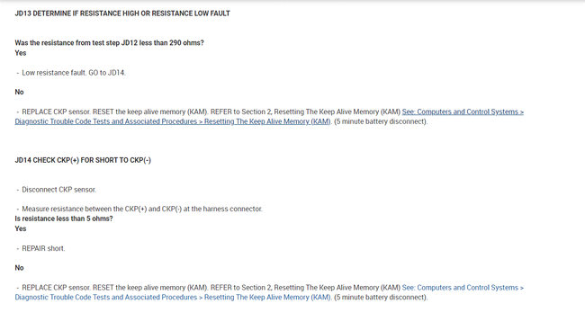

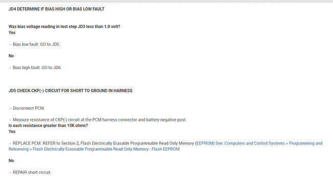

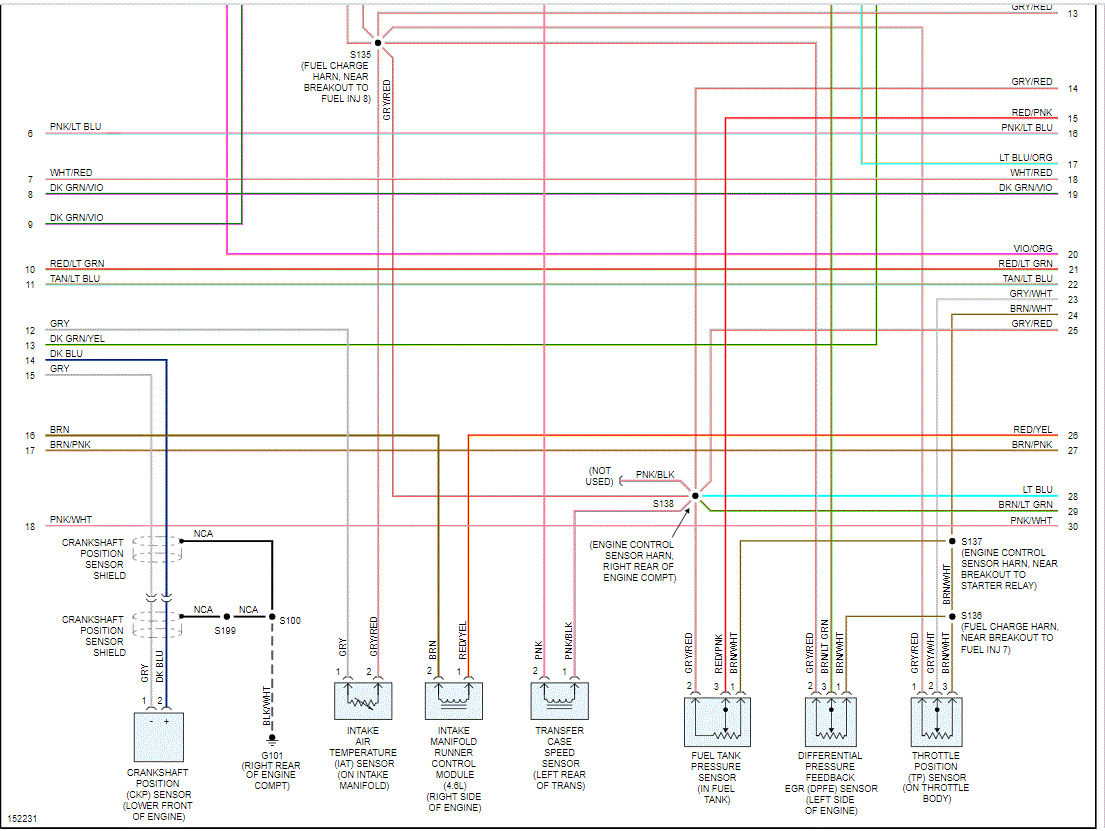

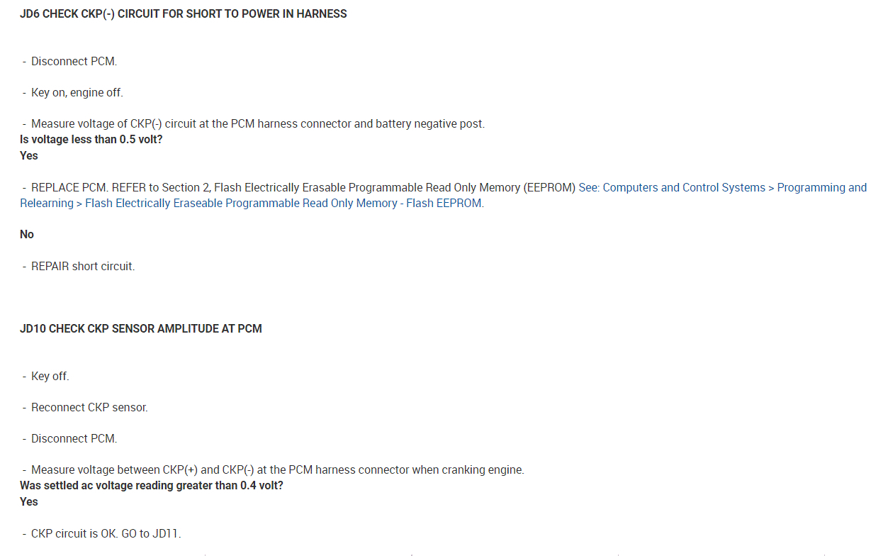

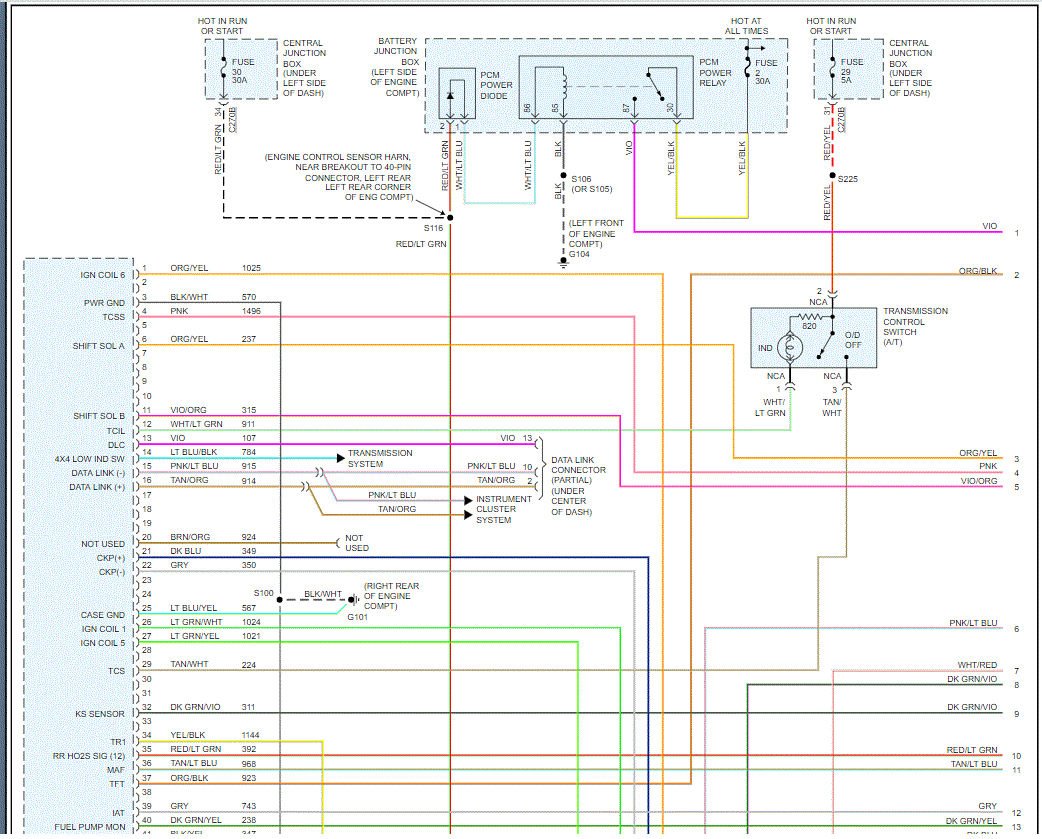

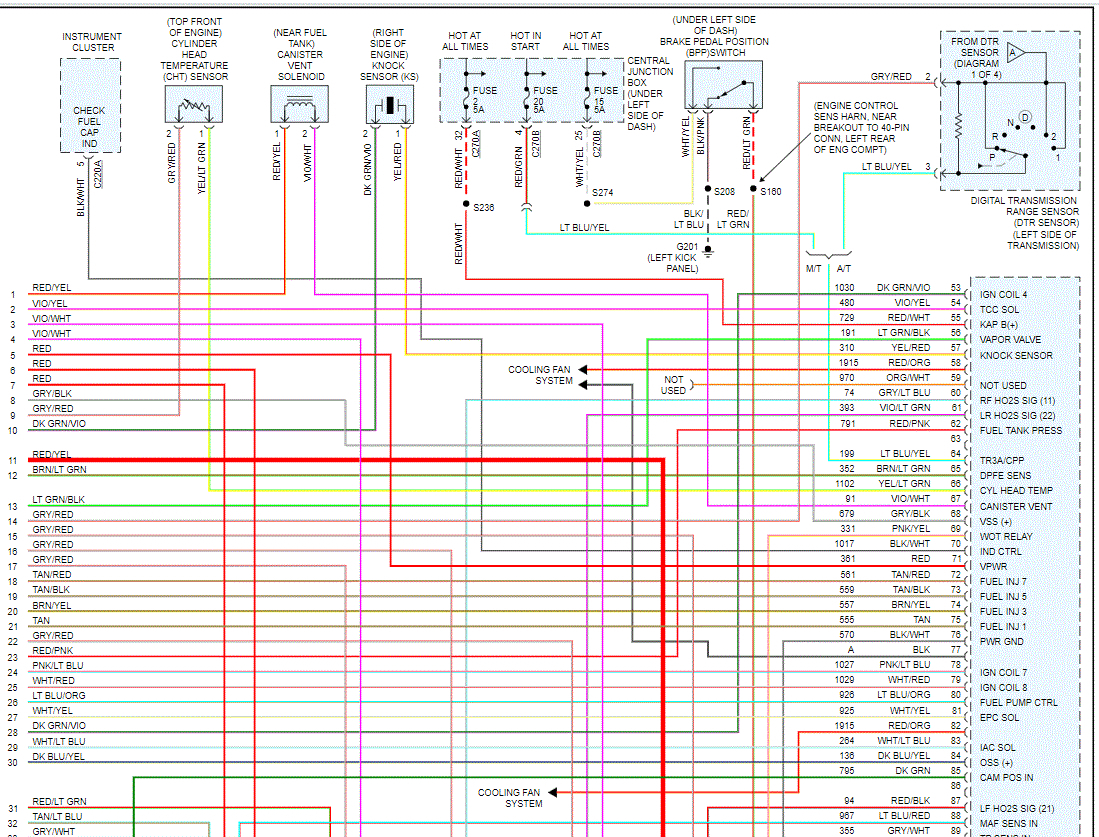

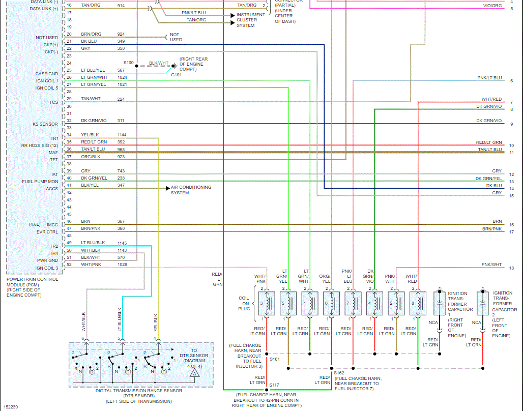

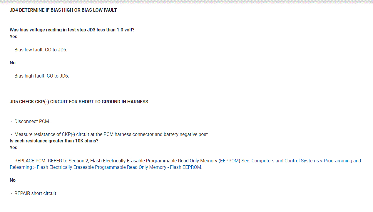

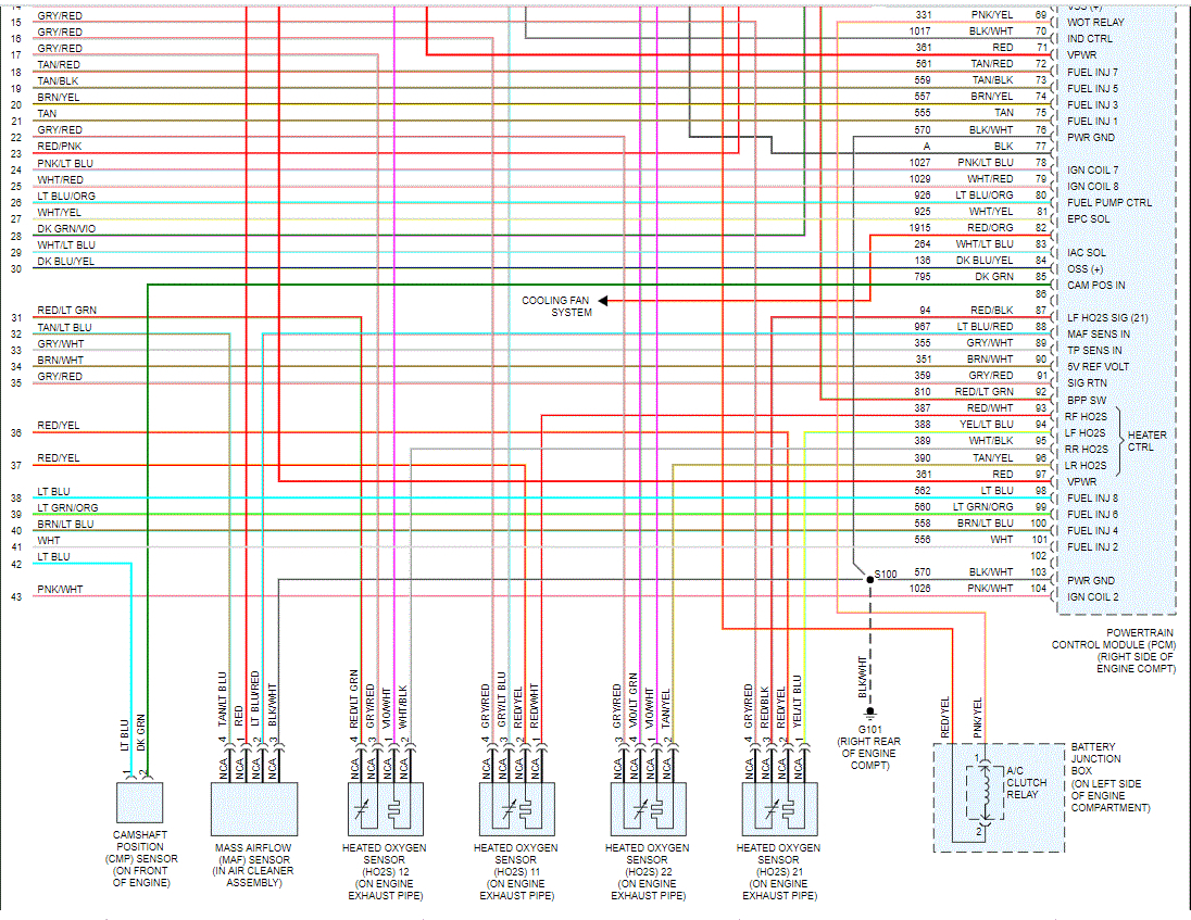

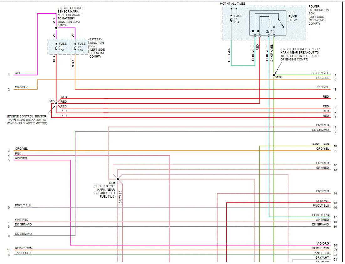

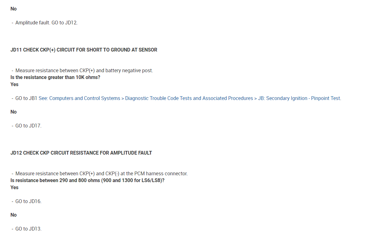

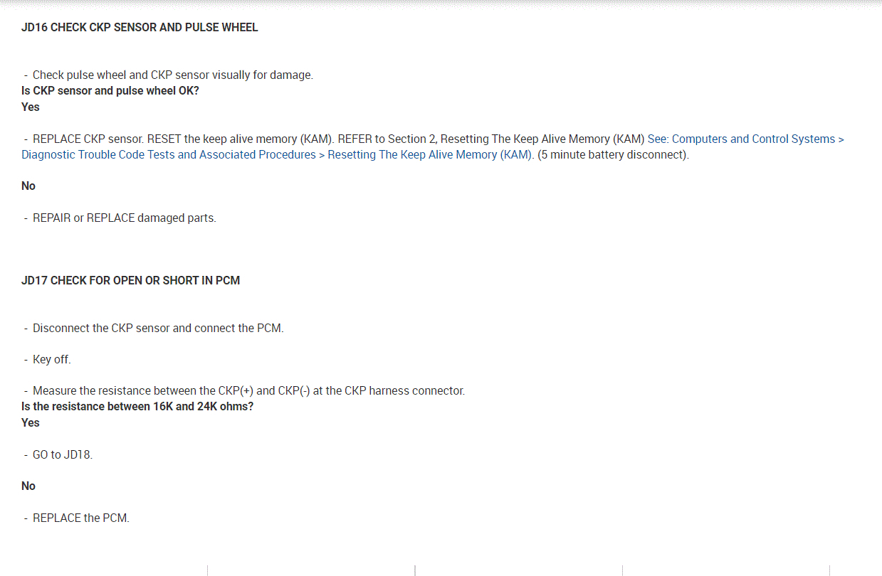

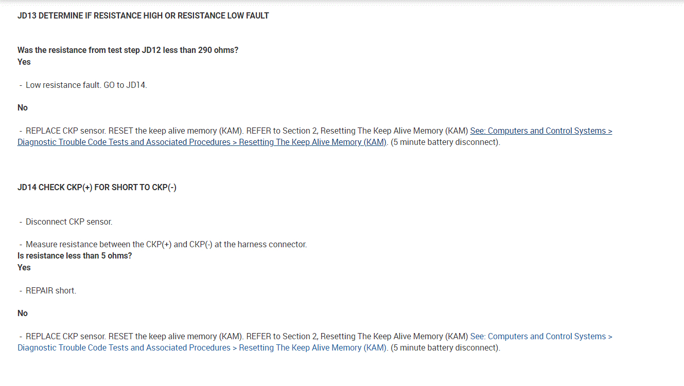

I noticed it has been a couple of days since you were contacted. Have you made any progress? If you still are dealing with a no spark issue, I need you to follow the directions in the pictures below. They will explain how to check the CKP, CKP circuit, and PCM.
If you are getting spark, let us know.
PS: Pics below include the diagnostic flow chart for the CKP. I also added the entire powertrain management wiring schematic for reference. I had to cut each pic in half to make them readable, but I did overlap them so you can follow them easier.

Thanks for your reply. Much appreciated. Here is how it “flowed”:
JD1-.2 ohms each wire
JD2- 1.56v
JD3- 1.56v
JD10 - with PCM harness disconnected, I got no voltage and engine barely turned over, (I removed battery for ease of access and connected it for testing with jumper cables. They got pretty warm pretty fast set up this way). Would this affect results?
Not sure how to inspect the crankshaft. Do I have to remove the timing chain cover?
Thanks again

Anytime you add length to a wire (jumper cables), it creates more resistance. That's why they got hot. If there is enough resistance, it can affect results. Did you make it through the entire test? The readings you indicated are good.
Monday, March 22nd, 2021 AT 6:07 PM
PETEY321
  • 23 POSTS

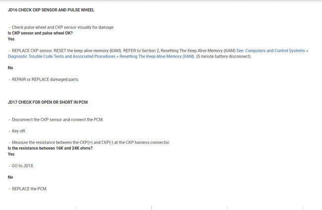

At JD10, testing as indicated, truck would barely turn over and I saw no voltage. Truck cranks more aggressively with PCM harness connected. Cont’d with JD12.
JD12- 297 ohms

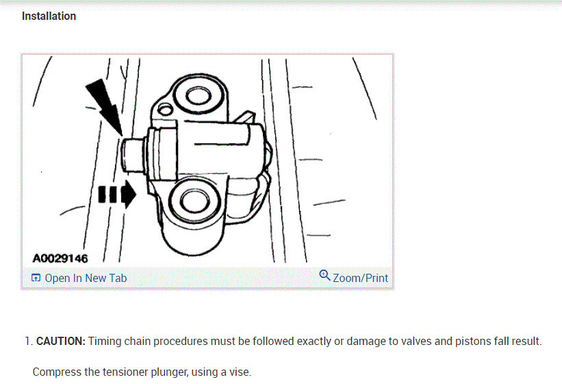

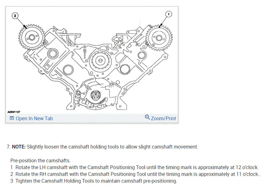

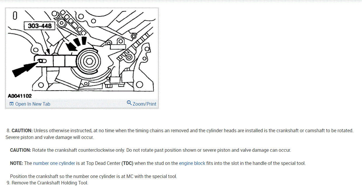

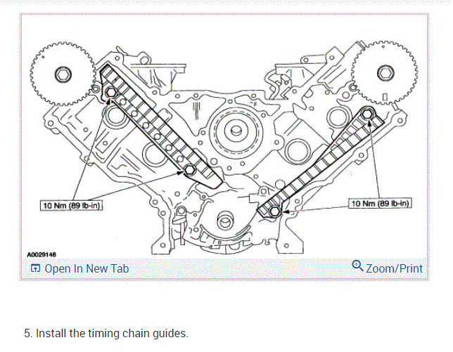

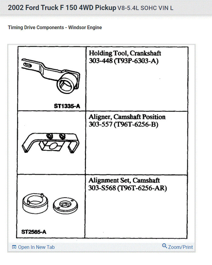

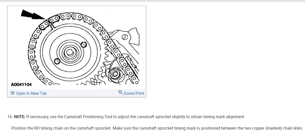

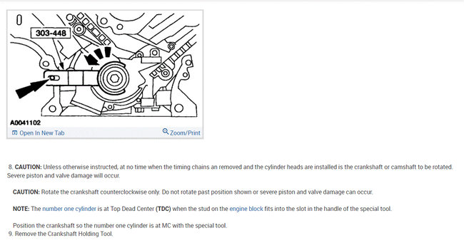

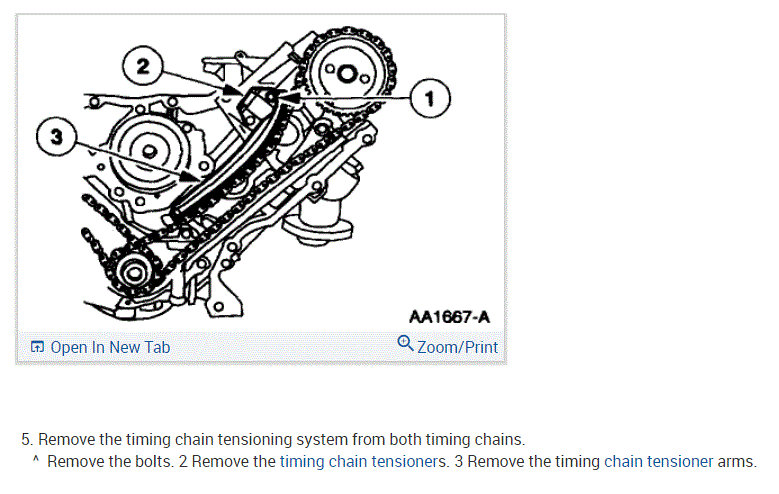

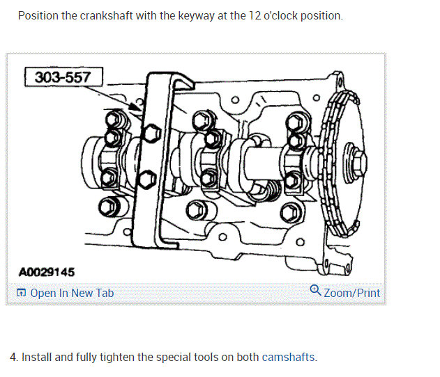

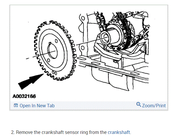

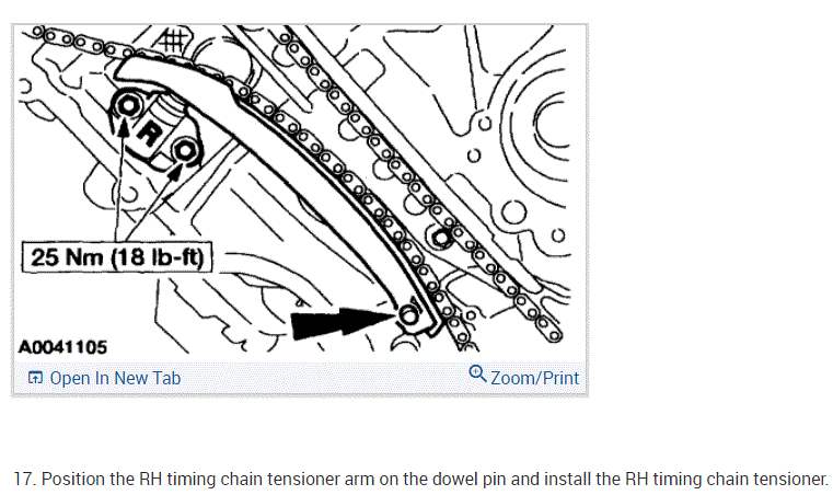

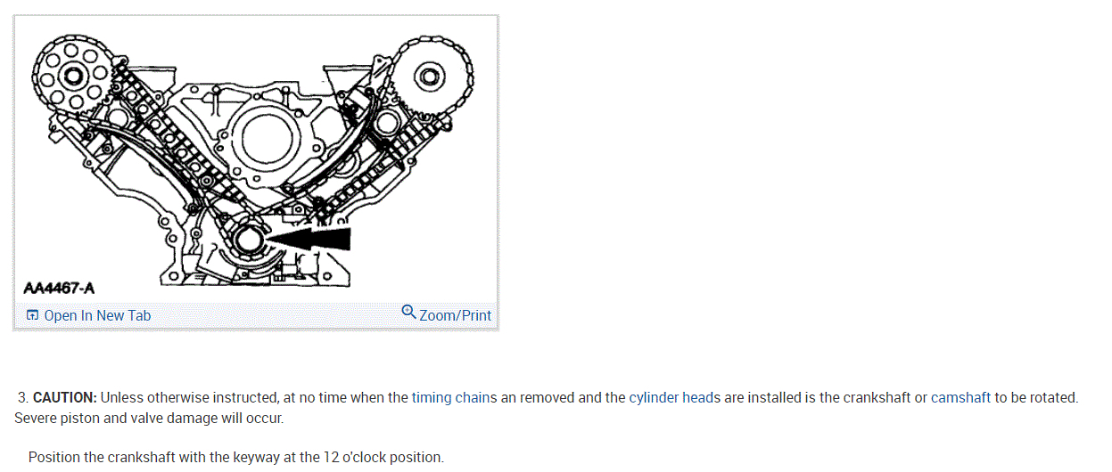

JD16- sensor is brand new and not sure how exactly to inspect the wheel without removing the timing chain cover?
Is there a way?
Monday, March 22nd, 2021 AT 7:56 PM

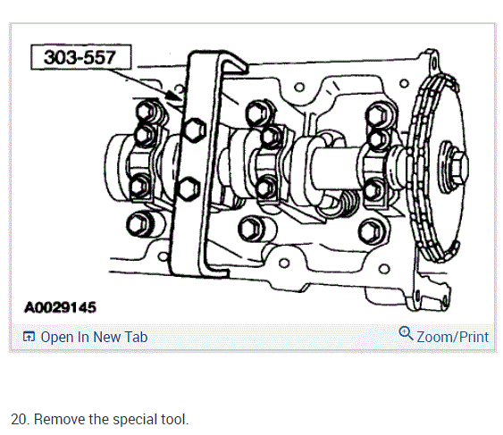

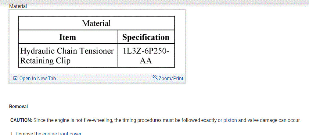

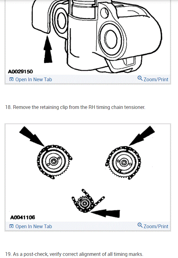

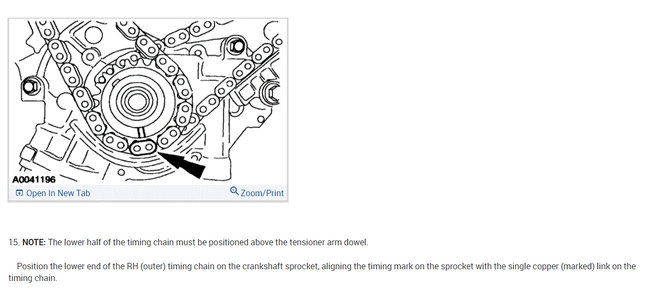

  • 110,192 POSTS

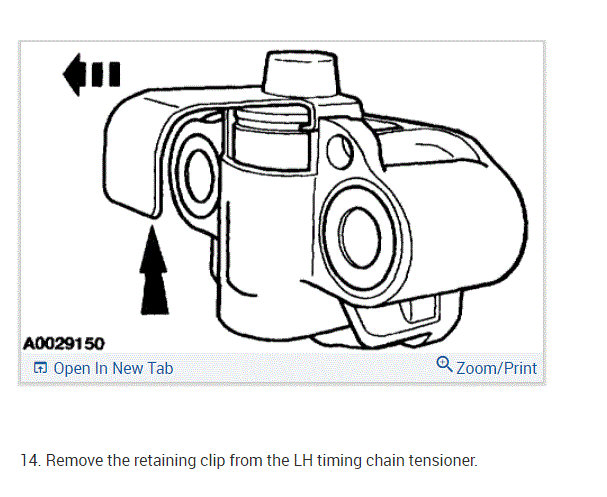

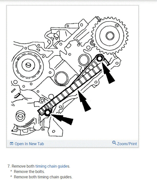

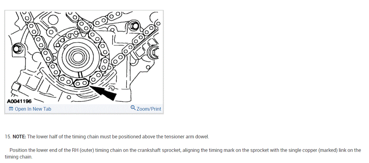

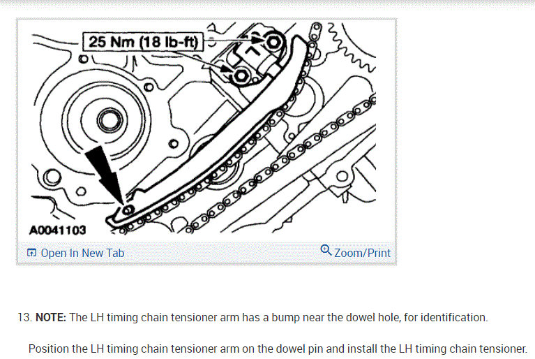

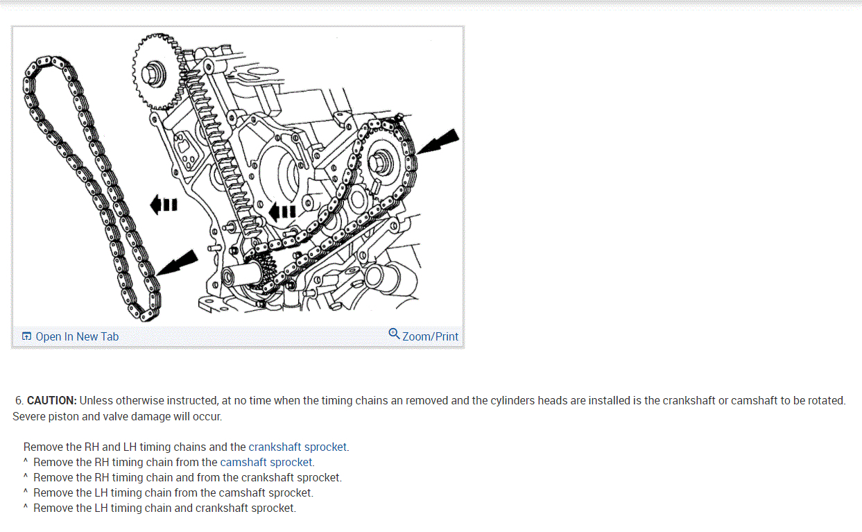

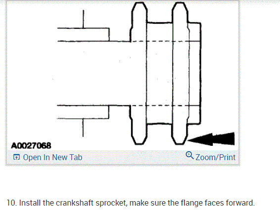

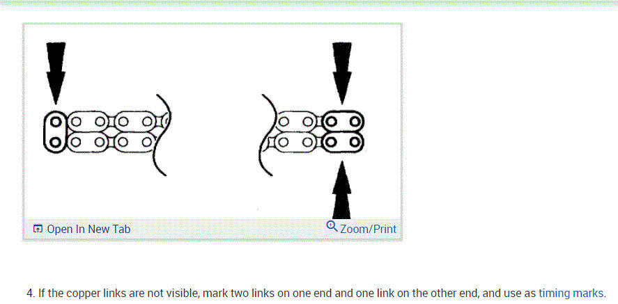

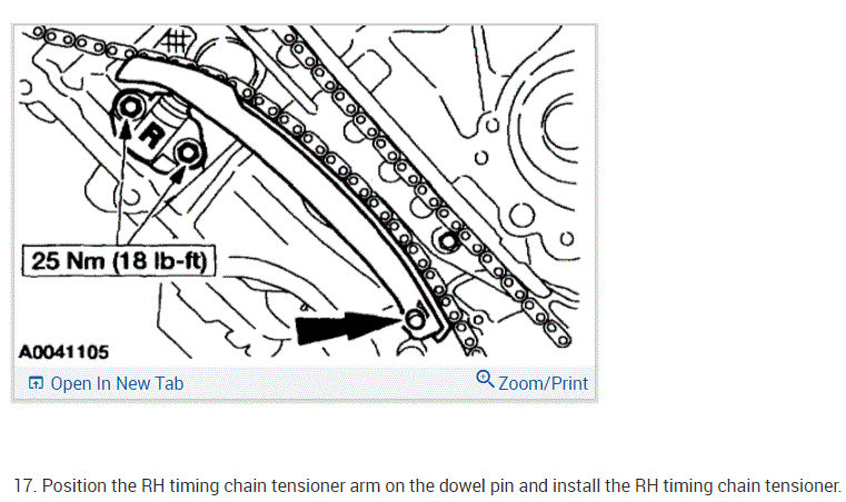

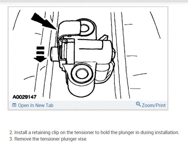

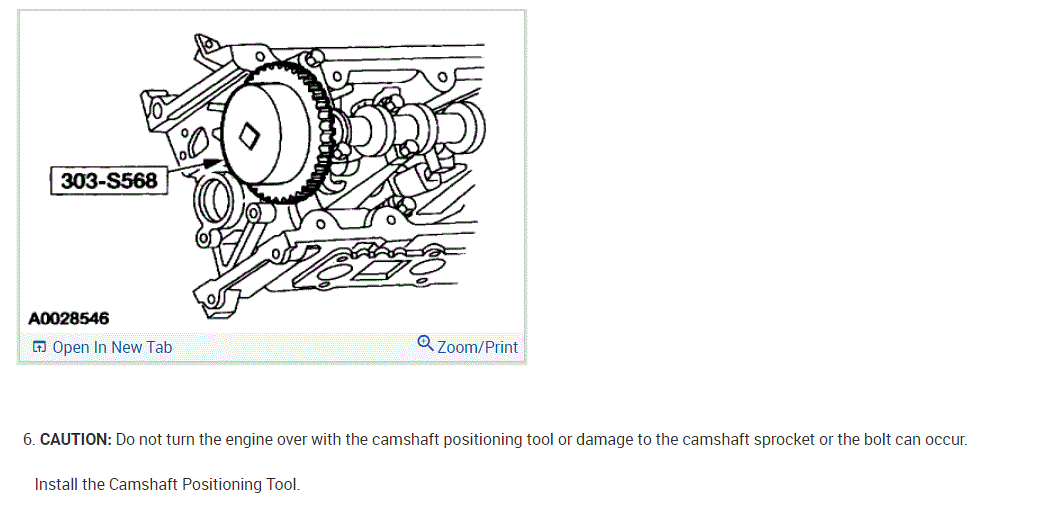

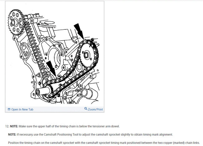

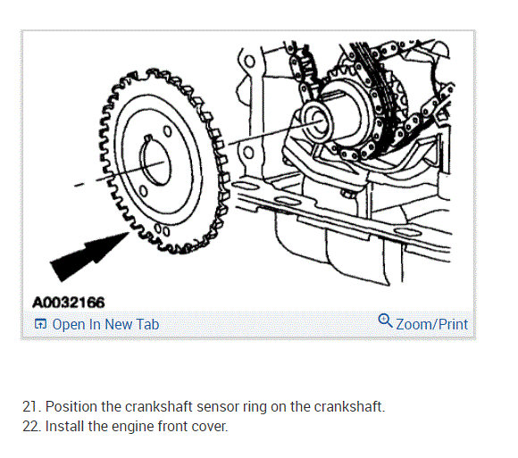

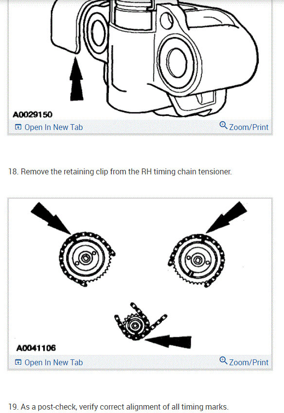

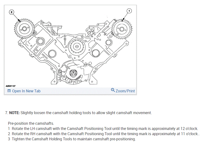

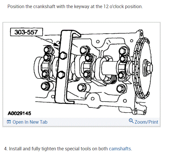

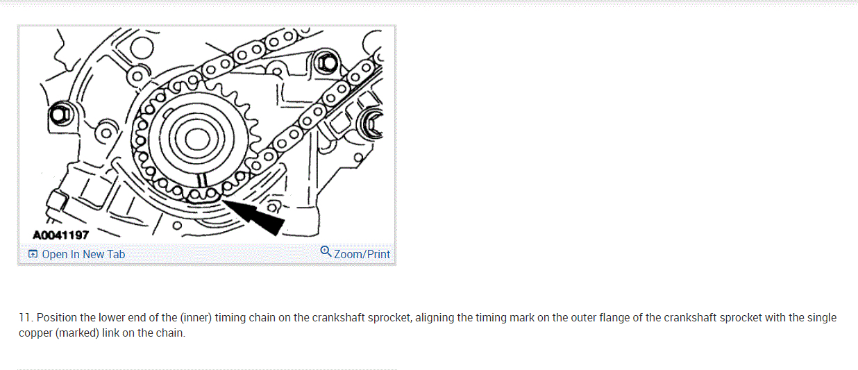

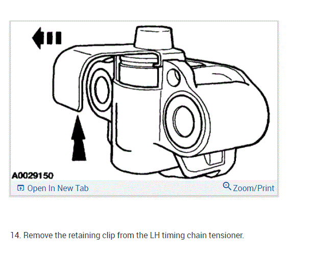

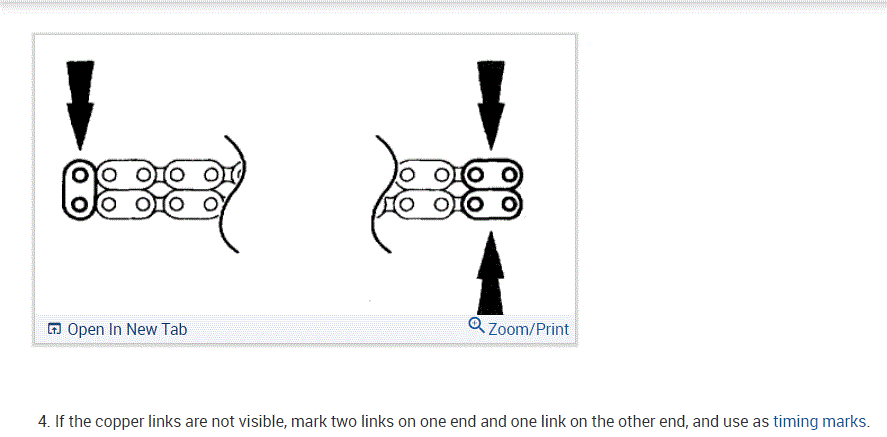

The cover needs to be removed. If you plan to do it, I attached the directions below in the pics. These directions are specific to your vehicle.
Monday, March 22nd, 2021 AT 8:55 PM

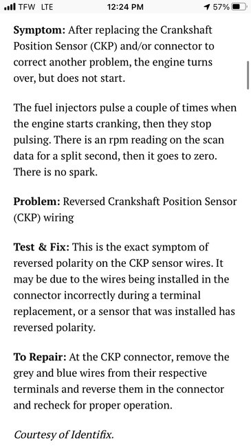

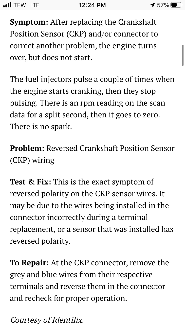

Guess I told a fib, I won’t be posting audio of engine cranking. I had read a post that didn’t seem likely but I figured I’d try it as it was quick and easy. Fired right up! Here is the post I found.
Tuesday, April 20th, 2021 AT 11:49 AM
  • 110,192 POSTS
That was a good find. I'm glad to hear it is fixed. Please feel free to come back in the future if you have questions.
Take care and thanks for the information. I'm sure it will help others.
