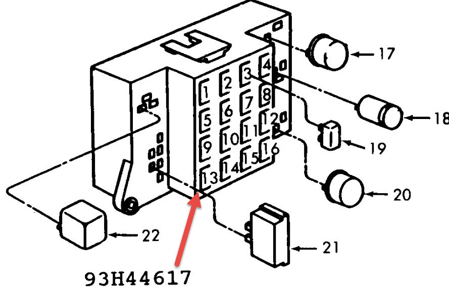

The pick up was just overhauld and a week after just shut down and never started again. Changed every sensor, pick up coil, checked every splice connections and continuity and everything is alright, fuel pump works fine. Replaced the pcm. But doesnt start. It just dont give signal to the sensors. Dont know what else to do.

Check your asd relay under hood first it may be corroded or making bad contact. Then check all fuses as you mayhave blown one going to ecm

Thanks for yout replay. Have done that already. Everything is fine. Tried bypass the asd and the fuel pump will start working but the car still wont start. It gets no spark. But the coil and everything is new. Dont know what else to do.

Check fuse D in pdc and fuse 13 in truck as they both power asd relay and may be killing power to the ecm. Other than that I can't think of anything else. If you get power from coil wire to dist then it may be a rotor/dist cap. Also check ohms of pick up coil in dist.

Can you tell me please where are they located? Cant fine fuse D and fuse 13z

I did tell you the fues d is in Pdc-power dist center under hood and 13 is inside the truck I have no pic of pdc so you'll have to physically look
Monday, March 28th, 2016 AT 3:08 PM
HMAC300
  • 48,601 POSTS
See pic
HALINVER
  • 6 POSTS
Checked the Fuse D and 13 but the are good, cheked every splice and wire continuity and everything is good. What els you recommend me to do?

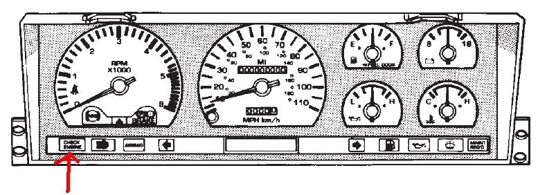

While checking the dash lights the left side of the dashboard does not work. Only the oil light turn on when I switch on the car and while cranking it turn off. The right signal light works too. But the left one does not, the check engine light, headlights light, handbrake does not work either. That means there is a wiring problem right?

More than likely or something has been changed from incorrect year
