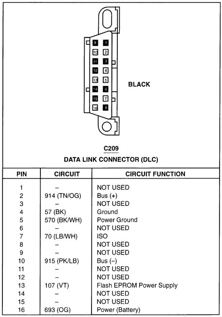

Hi, took my car to a smog check center and they couldn’t help me because there was no power.
Friday, February 1st, 2019 AT 1:03 PM
MECHANIC
110,192 POSTS
First, check to see if Pin 16 in the data link connector (DLC) has 12 volts. It should have it all the time. See picture 1 for pin allocation.
Let me know what you find.
