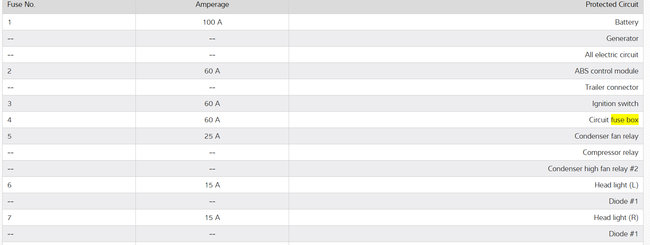

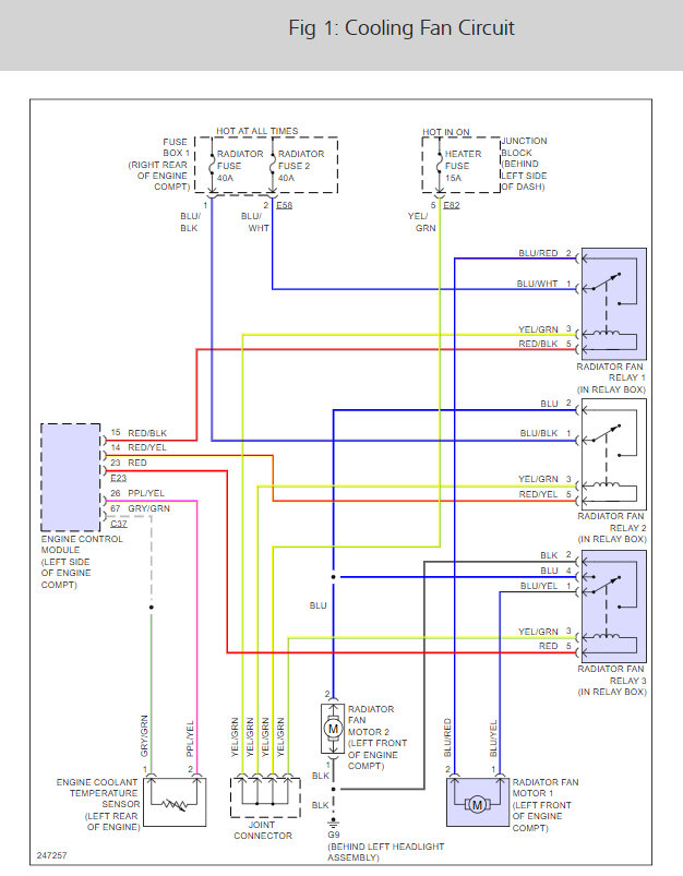

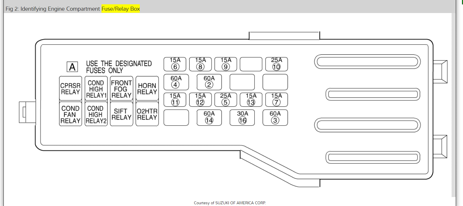

The fan does not run full speed even reaching operating temperature. It only turns on when A/C is on but not in full speed. But when unplugging one fan it does its thing as normal. And when unplugged to ect it kicks in at high speed.
Mar 6, 2019 at 5:44 AM
  • CAR REPAIR CONTRIBUTOR
  • 54,436 POSTS

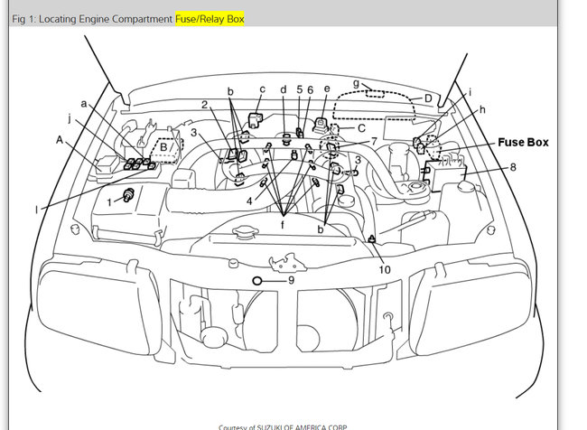

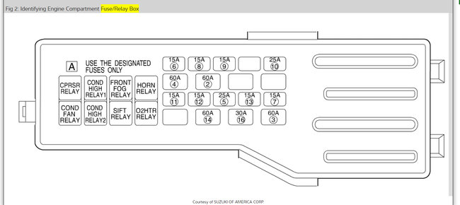

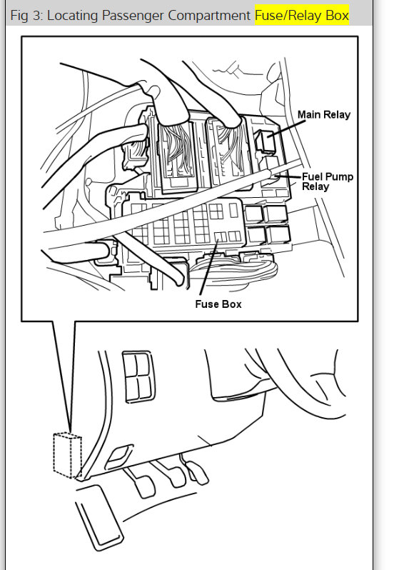

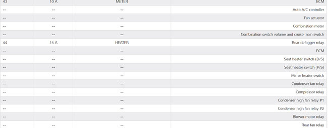

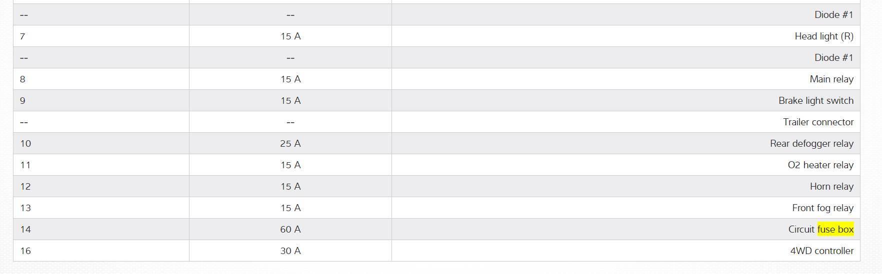

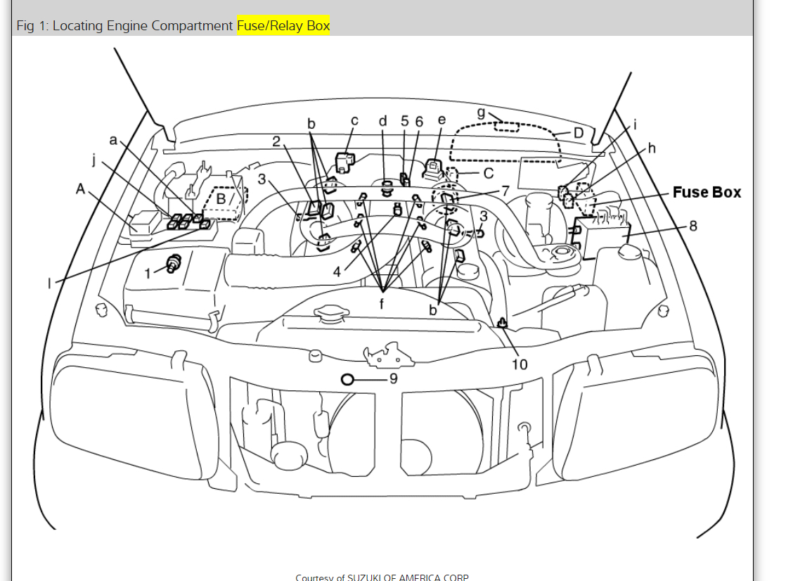

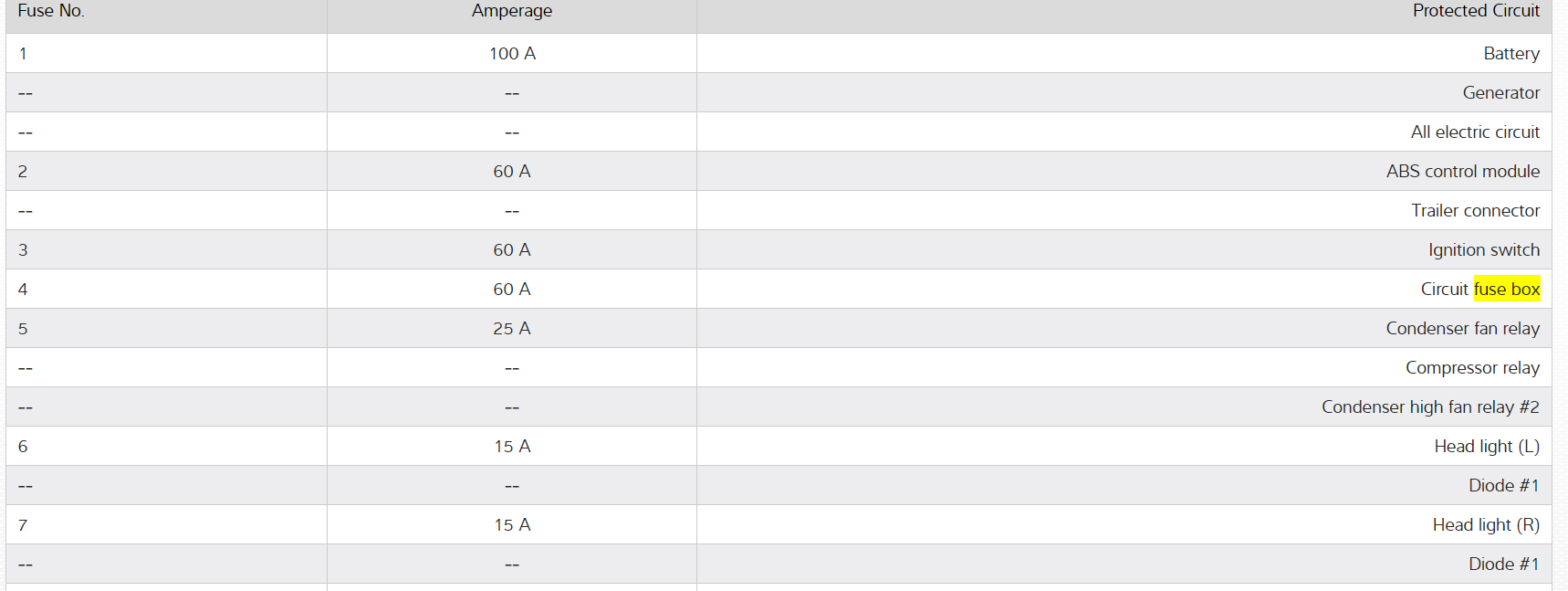

There are three relays that run the system let's start by checking them. here is a guide and the cooling fan wiring diagrams so you can see how the system works and the relay locations:
