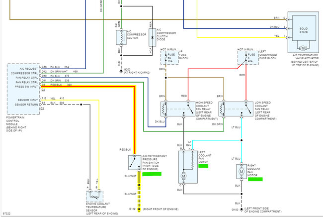

I was just wondering what the turn on temperature would be for the cooling fans. It has 195 thermostat and runs well, but I am concerned that the fans don't come on to cool until approximately 240 and shut back off at around 210 or so (according to the dash gauge). Is this the normal (seems a little high to me) range for the fans? Maybe I should use my temperature gun at the ect to check that the gauge is correct.

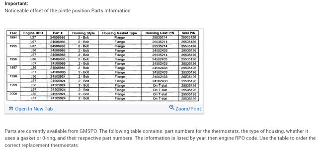

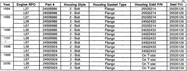

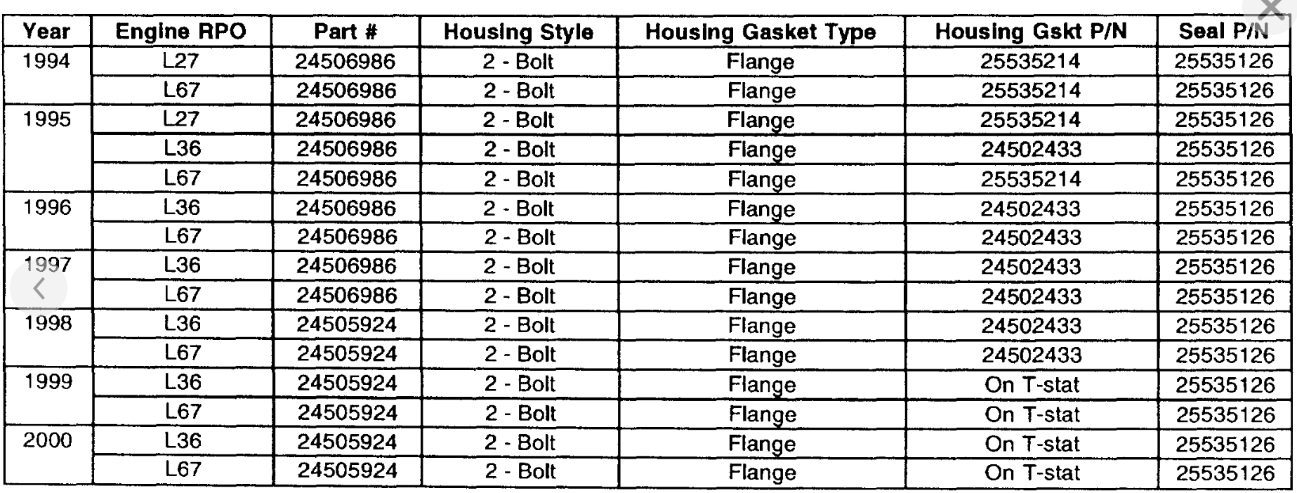

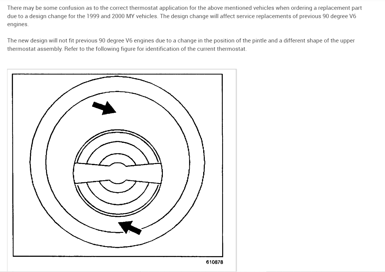

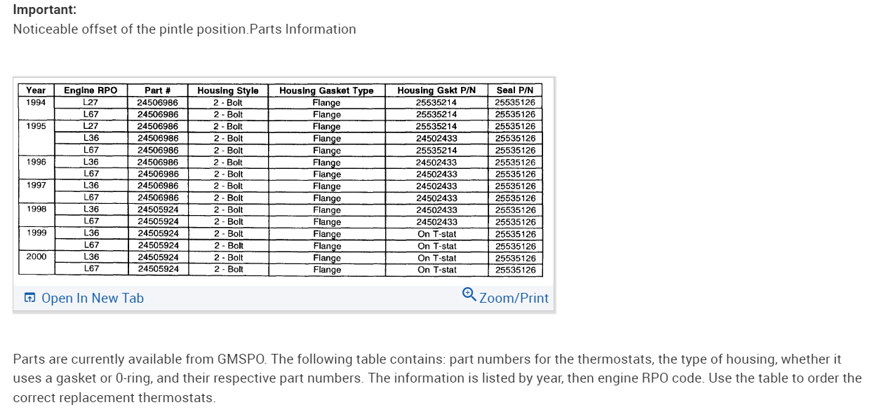

Service info states that if your vehicle hits a max of 261F you will get a Hot Stop Engine message, so you're getting pretty close there. And you don't want to burn up the head gaskets. If the thermostat is really getting to 240f I would think about having it changed. There is an updated thermostat so I'm going to post this information so if you change it, it doesn't get set in the incorrect position.
In the 1st diagram notice the offset of the pintle. Where there is more space on the top of the thermostat. There is most likely a small hole at the top allowing air to escape when the system is being refilled.
This was part of a Technical Service Bulletin.

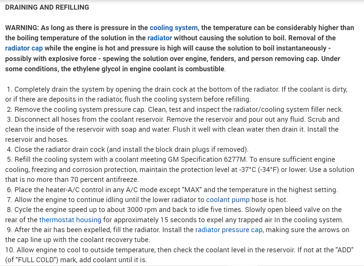

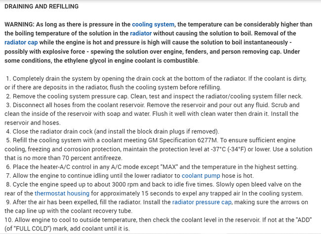

Yeah, I understand, take some temperature readings at different points on the radiator to make sure it has good flow through it. It sounds like the fans are working correctly. The radiator cap should also allow coolant into the overflow tank around 13 PSI, so maybe replace the cap, they are pretty cheap, Here is the coolant refill process just in case you need it.

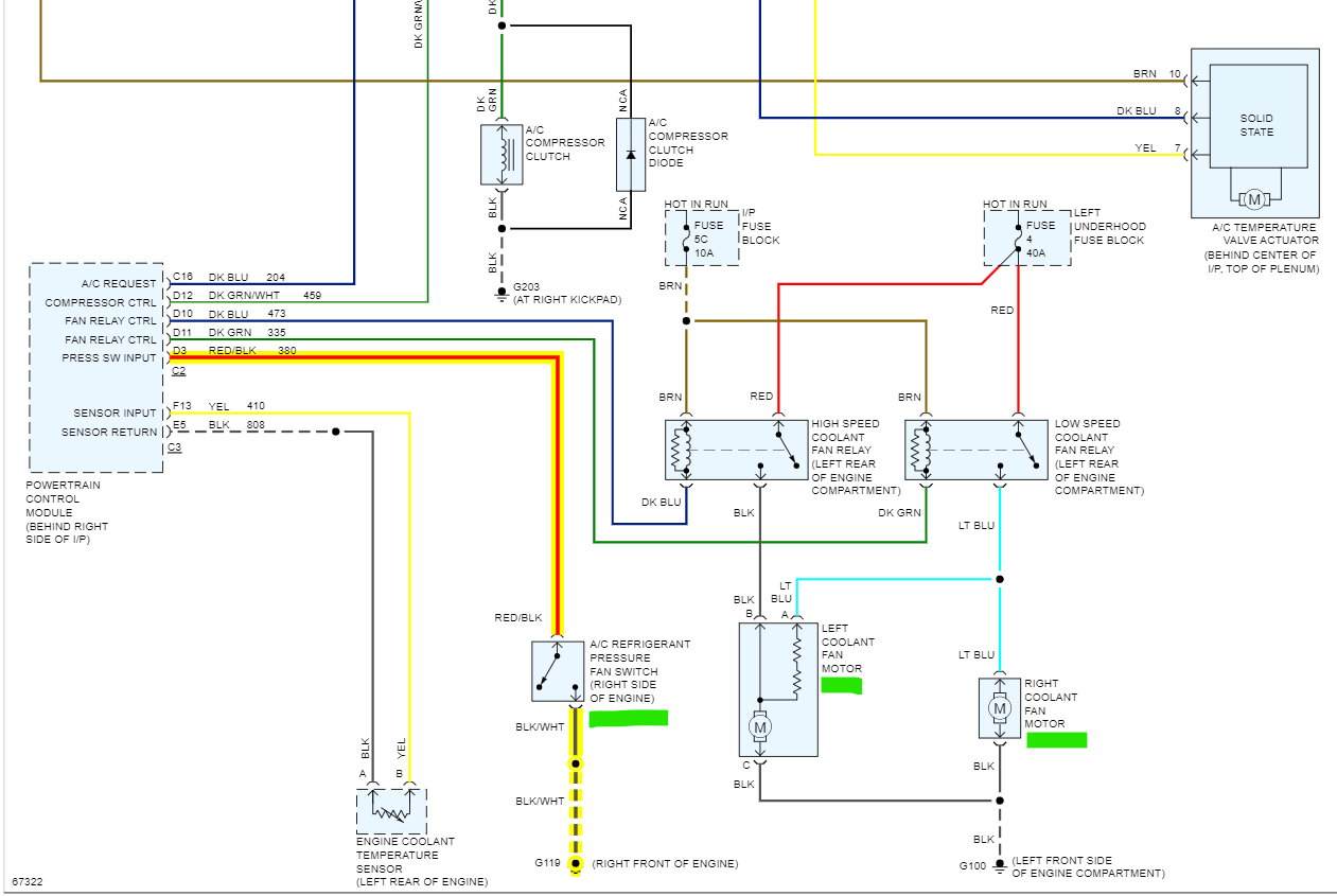

Another side note (a lot going on today), the fans do not come on when the A/C or defroster is on.
Wednesday, February 1st, 2023 AT 4:31 PM
AL514
  • 5,590 POSTS
But your A/C compressor does come on? And do you have Manual or Auto A/C? Can you set the passenger side to a different setting or is there just one setting for the entire vehicle?
Thursday, February 2nd, 2023 AT 10:36 AM
CHOUND52
  • 8 POSTS
Yes it comes on.
Thursday, February 2nd, 2023 AT 10:38 AM
AL514
  • 5,590 POSTS
Do you have different temperature settings for each side (auto A/C) or just one setting for the entire vehicle (manual A/C)? There's 2 different types of systems and the wiring diagrams are very different for manual or auto A/C,
Does the A/C compressor cycle on and off about every 8 seconds or does it just stay on all the time?
Thursday, February 2nd, 2023 AT 10:41 AM
AL514
  • 5,590 POSTS
Sorry you'll have to refresh the page every once and awhile, because I add information as we go, and it will show when you do a page refresh here.
Thursday, February 2nd, 2023 AT 10:46 AM
CHOUND52
  • 8 POSTS
Manual A/C.
Thursday, February 2nd, 2023 AT 10:59 AM
AL514
  • 5,590 POSTS

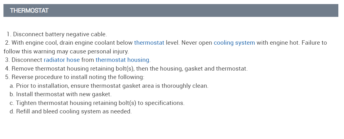

Okay, so if your A/C compressor is staying on all the time and not cycling every 8 seconds or so, then the system may be a little low on refrigerant, and in the 1st diagram you can see there is an A/C pressure switch for the fan. If the pressure isn't high enough it won't trip the switch, but that's not going to cause the over temperature issue. I think you have a thermostat that is either sticking or is not in correctly. That Technical service bulletin was about making sure the new thermostat goes in correctly and with the correct gasket. I don't think there should be any gasket sealer for this vehicle. The TSB gives part numbers, but service info doesn't not mention any type of sealer, just a gasket, I'm sure that is because if any of the sealant gets on the inside of the thermostat housing it can gum up the thermostat. Or air bleed hole if the thermostat has one. The 2nd diagram is for replacing the thermostat and there is no mention of sealant being added. I would replace the thermostat and follow the coolant drain and refill procedure. Check the old thermostat for any scratches on the side where it might have been sticking. And just make sure the new one goes in with the center pintle towards the bottom. Also do some temperature checks when you get it back together, just to be sure there's no hot spots in the cooling system.
