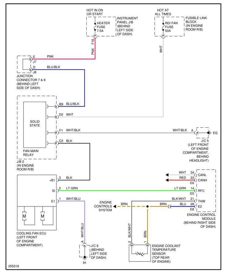

The ECM only utilizes 1 temperature sensor for the temperature gauge and fan operation.
The cooling fans have their own dedicated control module. The fan main relay supplies 12V on the black wire to pin 3, +B1, pin 1, E1, white/blue wire is the ground. Terminal SI, pin 2, light green wire is the control from the ECM.
As the cooling fan starts up with the coolant temperature sensor unplugged indicates that 12V supply and ground are present.
According to your description it sounds like a possible issue in the cooling fan ECU
See diagram below.
Cheers, Boris

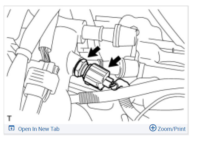

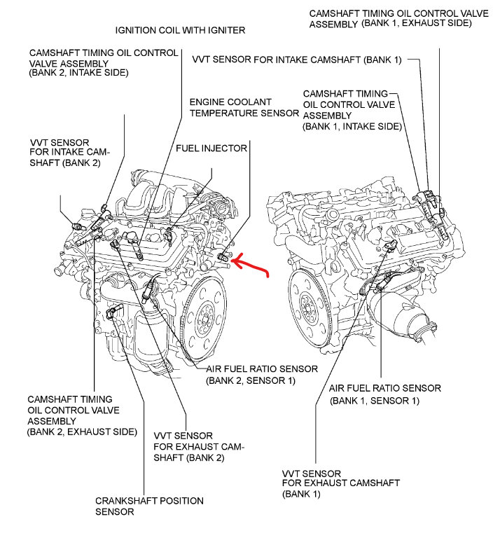

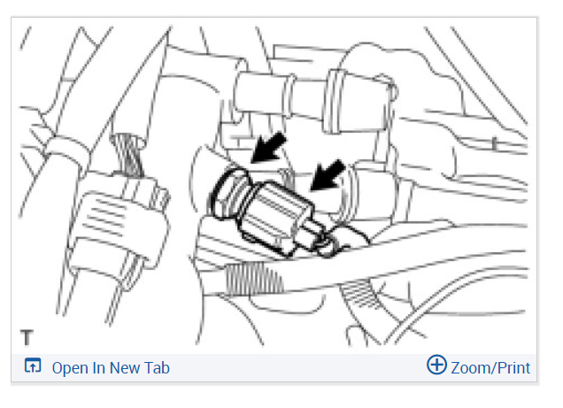

It looks like the engine coolant temperature sensor is on the thermostat housing. Check out the images (below). Please let us know what happens.
Monday, September 23rd, 2024 AT 10:26 AM
