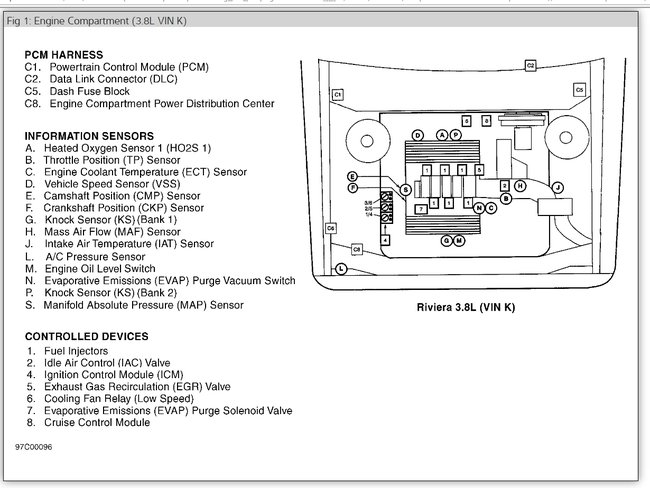

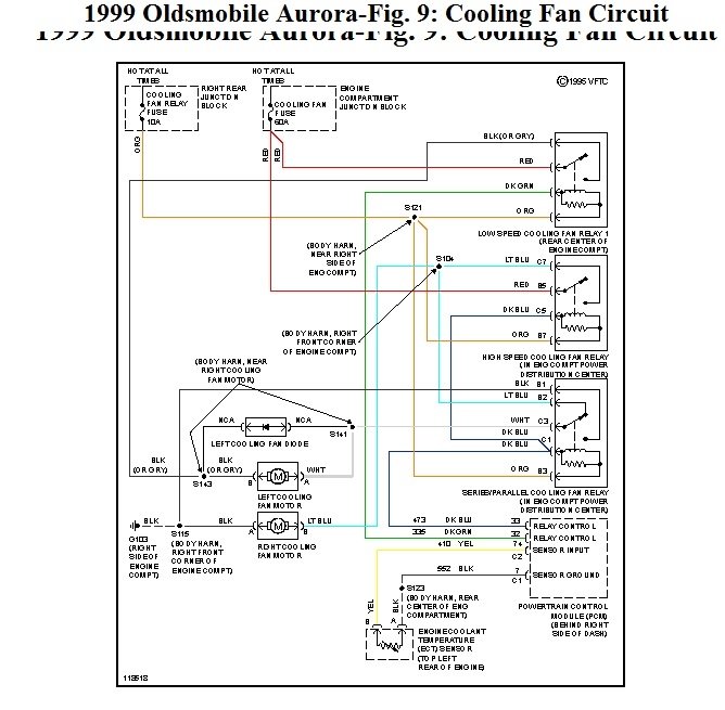

Hey Steetor,
I have gathered these guides for you to start checking things. This guide shows both the temperature sensor location and the fan relays. The BCM send the signal to the relays so if all else fails the BCM is bad but check the wiring diagrams first to be sure.
The fan relay locations are in the diagram. You might have to use an infrared non-contact thermometer to see if engine temp and gauge show about the same to make sure of the engine's temperature.

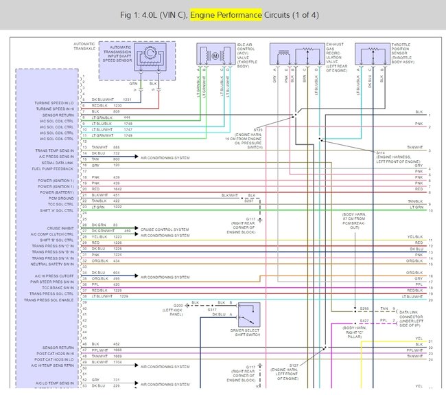

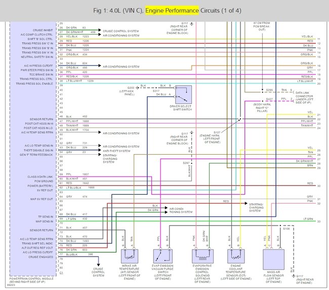

FANS ARE NOT OPERATING. MOTORS ARE GOOD. WHERE IS THE ENGINE COOLANT TEMP SENSOR? THANKS
Tuesday, October 30th, 2018 AT 4:35 PM (Merged)
BLUELIGHTNIN6
  • 16,542 POSTS
For the 3.5L and 4.0L engines it is located at the rear of the right cylinder head. 4.0L engine's ECT sensor is pictured below..

Radiator fan? If you turn on the ac will the fan run? If you unplug the coolant temp sensor will the fan run?
+2
JDL
  • 16,098 POSTS
Just to add, did you check applicable fuses? Hope you can read the diagram?
