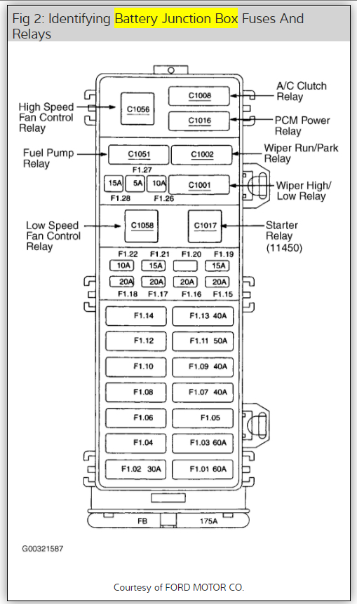

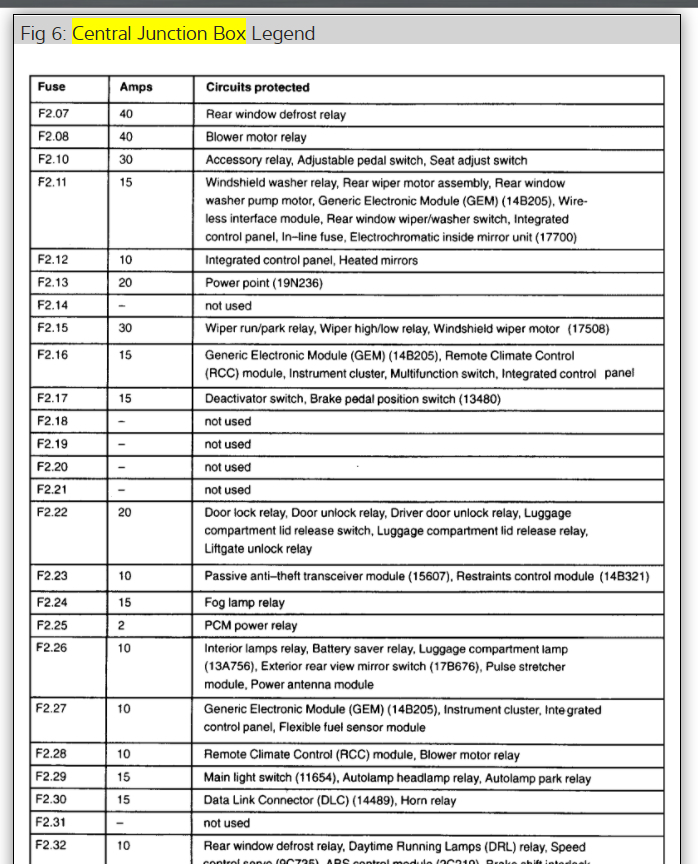

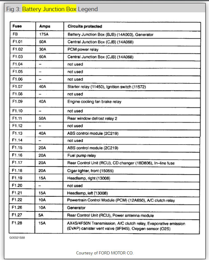

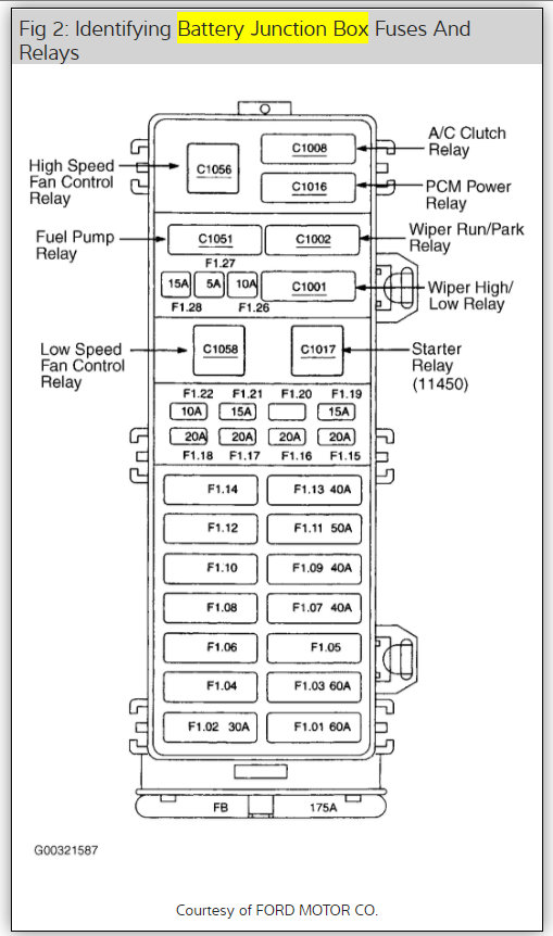

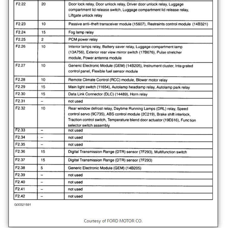

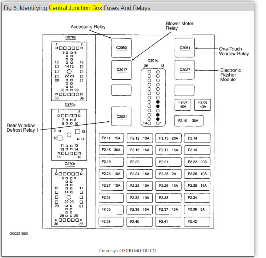

The location cooling fan relay
Saturday, January 16th, 2016 AT 3:26 PM
CJ MEDEVAC
MECHANIC
11,005 POSTS
There are two relays one high one low speed. Here is a guide to help you test the replay once you find it from the diagrams below.
