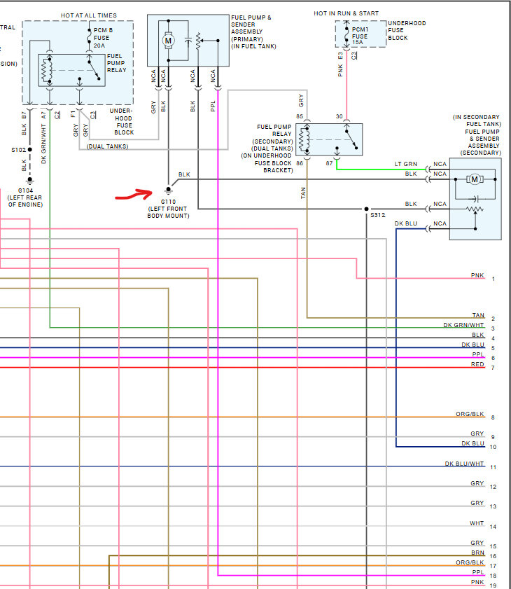

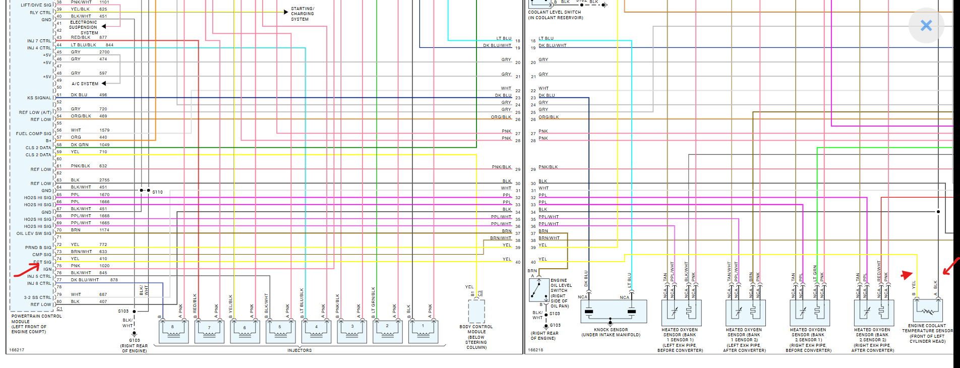

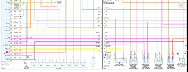

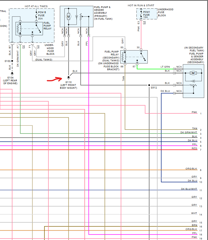

Yep, something must have got pulled on the wiring you are going to have to test the wiring from the sensor to the PCM. Here is a guide and the wiring diagrams so you can run the test. Also, check the engine harness grounds, if one of the grounds is off it will cause this problem.
Check out the images (below). Let us know how it goes
