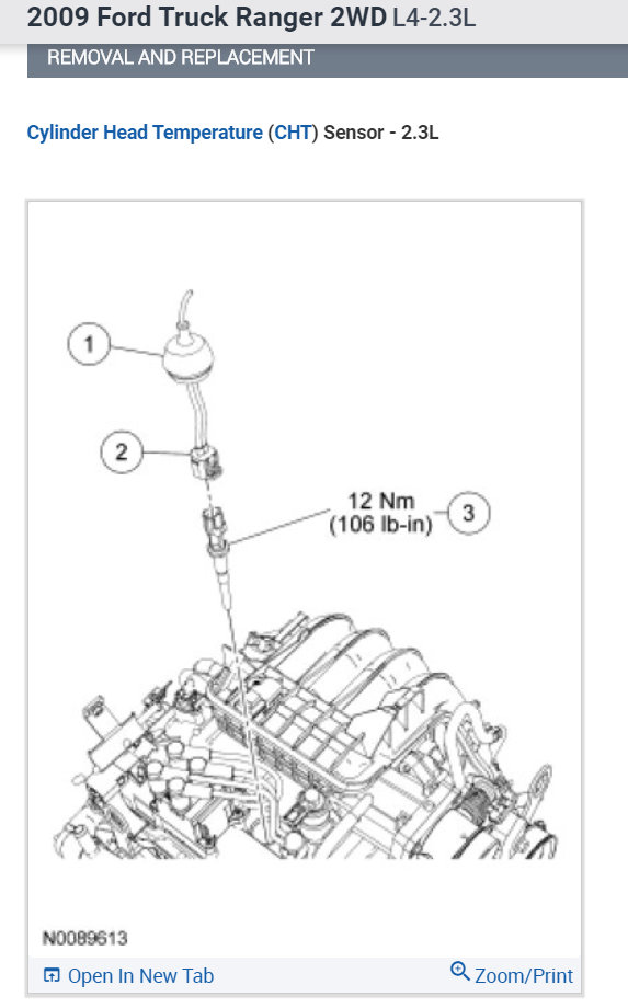

Where is the engine temperature sensor located I need to replace it?

Removal and Installation
1. Pull back the Cylinder Head Temperature (CHT) sensor cover and disconnect the electrical connector.
2. Remove the CHT sensor.
- To install, tighten to 12 Nm (106 lb-in).
3. To install, reverse the removal procedure. He temp sensor for the computer is located in the cylinder head.

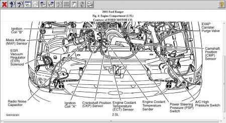

BOB WAGSTROM
Where is the temperature sender?

  • 75,992 POSTS
On a 2.3L its on top right front of engine-No pic available
2.5L
https://www.2carpros.com/forum/automotive_pictures/12900_temperature_sender_25L_1.jpg

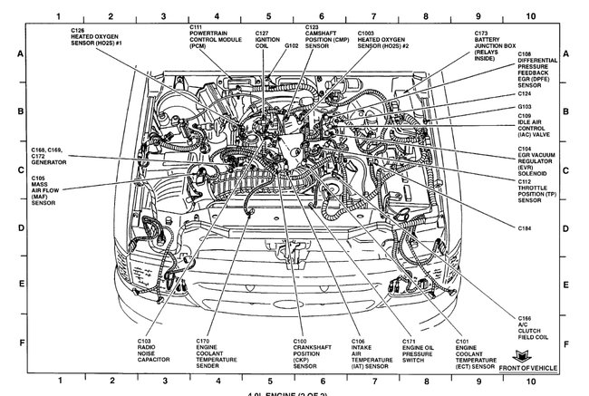

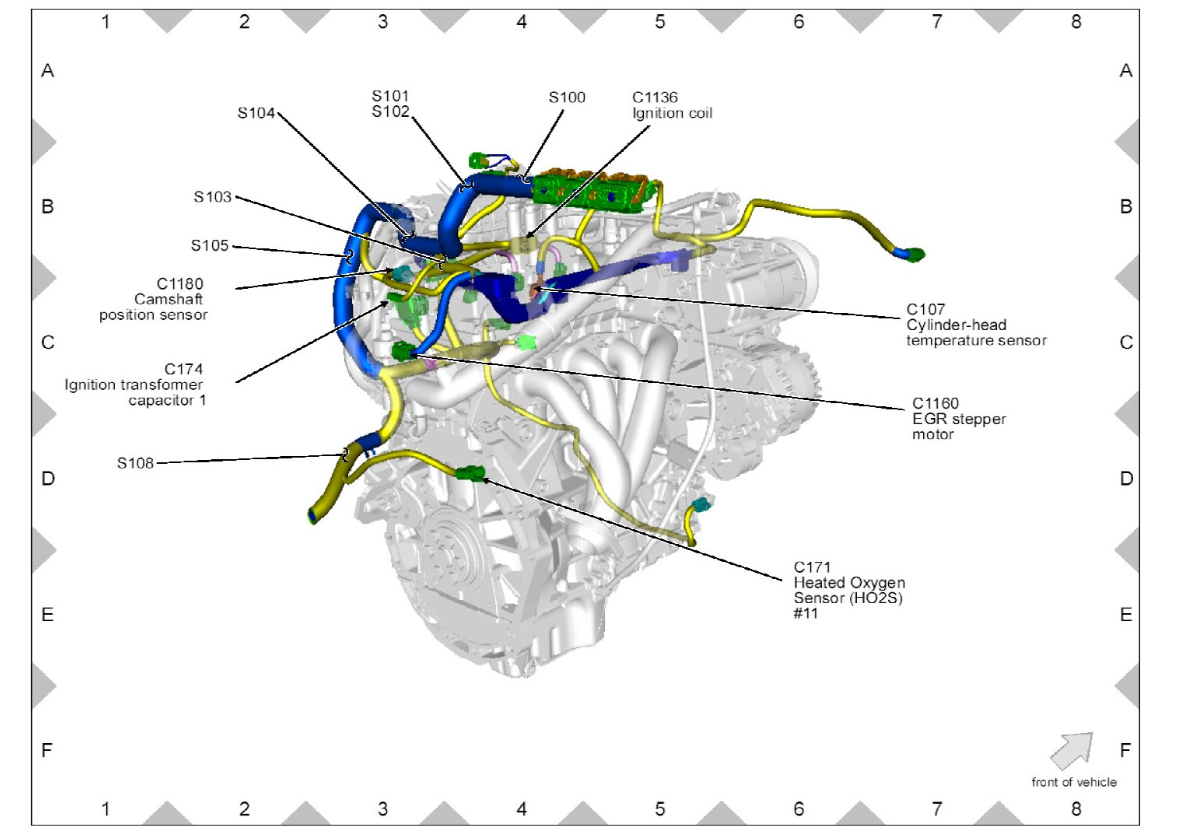

KITTYKAT43

Where is it located and how do you replace it?
Wednesday, October 28th, 2020 AT 1:58 PM (Merged)
  • 110,192 POSTS
The cylinder temperature head sensor is on top of the engine. Check out the diagrams (Below). Please let us know if you need anything else to get the problem fixed.

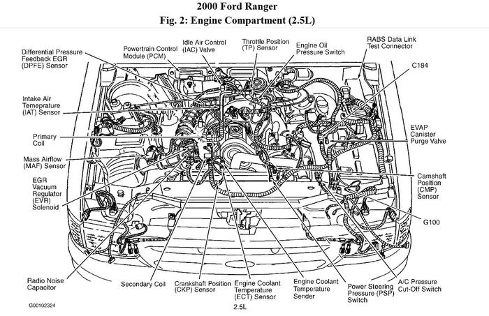

JOESTORRE
  • 2000 FORD RANGER
  • 109,544 MILES
Thermostat was stuck open, so replaced it and cleaned up sensors. Now forgot which is which, sensor with a cylinder tip - sender? Sensor with a pointed tip - sensor for pcm? Also need to know the bank location they sit on top of the plastic thermostat housing and which plug to connect, one has 4.5 volts and other has 10.5 volts to it. Could I have also damaged a sensor connecting the wrong plug to it?Thank you for your time and any help.

WRENCHTECH
  • 20,761 POSTS
The computer sensor will have a Gy/Rd and a Lg/Rd wires
Here is a guide to help
https://www.2carpros.com/articles/coolant-temperature-sensor-cts-replacement

KHLOW2008
  • 41,814 POSTS
The sending unit is usually the one that is smaller at the tip so most probably you got it in reverse. Ohmming them out should give you an idea, ECT very high resistance whereas the sending unit would have low resistance (ohms).
