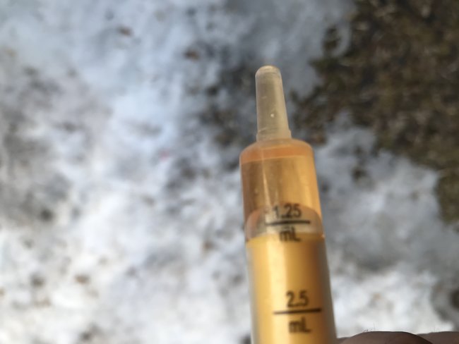

PLUXO
  • 71 POSTS
Roy,
Checked my coolant because you said not to mix them. This is what I sucked out of my radiator cap. Does green coolant turn yellowish over time?
Friday, March 13th, 2020 AT 5:01 PM
  • 52,797 POSTS
No it does not. I don't like the looks of that.
Friday, March 13th, 2020 AT 5:05 PM
