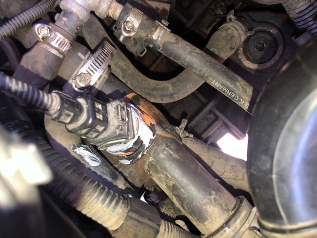

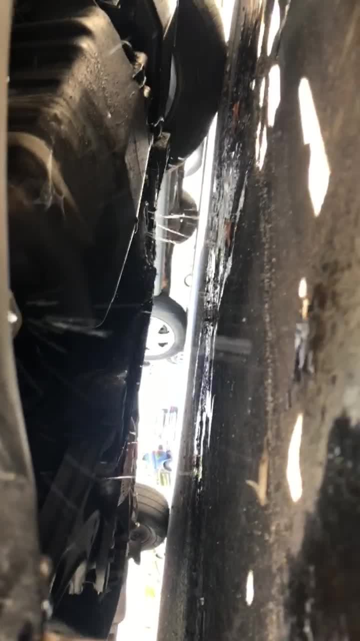

Coolant is gushing out underneath engine area on drivers side and near coolant reservoir area on passenger side.
I was in the process of replacing the coolant flange and coolant temperature sensor, when I noticed the “old” coolant temperature sensor had been sealed with a type of sealant and upon further inspection I noticed that the sensor was cracked and missing the gasket. So, I replaced it with a new sensor and the problem persisted. I filled the coolant reservoir to max level and the water gushed out from the bottom. Doesn’t last more than a couple minutes.

Hi, are you able to view the video I uploaded?
Thursday, June 27th, 2019 AT 5:50 PM
Unfortunately, it did not post to the site. Can you try again? Thanks
Thursday, June 27th, 2019 AT 6:04 PM
SONNYG22
  • 12 POSTS
Yes, hopefully it posts now.
Thursday, June 27th, 2019 AT 6:07 PM
SONNYG22
  • 12 POSTS
Here’s the longer version.
Thursday, June 27th, 2019 AT 6:09 PM
Okay. You weren't lying. That is coming out everywhere. Just to back up, did this start as you were replacing the temperature sensor or has this been an issue all along? Basically, I am just trying to understand the history if this just started or did the vehicle overheat and then this happened?

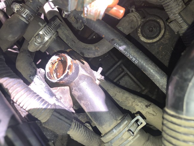

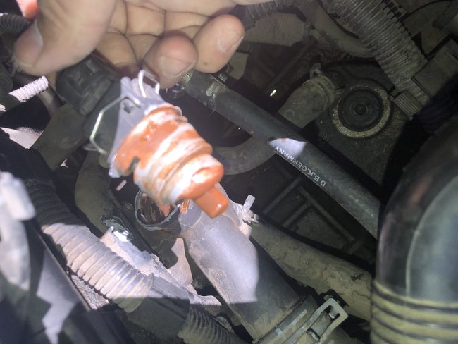

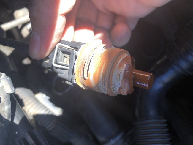

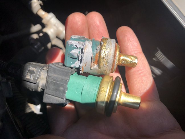

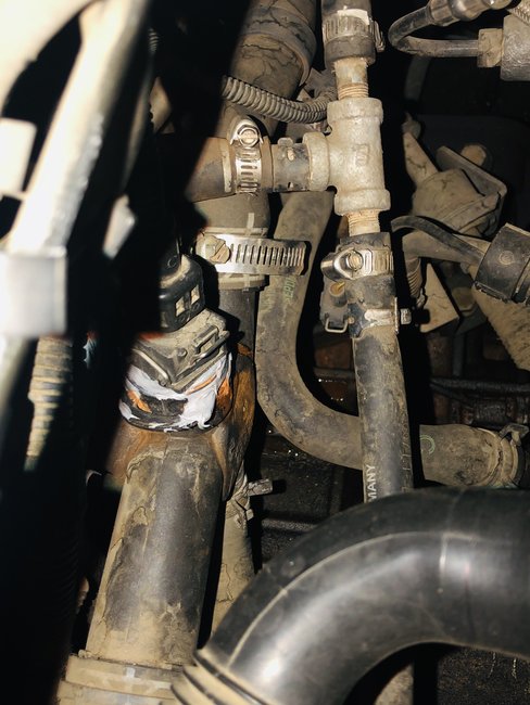

I’ve owned the car since brand new, but it’s been passed down to my nephew and it hasn’t been maintained. It started leaking coolant about a month ago and he would top it off with water. It started to get worse, so a friend of his decided to “seal” the broken/faulty coolant sensor instead of replacing it. He said it was doing better, but he would top it off with water. Then a few days ago he noticed the coolant low gauge come on while driving, but it register as overheating. That’s when he noticed it was dumping the water out. He said it never got “hot”. There’s no milky oil that I can see. So I bought a flange and coolant sensor in an attempt to hopefully fix the issue. I saw what his friend did to the old sensor and I just replaced it and not the flange. I wanted to ask for some help before I try and replace the flange just in case it’s a water pump or something more serious. I should also maybe double check the hoses to the flange. I noticed what seemed to be a universal clamp on one hose. Thanks for your time.

Here’s a couple pictures of what it looked like.
Thursday, June 27th, 2019 AT 6:28 PM
SONNYG22
  • 12 POSTS
Here.
Thursday, June 27th, 2019 AT 6:30 PM
SONNYG22
  • 12 POSTS
Couple more.
Thursday, June 27th, 2019 AT 6:31 PM
SONNYG22
  • 12 POSTS
Here.
Thursday, June 27th, 2019 AT 6:32 PM
Okay. That connects some of the dots. I suspect what is happening is the water pump pushed out the front seal and it is spinning and throwing the coolant all over.
I would suggest letting it cool down and then top off the coolant with water again and then put a pressure gauge/pump on the system and pump it up to about 15 PSI. Then start looking for where the leak is coming from. This will pressurize the system just like the pump does but the engine is not running so you will be able to look around easier. You should see just a small stream of water coming out from where it is leaking rather than seeing coolant pouring from all over.
Again, I suspect the pump but you are correct, there could be other areas. So unfortunately this is just going to take a little time but using the pump and water with the engine off, you are not in danger of overheating, dealing with a hot engine, or have coolant going everywhere. It will be more controlled.
Let me know where you see it coming from and I can get you repair procedures for those components if needed.
