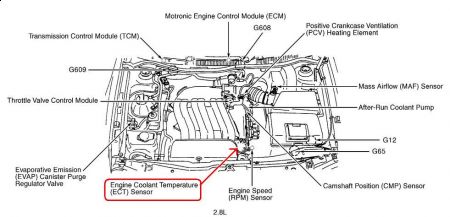

Can you please tell me where the coolant temperature sensor is located? The exact location or with picture is much better.

Location depends on engine size. For the 1.9L and 2.0L engines, it is on the cylinder head, in coolant flange. For the 2.8L, it is on the left rear of the head, on the coolant flange. Provide size of engine and I can give you picture.

The engine size is 2.8L

https://www.2carpros.com/forum/automotive_pictures/261618_Noname_1480.jpg
