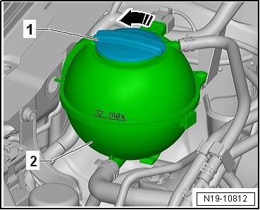

Risk of scalding due to hot steam and hot coolant.
The coolant system is under pressure when the engine is warm.
Cover the coolant reservoir cap with a cloth and then open it slowly to release the pressure.

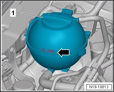

- Carefully open the fuel cap - 1 - on the coolant reservoir - 2 - in direction of - arrow -.
pic 1

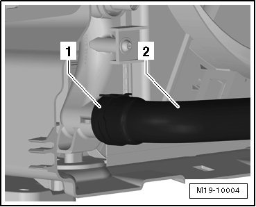

- Remove the noise insulation.
- Place the Shop Crane - Drip Tray (VAS6208) underneath.
- Open the spring clamp - 1 - and remove the coolant hose - 2 -.
pic 2
Drained coolant must be stored in a clean container for disposal or reuse.

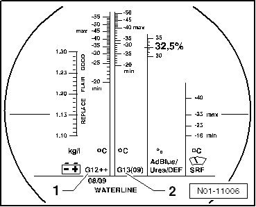

The Refractometer (T10007A) MUST be used to determine the freeze protection density.
pic 3
Read the freeze protection value on the scale for the coolant additive that has been added.
Do not reuse used coolant.

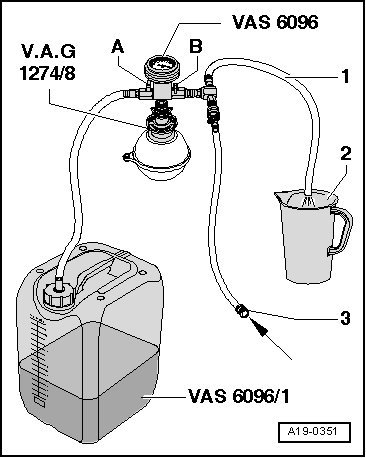

- Fill the Cooling System Charge Kit - Reservoir (VAS6096/1) on the Cooling System Charge Kit (VAS6096) with at least 10 liters (10.56 quarts) of coolant.
pic 6
- Use the proper mixture ratio of coolant.
- Install the Cooling System Tester - Adapter (VAG1274/8) on the coolant expansion tank.
- Mount the Cooling System Charge Kit (VAS6096) on the Cooling System Tester - Adapter (VAG1274/8).
- Place the drain hose - 1 - in a small container - 2 -.
A small amount of coolant which should be collected is drawn off with the discharged air.

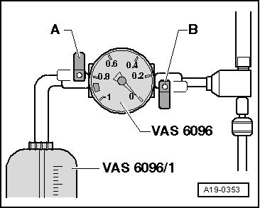

- Close valves - A and B - by turning lever at a right angle to the flow direction.
- Connect the hose - 3 - to compressed air.
Pressure: 6 to 10 bar (87 to 145 psi) positive pressure.
- Open the valve - B - by turning the lever in the flow direction.
pic 7
A further vacuum is created in the cooling system by the suction jet pump.
The needle on the instrument display must travel into the green region.
- Open the valve - A - slightly for a moment.
- To do this, turn the lever in the flow direction so that the Cooling System Charge Kit - Reservoir (VAS6096/1) hose fills with coolant.
- Close the valve - A - again.
- Leave the valve - B - open another two minutes.
Needle on the instrument display must still remain in the green region.
- Close the valve - B -.
The needle on display must remain in the green range.
Only then is there enough vacuum in the coolant system for the filling.
Repeat the procedure if the needle goes below the green range.
Check the cooling system for leak if the pressure drops.
- Remove the pressure hose.
- Open the valve - A -.
The vacuum in the cooling system causes coolant to be extracted from the Cooling System Charge Kit - Reservoir (VAS6096/1) and to fill the cooling system.

- Fill up the coolant reservoir - 1 - with coolant to the "max" marking - arrow -.

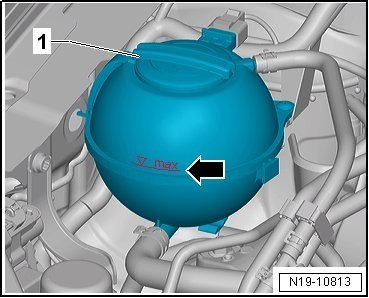

- Check the coolant level in the coolant reservoir - 1 -.
pic 9
The coolant level must be between the "min" and "max" markings when the engine is cold.
The coolant level may be at the "max" marking - arrow - when the engine is warm.

Is all this tool stuff necessary? can’t you just drain out with plug and hoses if have to then flush with water then top off with coolant?
Aug 13, 2019 at 8:20 PM
CORY2427
  • 293 POSTS
It self bleeds through puke tank.
  • 110,193 POSTS
Welcome back:
You can do it that way, but to flush the block, you need to remove the thermostat. As far as bleeding, it can be a pain.
Aug 13, 2019 at 10:26 PM
CORY2427
  • 293 POSTS
Thought you didn’t really have to bleed them if they had puke tank?
Aug 14, 2019 at 12:07 AM
CORY2427
  • 293 POSTS
What be easy way to bleed with out tool?
Aug 14, 2019 at 9:19 AM
  • 110,193 POSTS
Welcome back:
Without the tool, the best way is as mentioned in the aforementioned link. Just pour as much in as possible until full. Do it slowly so it can make it's way through the system. When you do this, make sure the heater is on high when you first started. That way the heater core will fill too. Then return to the directions in the link.
