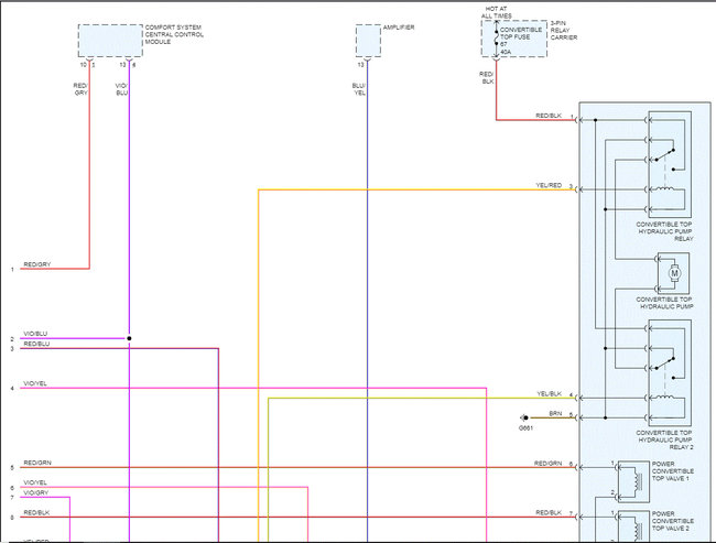

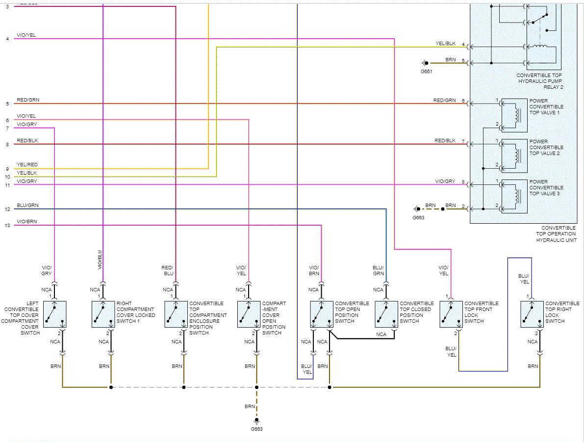

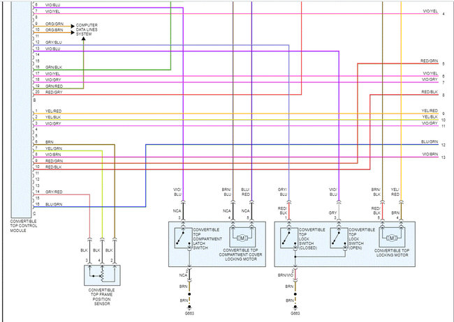

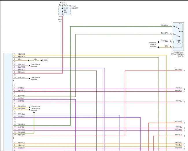

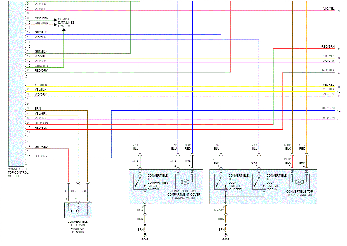

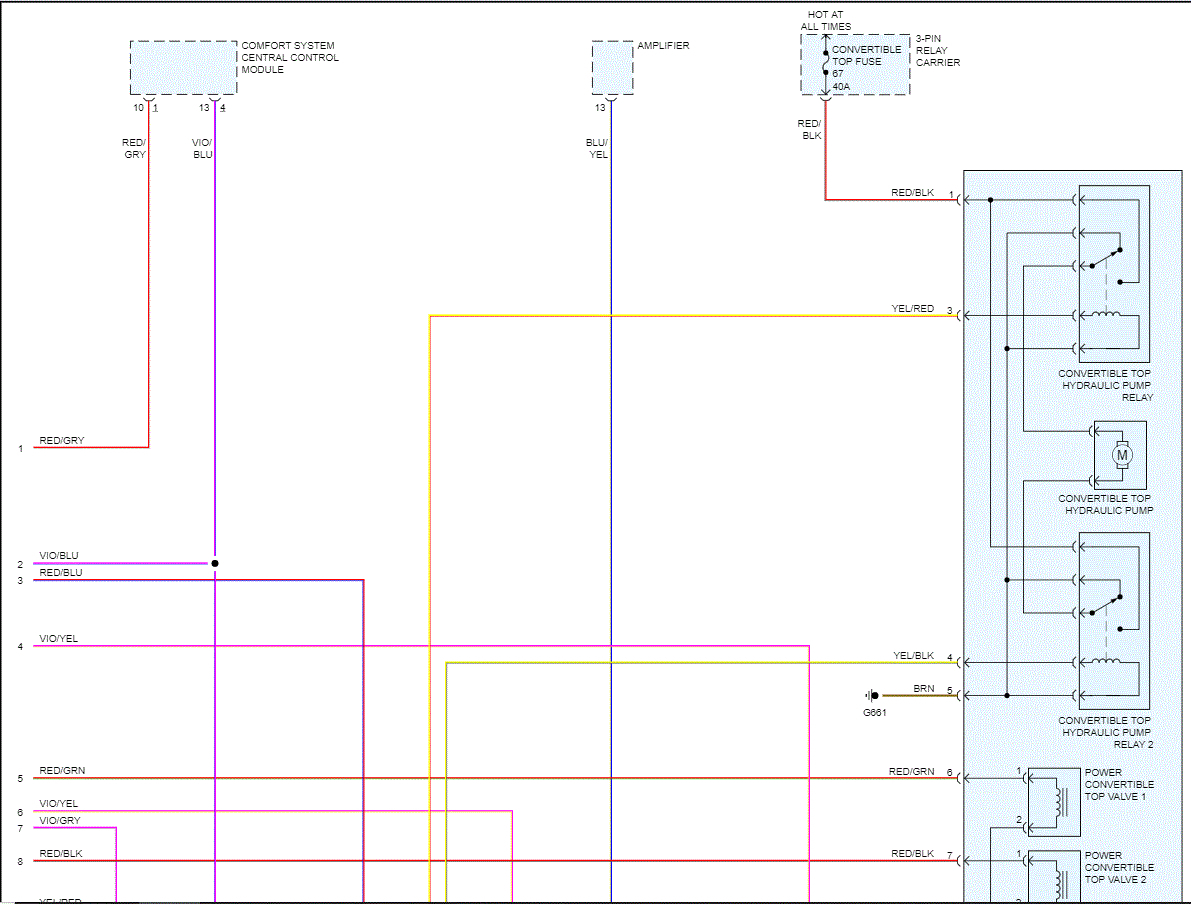

I attached the entire wiring schematic for the system. I had to break it down to make it readable, but I overlapped it so you can follow it.
Let me know if it helps.
Friday, September 18th, 2020 AT 8:44 PM
NASER NASER
  • 836 POSTS
Thanks. Based on what am looking at and where it is even if the relay is bad there should be window triggering at least or some unlatching by windshield. So doubt the relay is the issue here. I thought it would be in line with the module. So I think the module is bad as well. What do you think?
Friday, September 18th, 2020 AT 8:59 PM
  • 110,194 POSTS
Sorry to say, I think that's it and be wrong. However, that is where I am thinking the problem stems from. As far as the relay, like you, I believe you would hear something trigger. If I had to guess, I believe the module is the problem. Please understand not being there puts me at a disadvantage, but if there is power to it and nothing out, that seems like the likely issue.

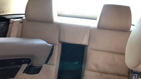

Here is the video, once that happens I cannot use the switch to close it until I lock the back lid with the tool. Once I do I go to the front and use the switch to lock the top and it does lock.
Tuesday, September 22nd, 2020 AT 8:56 AM
  • 110,194 POSTS
LOL That isn't good. It looks like the cylinder may be bad. The idea that it just falls and doesn't latch indicates it isn't going through a faulty process (it would lock).

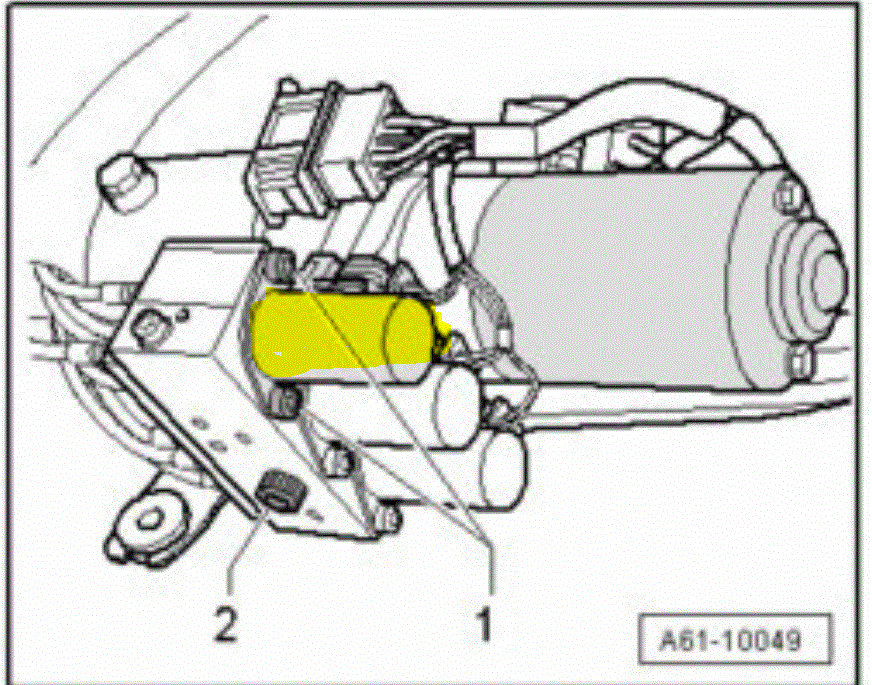

Anything is possible but yes the right rear. Something seems to lose pressure. THe only other thing I can think of is the solenoid valve.

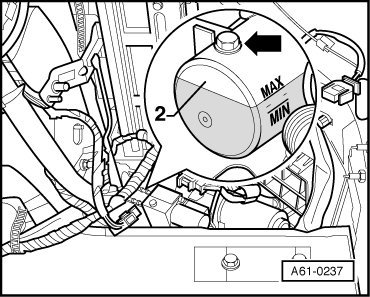

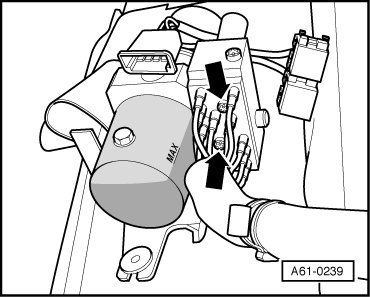

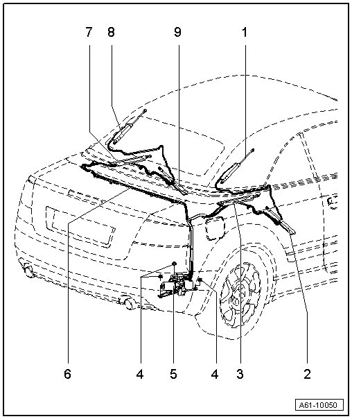

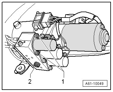

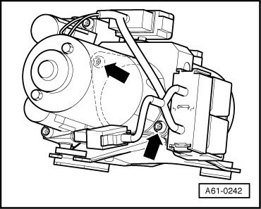

Here is an overview of the system. Take a look through it.
_____________________________________________
2006 Audi A4 Cabriolet (8H7) L4-1.8L Turbo (AMB)
Convertible Top Hydraulic System Assembly Overview
Vehicle Body and Frame Roof and Associated Components Convertible Top Service and Repair Removal and Replacement Convertible Top Hydraulic System Assembly Overview
CONVERTIBLE TOP HYDRAULIC SYSTEM ASSEMBLY OVERVIEW
pic 1
1 Right bracket drive motor cylinder
Removing => [ Convertible Top Hydraulic Cylinder ] See: Convertible Top Hydraulic Cylinder > Removal and Replacement > Convertible Top Hydraulic Cylinder.
2 Right main drive motor cylinder
3 Right convertible top compartment cover drive motor cylinder
4 Nut
3x
10 Nm
5 Hydraulic pump with valve block
Removing => [ Convertible Top Hydraulic Unit and Pump ] See: Convertible Top Hydraulic Control Unit > Removal and Replacement > Convertible Top Hydraulic Unit and Pump.
6 Hydraulic lines
7 Left convertible top compartment cover drive motor cylinder
8 Left bracket drive motor cylinder
9 Left main drive motor cylinder
Oil filler screw
pic 2
Pfeil 2 Nm
Hydraulic pump housing
pic 3
Arrow 6 Nm
Solenoid valves
pic 4
1. 6 Nm
2. 22 Nm
Connecting plate
pic 5
Arrow 10 Nm
______________________________-
Tuesday, September 22nd, 2020 AT 7:01 PM

Yes, I already have that exposed, and the area looks very clean nd fluid is full. But don't you think if one was weak the top wouldn't even flip nd back window won't go up in preparing for the lid to open? Let me ask it another way, do you think what control the top to open and window to fold is the same part that controls the lid opening and closing?
