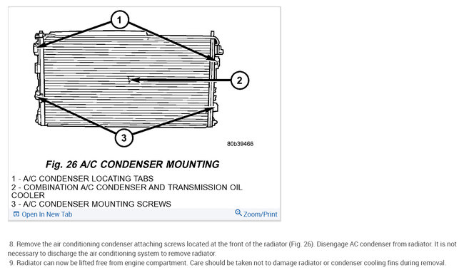

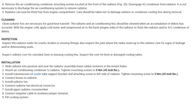

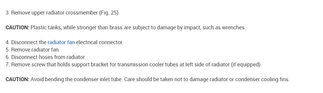

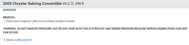

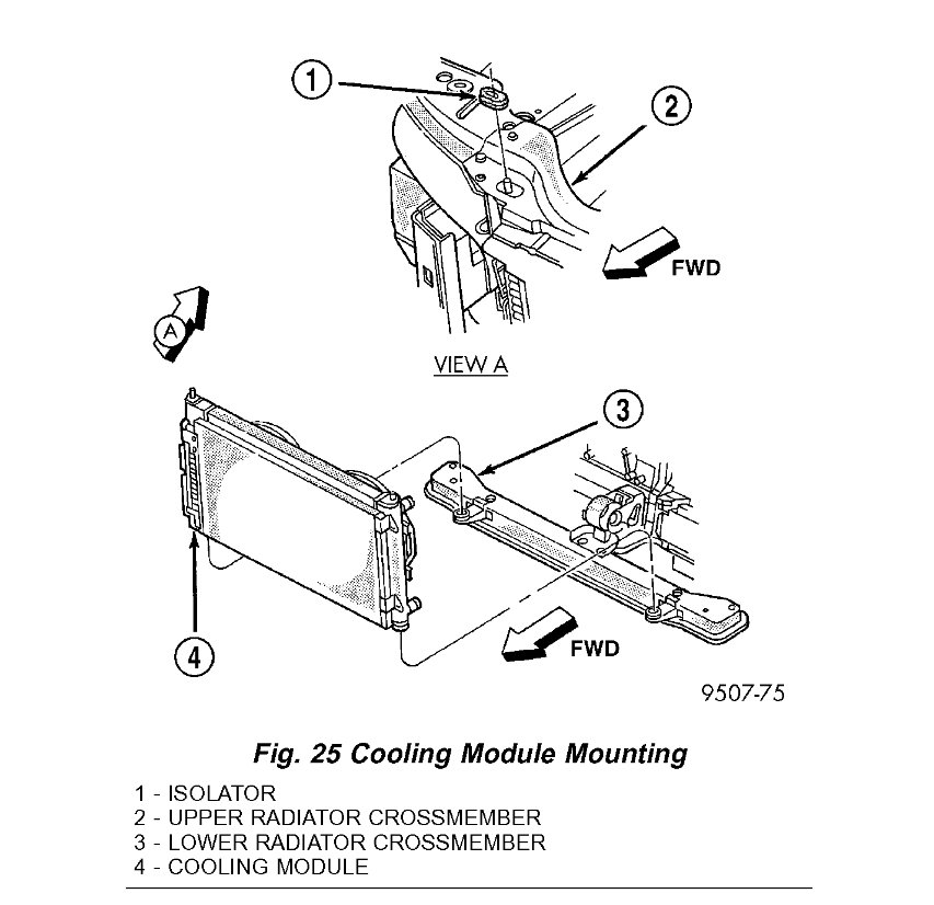

The clue was the heater doesn't work, so what happened was the stop leak clogged up the heater core and radiator because of the small tubes which are common with stop leak. When the car is hot can you hear the radiator cooling fans on? If so, I would replace the radiator and flush the cooling system again.
Here is a generic guide to show you what you are in for doing the job and how to replace the radiator in the images below:
